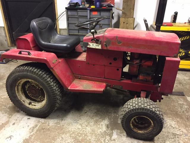

slf-uk 914 #1 Posted August 28, 2014 I have this week off work with lots of outside jobs to do. This morning it was raining and as I was not feeling great I decided not to get wet. Instead I went into the workshop looking for a small job to do and I decided to look at the D-160. I rebuilt most of the mechanics about two years ago and then dumped it in the corner, so I decided to re-commission it. By the time I had it running the sun was out so I took it for a run. The exhaust stack from a full size tractor (can't remember which one) makes it sounds great with no fumes for taking the boy for rides. After taking it for a run it went back in the workshop and I got a Bolens out to do some real work The real reason was the D-160 does not currently have a hitch fitted and I can't remember where I put it. Iain 1 Triumph66 reacted to this Share this post Link to post Share on other sites

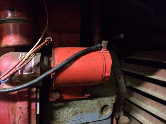

slf-uk 914 #12 Posted September 1, 2014 I don't suppose anyone has a starter motor they want to sell? The magnets have broken up on the D-160 starter. I have glues the bits back together and it works most of the time, however a replacement would be great. Iain Share this post Link to post Share on other sites
Chris 642 #13 Posted September 1, 2014 No chance of buying it back then Chris ?? Err no I dont think so. It will be done, but when?? Share this post Link to post Share on other sites
pmackellow 2,728 #14 Posted September 1, 2014 Err no I dont think so. It will be done, but when?? Not thought about asking him then?? Share this post Link to post Share on other sites
Ian 2,417 #15 Posted September 2, 2014 I don't suppose anyone has a starter motor they want to sell? The magnets have broken up on the D-160 starter. I have glues the bits back together and it works most of the time, however a replacement would be great. Iain Hi Iain, if the 16hp K series starter is the same as other smaller K series starters then I think I may have a spare starter.. I will have a look when I'm feeling well enough to head out to the shack. Share this post Link to post Share on other sites
slf-uk 914 #16 Posted September 2, 2014 Ian, I believe it is the same and the key bit is getting a starter with the side facing fixing bracket. Thanks Iain Share this post Link to post Share on other sites
Ian 2,417 #17 Posted September 3, 2014 How's this Iain. It came from my first Wh a 74 Raider 10.. I did the jump lead test today and it spins up fine. Share this post Link to post Share on other sites
slf-uk 914 #18 Posted September 4, 2014 Ian, This looks almost perfect. I can't remember mine having a slight overhang with the bracket on the drive end. I will check tonight and get back to you. Thanks Iain Share this post Link to post Share on other sites
slf-uk 914 #19 Posted September 22, 2014 With a big thanks to Ian the D-160 now is fitted with this It works great and now I just need someone to paint the rest of the tractor to match. I quickly fitted a tow hitch to it over the weekend and was using it to pull a trailer around. I have no idea if it was fun to drive because my 7 year old lad decided he would do all the driving. It is a very easy machine for him to drive because he can get by without using the peddle. Iain Share this post Link to post Share on other sites

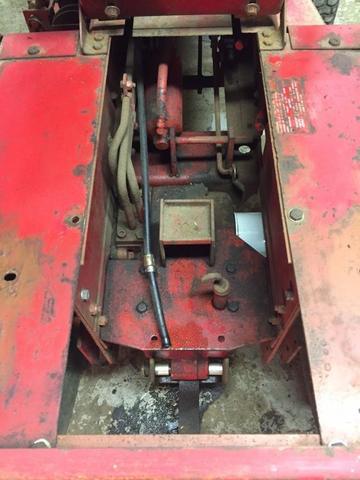

slf-uk 914 #22 Posted December 30, 2016 Today I decided to do some work on the D160. It has been in storage for nearly two years and if I remember correctly the last time it was used was when Tom used it and I believe it kept cutting out. My D160 came out of the factory as poverty specification and it was supplied without a tow hitch or lights and did not have 3pt, PTO shaft or wheel brakes. With the help of friends in the US plus some parts from Harry (via Chris) I have collected a few bits to put on it. It now has lights and a tow hitch and I have most of the parts to put a 3pt on it. Before I started I kicked a few things out of the workshop to give me plenty of space, they are a big machine. I then pulled the complete fuel system off and cleaned out the horrible smelling fuel. The carb got stripped down and went through the Ultrasonic cleaner. With the fuel tank removed and with no 3pt or wheel brakes you have lots of space at the back. It is not uncommon for the panels on these to rust under the fuel tank and mine even has a hole in the panel I hope to have it running tomorrow and then I can focus on some of the repairs I have planned. Iain 2 Alan and Triumph66 reacted to this Share this post Link to post Share on other sites
