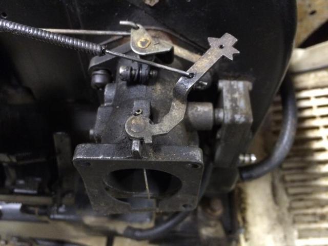

No progress on the G14 until this weekend as I have been doing some work on my Bolens HT23.

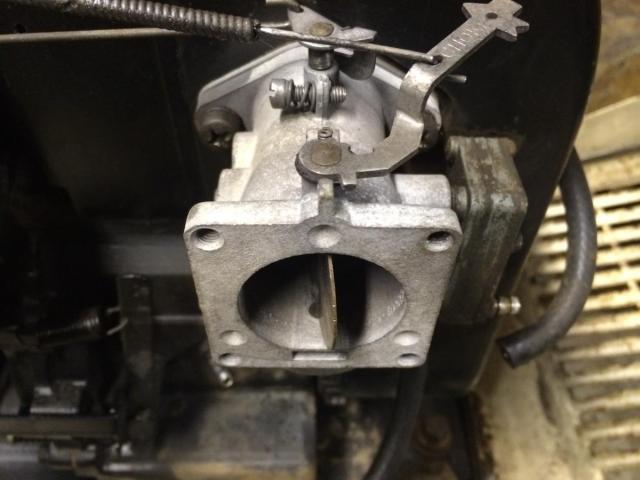

I pulled the carb off (again) and took it apart, again no obvious signs of any debris. I put it through the ultrasonic cleaner which certainly made it look visually better. It started looking like this
and ended up looking like this
I connected up the fuel and it started up without a problem. My test driver took it for a 1/2 hour drive without issues. It passed the smile test.
