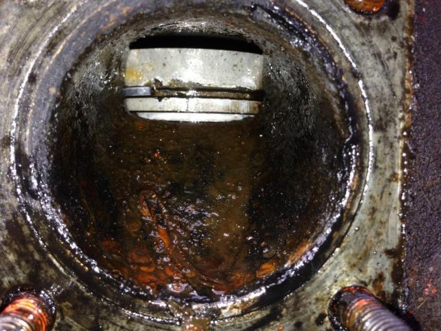

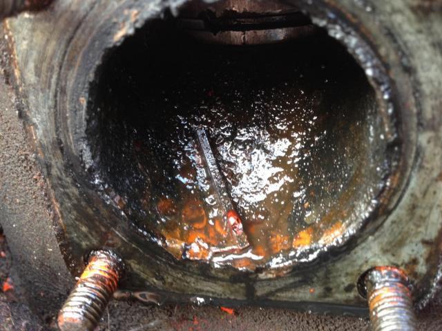

Well I think I'll be holding off on trying to start it now, I decided to pop the exhaust off and this is what was I was confronted with
Part of a rusty piston ring 😟
And a few little lumps taken out of the piston ring groove,
question now is, what are my options? Not sure on the spares situation for these, I'm guessing quite good in Germany as they seemed to be used in a lot of their machines, but I'm not sure over here, or do I try and look for another engine?
