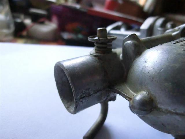

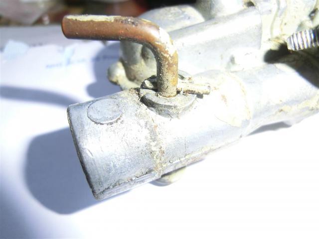

Wristpin 399 #26 Posted November 23, 2015 (edited) Carburettor. The choke should stay put with friction supplied by a small compression spring and its position located by a pin moving between two cast "upstops" in the carb body. Valve chest cover. May just be a perished gasket or the flange may have been distorted by over tightening. If the latter a squirt of sealant either side of a new gasket may sort it or even two gaskets . If you carefully slacken the nut holding the exhaust box onto its manifold will allow you to swing it out of the way. Take time to work the nut loose as its not difficult to shear the threaded end of the manifold. If the worst happens you can drill and tap the end of the manifold to take a set screw. Edit. Just got brain into gear! What you are seeing is possibly not a leak as such but oil vapour being expelled through the breather valve incorporated in the cover. Take the assembly off and give it a good wash in petrol . Don't go poking around in the flap valve as this may make things worse.If the valve is sticky this should help but if the valve is worn or the engine is worn and "breathing" there's no quick cure - just live with it! Edited November 23, 2015 by Wristpin 1 nigel reacted to this Share this post Link to post Share on other sites
jonnym 9 #27 Posted November 24, 2015 (edited) Thanks again, great info as usual. The leak was quite large. The top plate was a wash with oil and I could see it coming out! I will try resealing the gasket and see how I go. The choke has the spring assembly with it and there is slight resistance, I wonder If I have a problem further up the carb forceing it, also as you can imagine as its on a rotovater it does jump around alot exasperating it. Thanks again Jon Sent from my GT-N7105 using Tapatalk Edited November 25, 2015 by jonnym Share this post Link to post Share on other sites
Wristpin 399 #28 Posted November 24, 2015 If the spring on yours is compressed with a similar push on retainer you could try increasing the friction by gently tapping it toward the carb body - perhaps using a small socket as a driver. Share this post Link to post Share on other sites
