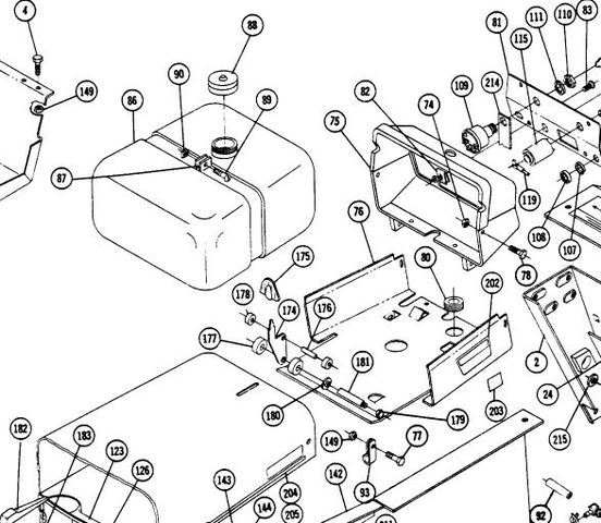

Anglo Traction 996 #4 Posted September 8, 2016 If the Tank look's like this Rex, it may be difficult to find one- It may be possible to use one from the slightly later models of 72-ish which are similar, except for the Strap and possibly the Fuel Tap. That style should be much more common. Share this post Link to post Share on other sites

Anglo Traction 996 #8 Posted September 20, 2016 If Neil hasn't got one, I have a clean '74' Black Tank I keep as a spare (not under my bed), but am prepared to part with it for a good cause. It needs a new rubber Bush and specific Fuel Tap. I also have the fixing wire and can make you up a retaining spring. You will most likely have to make the centre hole in the Tank Plate base a little bigger and drill an extra 1/8" diameter hole, otherwise it will fit straight on. To give you an idea, I can obtain the new Fuel Tap and Bush from the U.S for about £22 total. Share this post Link to post Share on other sites
