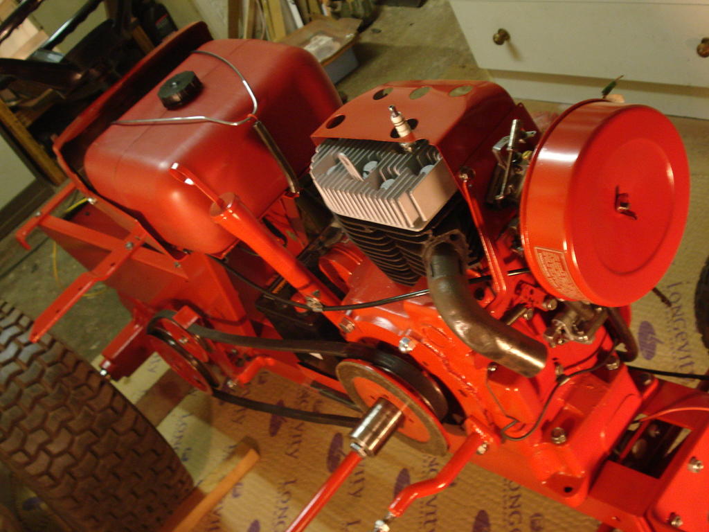

Anglo Traction 996 #4 Posted August 1, 2017 Ok, then your belt part number is 7473 and it should be 81.95 inches, so your 82" is the correct size-ish. As for a Pic, all I have is this one which is also a 7473 Belt on the same layout as yours- Regards Share this post Link to post Share on other sites

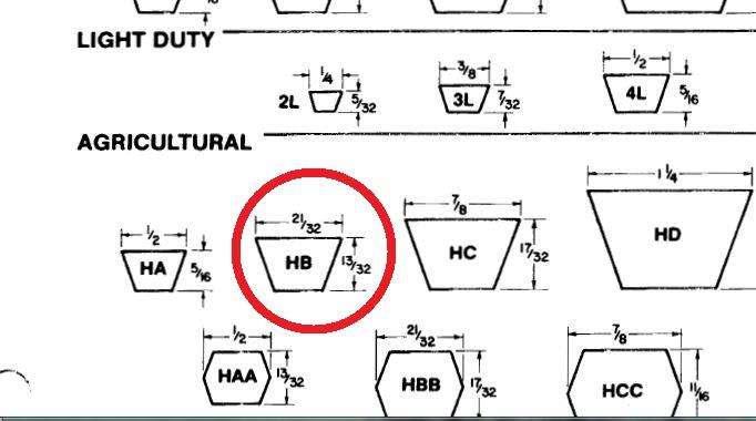

Anglo Traction 996 #6 Posted August 2, 2017 No problem. If you are getting a genuine toro part 7473, then all will be fine. If you get an Aftermarket alternative check that the section of the Belt is as near to these dimensions as possible- The reason is that the Disengagement Tabs on the Belt Cover must be properly adjusted and the Belt must be just proud of the Engine Pulley for it to work properly. Share this post Link to post Share on other sites
