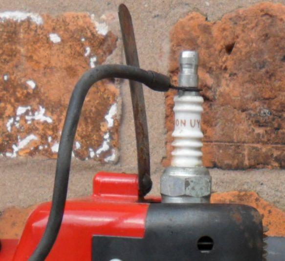

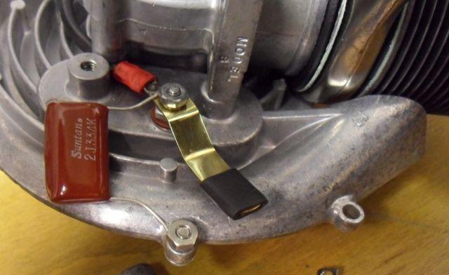

There are two ways to stop the O&R engine, one is the brass stop switch on the back of the magneto plate (exhaust side) or a remote stop switch (used on some tools), both of these short-out the primary of the magneto. The second method is to close the choke (as you mentioned). On early engines there was an optional third method, a shorting strip for the top of the spark-plug, shorting the spark-plug can be used if other methods of stopping an engine have failed (usually with a well insulated screwdriver).
Here is a picture of the brass stop switch,
And the (optional) HT shorting strip on an early engine,

No damage will happen to the coil or condenser from using the brass strip stop switch, it simply shorts out the primary winding of the coil to the engine casing, the primary windings consist of a small amount of turns of thick wire. Magneto coils usually fail on the secondary (high tension) windings, which consist of a lot of turns of very fine wire, failure is usually due to water ingress/insulation breakdown or corrosion of the wire (fails open circuit).
Battery coils are a different matter all together, the primary windings can burn out if energised continuously.
