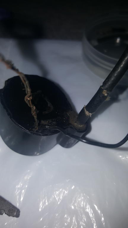

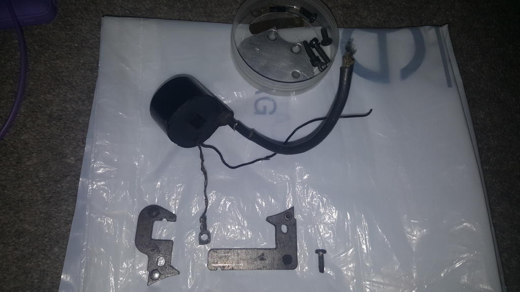

I also wondered if there is anyone with knowledge of coil/condenser repair? These parts of the engine have developed a fault and is choosing not to spark. Will check more closely tomorrow to be certain but I fear internal breakdown of the coil.

They usually need the contact breaker points cleaning, I don't think I've had many problems with the coils (except with really early engines), the condenser can be replaced with a modern one if it is faulty and Webhead or Wallfish have got any spares. I keep looking for a modern condenser/capacitor that would fit inside the original can, but haven't found anything suitable yet.

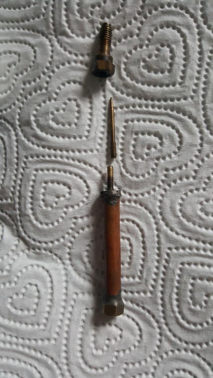

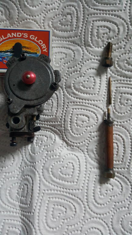

In regard to the carburetor needle, I have included a picture below so you may see the damage that occured. Please let me know how much you require for the replacement, I am able to send the broken one back to you if you feel it's fixable?
Haven't seen this needle type on other engines, not sure if it matters?

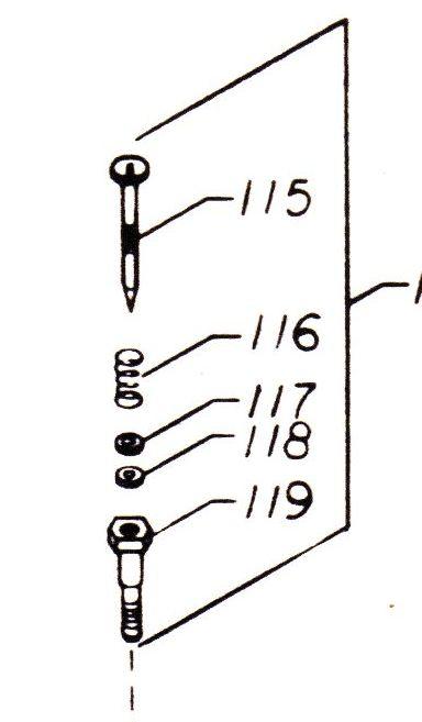

Is the needle housing OK and have you still got the spring, washer & O-ring seal? (see diagram below).
59ee4797ccfc7_OhlssonRiceCompactEnginesCarbNeedle.jpg.020a255ef866cbb3b297dbfbde4e47b2.jpg
The carb needle from your engine looks to have been modified/extended, the brass nut on the end of the copper section almost looks the same size as the housing the needle screws into. Both the brass needle & housing are quite thin in section and are very easy to break if overtightened.
If you still have no spark after checking the contacts, then check the resistance of the coil secondary & post the resistance measurement.

In regard to the needle valve, as shown in the picture I uploaded, is all I have unfortunately, there does however appear to be a seal of sorts upon to the top of the housing for the needle screw.
It's marked slightly and the original was damaged/broken due to over-tightening from small hands - hoping the housing is fine, I will try to get better pictures uploaded tomorrow for that.

I have needles and screws. As David said, do not re-use the foam, clean and re-gap the points, and the coils rarely, if ever, go bad.

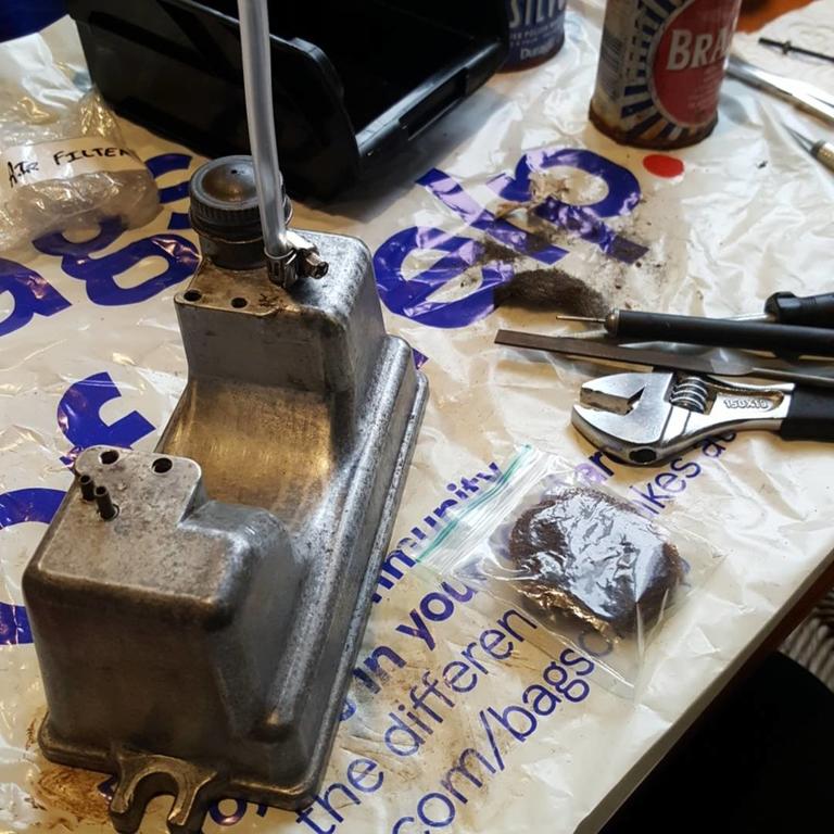

In regards to the fuel tank, I've managed to clear the majority of the gunk inside (still soaking on third round of petrol + nails/junk) and have cleared the two breather feeds on the tank with no problems.
The fuel feed (internal to the tank) that goes to the carb still seems to be blocked (no flow through of fuel, even when inverting the tank) - any ideas are welcomed, would prefer not to crack open the bottom unless I'm left with no other option.

One of the tank nipples is for a jumper, breather hose to go to the other side of the tank to allow the tank to siphon fuel when it is filled past the arch. You can use a wire
to clean it. The other goes to the bottom of the tank and has a screen in it. If you push a wire too far, it will push out the screen or poke a hole in it .
I use lacquer thinner to clean the tank
and hook up a hose to blow and suck in to it. Eventually it comes clear.

Sounds like the fuel & internal filter are quite clogged from old oil/fuel mix, I suspect the carb will be just as bad. It's usually a good idea to use fresh fuel mix and drain the fuel mix when these engines are not being used, as well as for long term storage. This didn't always happen, leading to clogged filters & gummed up carbs.
I have even had several engines shipped with decades old fuel mix still inside the tank, not a good idea either as shipping companies usually prohibit shipping of any item containing fuel.
It would be interesting to see a link to the "lacquar thinner" product Webhead mentioned, to see if we can find an equivalent product in the UK.
With the last tank I cleaned I figured out another way to clean the filter, using the fuel/oil measuring kit I have.
I originally had a 10ml plastic syringe for measuring small amounts of oil & a 400ml jar with 100ml measurements on the side. After the rubber part of the syringe eventually perished & got stuck with oil/fuel, I searched and found a set of glass syringes (2ml, 10ml & 50ml) intended for medical/laboratory use that wouldn't get damaged with fuel or oil, I also found out that the fuel line could be attached to them.
Using the largest one (50ml) & a short piece of fuel line I filled it, attached it to the tank pipe and used it to gently push fuel in to clear the internal filter without damage. Webhead's suggestion using a longer piece of fuel line sounds good too.
Webhead is right about the filter screen being easy to damage, it happened with the first one I cleaned many years ago. I ended up adding a very small in-line filter with that one. I believe people have opened the tanks (usually when they are leaky) but then you have to figure out how to open it without damage and then seal it back up again. Not something I've tried yet.

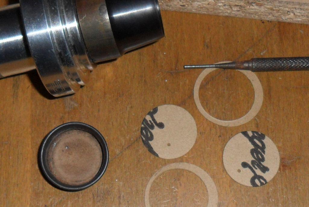

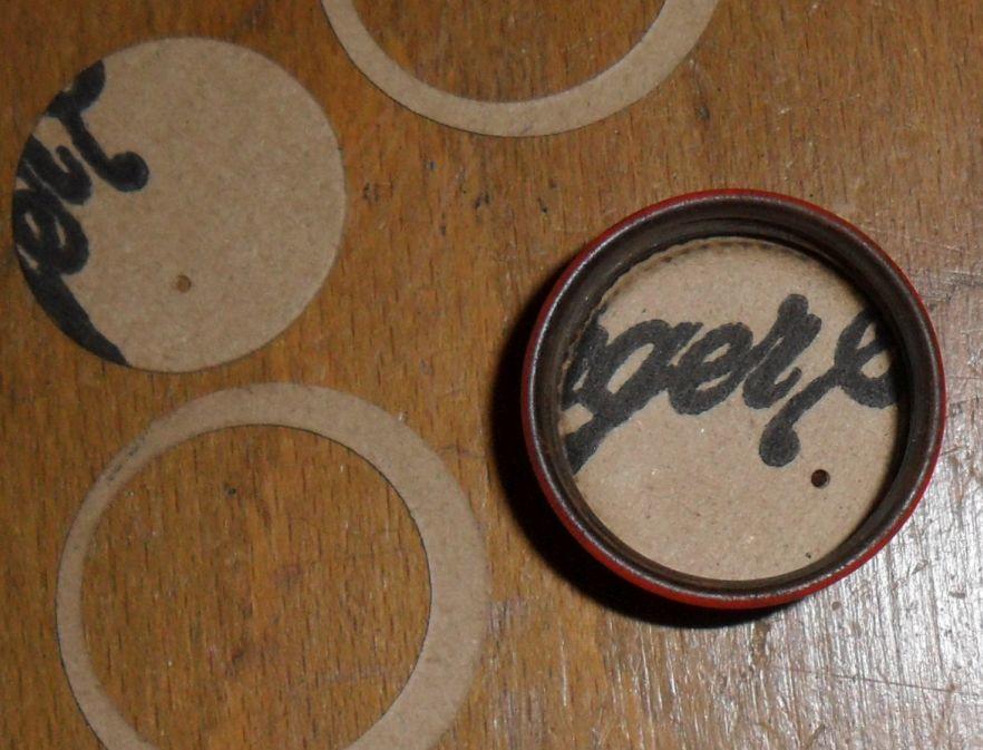

Just a go a making some tank lid seals using a couple of offcuts of gasket paper. Nearest hole punch I have in my kit is 26mm and I used 1/16th punch for the vent hole, took a little searching to find a lid without a seal to test fit it with.
Anyone know the best thickness of gasket paper to use? I have gasket paper in the following sizes, 0.006" (0.15mm), 0.01" (0.25mm), 0.016" (0.4mm), 0.031" (0.8mm) and 0.063" (1.6mm) I don't really want to damage any originals to find out.
David

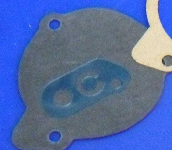

It appears that the diaphragm is actually in pretty good shape but.. There are a couple of bits missing! (See image below)
-Diaphragm ball valve
-Diaphragm arm
-Diaphragm arm spring
-Diaphragm disk
There isn't a gasket either but I'm told this isn't required and can be reassembled without.
I assume the carburetor won't function correctly without the ball valve, arm, spring and disk - does anyone have these spare that I could purchase them from?

A have a few damaged carbs, I will have a look tomorrow to see if they still have the parts needed inside, any of the small parts inside can occasionally be missing if someone has been in there before.
Looks like the check ball for the valve will be the larger of the two types used, most are 3/32" diameter except for early ones which are 1/16". An O&R service bulletin recommended fitting a new one during repair, as they had problems with them sticking even after cleaning. Stainless & chrome steel balls for bearings are still available in imperial sizes.
I can't see the small roller that sits under the end of the diaphragm arm spring, the size is 0.062" diameter, I did make one for my first engine from a piece of rod salvaged from a broken cassette player.
Also I can't see the clear plastic check valve gasket, early carbs had one made from the same black rubber material as the diaphragm. See the picture below showing a laser cut replica, thanks to Wallfish for providing me with some of these.
You may want to change the exhaust gaskets, as they tend to leak when reused, not something you want when you've cleaned everything up, I found out the hard way with my first restorations.

You may be right - what came off of/from the carburetor is in the picture I sent previously.
I take it the Mylar check valve is the plastic gasket-like film atop the diaphragm in the image above? If so there isn't one of those here.
Yes the check valve is the transparent blue plastic sheet gasket shown on top of the diaphragm in the picture (they were fitted to my Tiny Tiger 400), the originals are usually clear (early ones are made from the same black rubber as the diaphragm), some have probably fallen out un-noticed when previous owners have tried to get them working. Sometimes they seem to be stuck to the thicker gasket (both items are part #6 on the diagram I posted.
David
David
Does this material have any specific qualities other than being made of Mylar?
If someone has a template of one to scale I could probably cut one by hand with scapels.
David, in regard to exhaust gaskets and their replacement, are these readily available or would they need to be machined to spec?
Cheers
I don't know what sort of Mylar was used, but they are usually re-usable, I found a good used one yesterday, also Wallfish had some new ones made as I mentioned before.
Here are two pictures of the earlier rubber type check valve, I think it's obvious why I now consider this type a "replace on sight" part, sometimes the valve flap is missing or detached.
SAM_7184a.jpg.e8b19521bc876a9502691666d39a4d61.jpgSAM_7185a.jpg.a8afb865ed1eba0d8c7fc3bfc2ad5907.jpg
I've been cutting my own gaskets, but do have some originals, I also bought new O-ring seals for the cylinder in the nearest available metric size, took me two attempts to buy O-rings of the right thickness. See this thread for more on that;
I would be surprised if Webhead doesn't have new old stock exhaust gaskets too.
David

Decided on finally tackling the coil today, I fear I've discovered why there is no spark though! 🙈
There are 3 smaller wires that come from the coil along with the HT lead that would go to the spark plug.
Two are twisted together (appears to be intentional) and go from a small hole onto the bolt which holds the two parts of the coil frame together, these are not insulated and are visible above - one of the two had snapped off where it enters the coil.
The third is, I believe, for the engine stop and although also broken and lacking insulation in places, feeds to the rear of the spark-gap assembly with the condenser and engine cut off switch.
This one can be soldered onto a replacement wire and should be fine - the other two I'm not so sure about as the break is flush with the exterior of the coil itself and I can't see any easy way to get inside to reattach or replace the broken bits.
Hope the images are clear enough to see what I mean, any ideas on how best to approach this one, gents?
Also - my engine says 'type 151', I wonder if this means anything when compared with others that say 'model b' .. ?
Cheers
