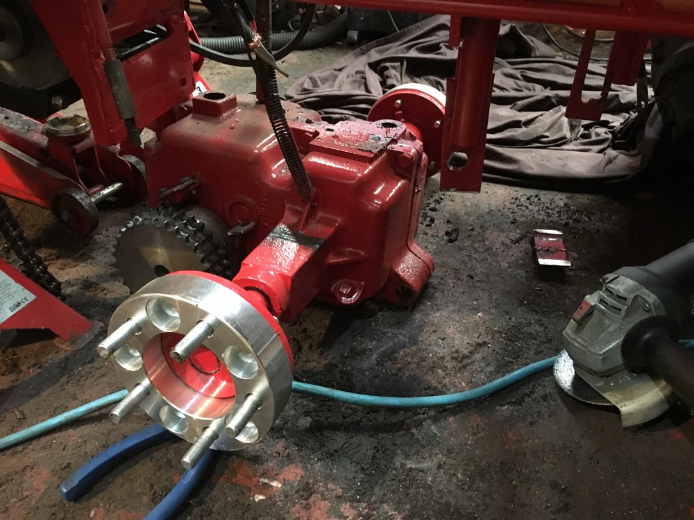

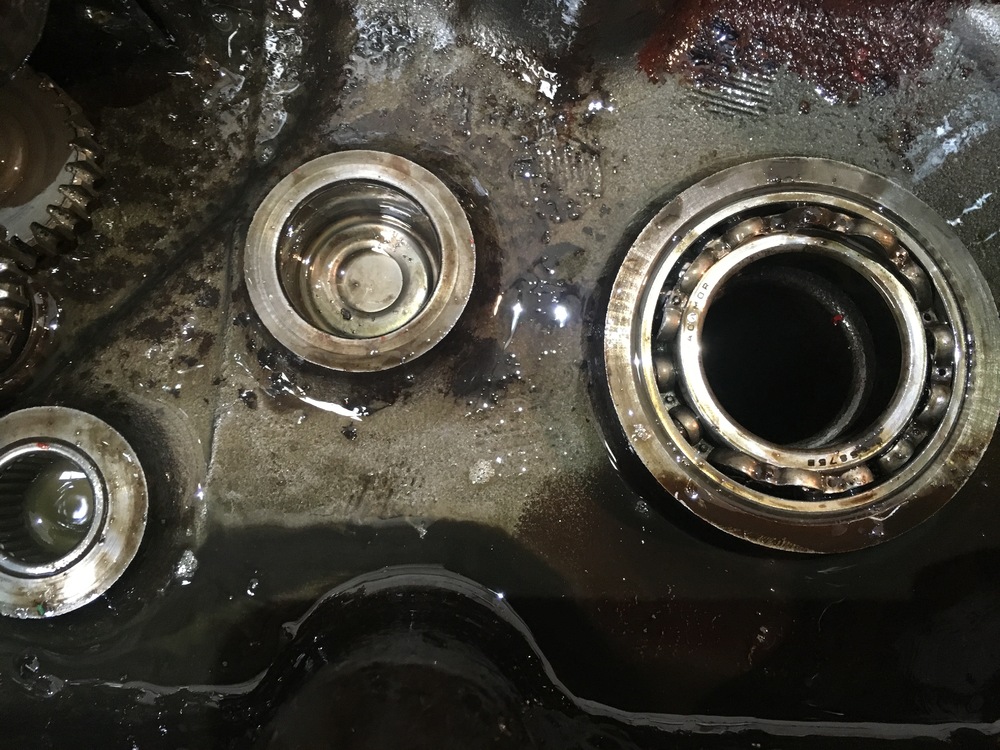

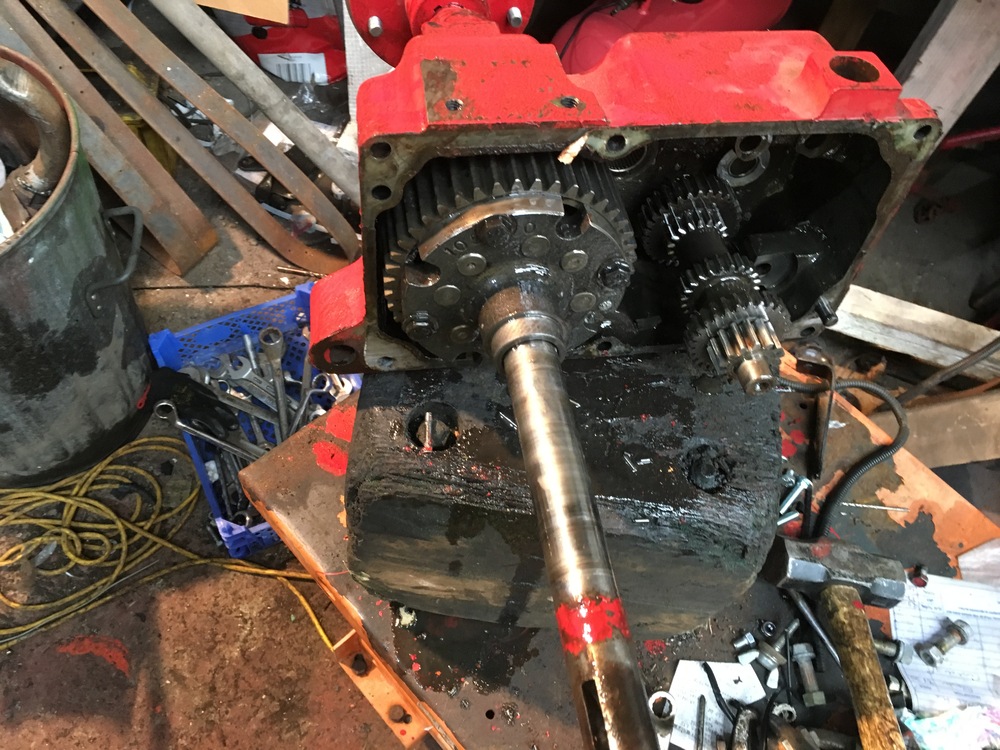

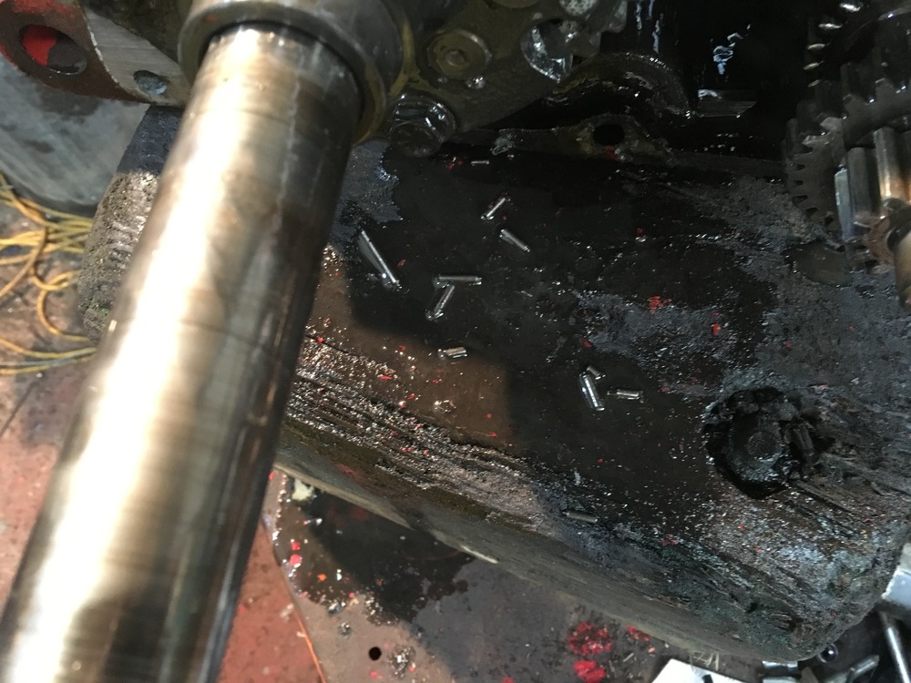

Evening all just a little update chaps I had a little trouble with the centre gearbox as it was leaking oil so I've decide to take the box out and see what can be done ! Bearing in mind it's only 4 weeks to Newby hall I need to get cracking  the problem is the needle roller bearings have collapsed in the axle casing were the half shaft comes out !
  Oh dear! :( That's what I found had happened with the C-121 when I got it. The needle roller bearings you can get. The main ball bearings are scarcer then rocking horse poo. I had the cases modified to take metric bearings. Look in my C-120 rebuild topic.
It's funny you should mention that Norm me and mark discussed that earlier what you did I may have to rack your brains !!
