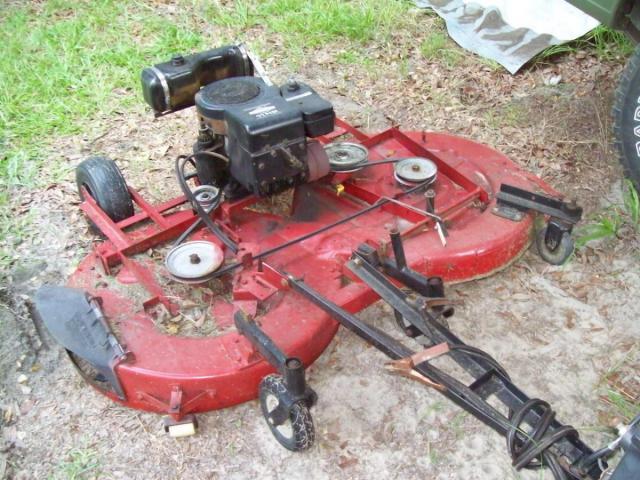

home built 5 foot pull mower
This is made of 2 decks welded together with bedrail frame and wheelchair casters. You would need fairly flat yard because with a wide deck it will bottom out in a ravine. At this time I have an option straight behind or offset drawbar but you have to change the hitch pin to get more offset. This is handy for trimming under bushes but you can also change to get into narrow places. I am in the process of building an electric drawbar to adjust width without getting off my butt.HA HA .The 12 horse is plenty of power for the 2 decks.
Do you ever stop ??
Don't stop but slowed down after 70. The 2 decks were 30 inch so that makes 60 and depending on the hitch offset the tractor has 36 inch but 7 feet is about all you can do without skipping a patch and old farmers hate point rows HA HA.
