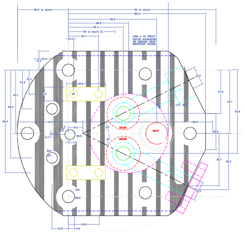

BarneyC 2 #1 Posted Sunday at 05:19 PM (edited) There is no benefit to making an OHV version of the Suffolk punch engine but it makes a challenging project and if you like to see exposed valve gear at work it adds a bit of old fashioned spice. The design is reversible so the engine can be returned to its original state if you wish. This is going to be my last post about Suffolk punch mowers as I don’t think anyone is interested. The project is fully designed with detailed drawings of all the parts but I have snipped out just one extract so you can get an idea of how it goes together. If anyone wants the full set of drawings I would be happy to put a copy in the files section. Edited Sunday at 05:21 PM by BarneyC pdf not showing Share this post Link to post Share on other sites
