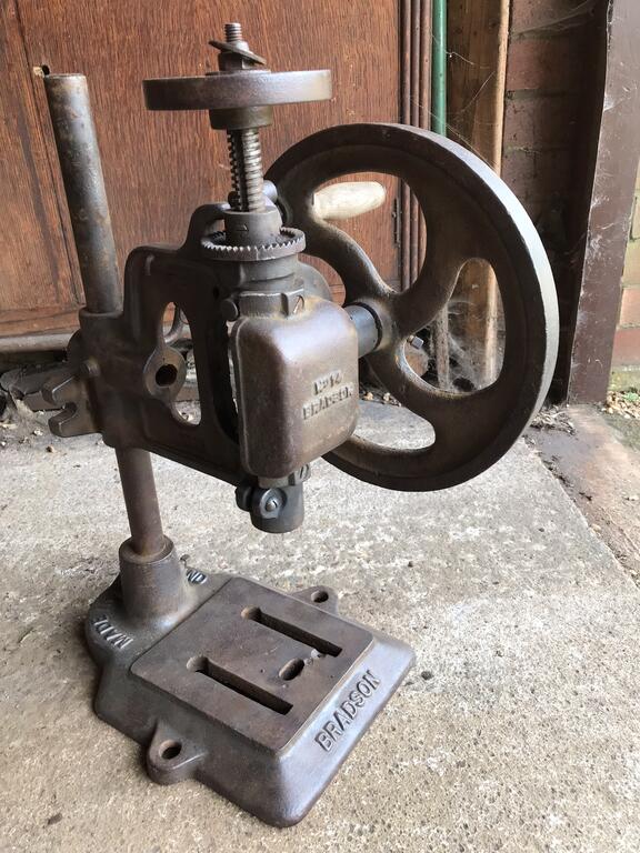

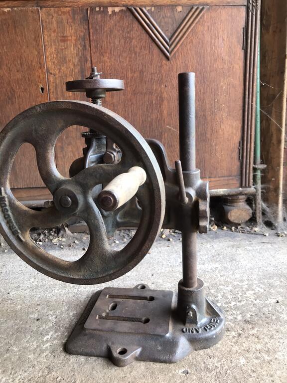

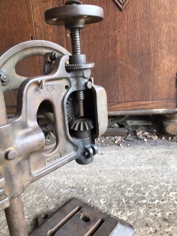

John G 0 #27 Posted April 16, 2024 Thank you very much! here are some pictures of the one I am working on. Share this post Link to post Share on other sites
Anglo Traction 1,017 #28 Posted April 17, 2024 Ok, yours is probably a bit older than mine. It has the square headed lock screw on the base collar to retain the column. There's probably one holding the handwheel on as well. Mine are hex socket grub screws. they are all whitworth form threads. I see you have the upper 3/8" dia spindle section !. It may be worth measuring it and compare it to my given dimension, There should be about 1 1/4" of 3/8" whitworth thread at the top and the nut should be of the Locking type (like an old version of nylock) I'll check my scrap bin again, as it was the top section of the `spindle' that I cut off and used. There is also the stop collar missing which measures 43.4mm x 42.32mm diameter and 3/4" bore, it also acts as a weight to assist feed rate. It all looks salvageable, even welding up the drill holes in the base. Share this post Link to post Share on other sites
