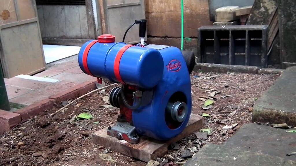

Mowersman 2 #3 Posted March 2, 2014 Sorry, I'm not explaining myself very well Kim, I realise there were several different bolt hole arangements for the sumps, but there were 2 ways in which the sump attached to the engine. You can see on this one that the bit of the block where the sump bolts on is fairly short and the oil filler is in the sump. But on this one, the oil filler is cast into the block, which sticks out much futher. What I'm after is a sump that will bolt onto the Barford chassis, that will fit this later type engine. Andrew Share this post Link to post Share on other sites
Mowersman 2 #4 Posted March 2, 2014 The engine in this listing shows the type of sump I'm after! http://www.ebay.co.uk/itm/Villiers-Stationary-Engine-Mark-12-/291092201026?pt=UK_BOI_FarmingEquipment_RL&hash=item43c6727e42 Share this post Link to post Share on other sites
