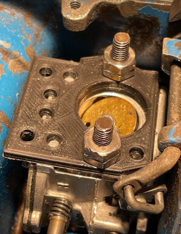

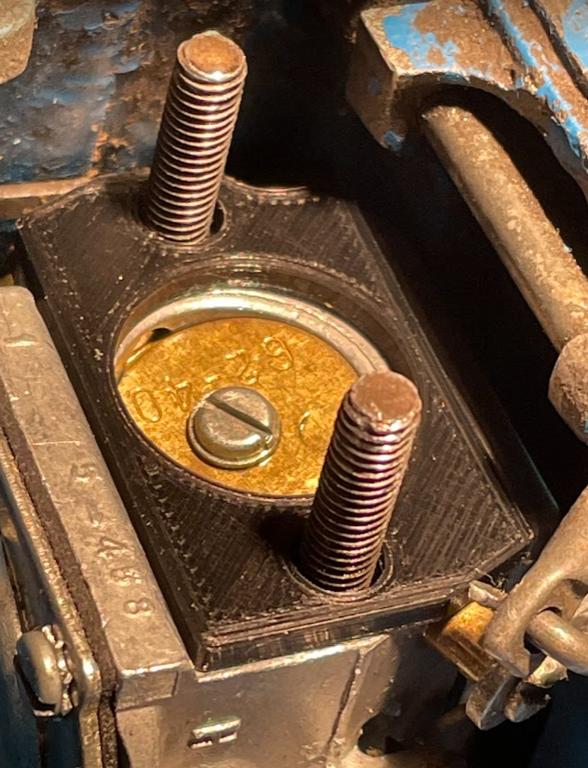

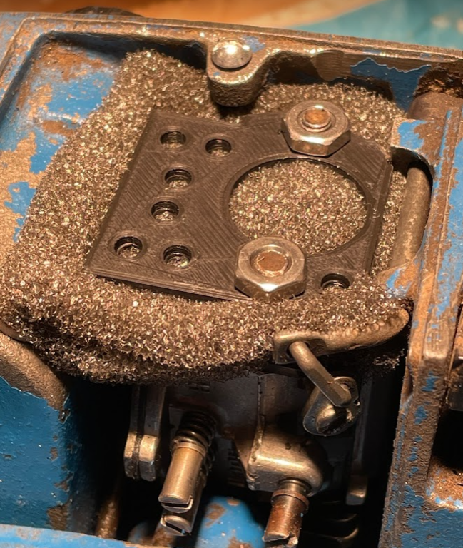

No, printed filament from an Ender 3.  Flexible TPU for the gasket and PLA for the plates. Time will tell how the filament lasts but it was a quick and easy alternative.
