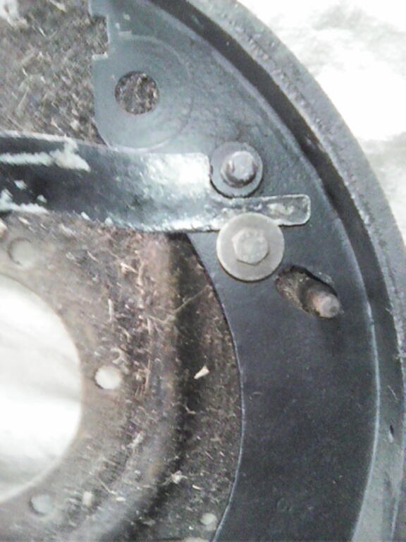

Try-umf 0 #1 Posted December 10, 2024 1936 Triumph Gloria rear brakes It's springtime! Not quite perhaps but I would like to know how or where this spring fits (circled in yellow, part #5167) and its purpose. I am aware they are handed and that it must hold something in place. The brakes came to me disassembled so I have never seen them on the backplate. My best guess so far is also shown. To me it does not feel right, the shorter curved end looks as though it should wrap around or rest against something. Share this post Link to post Share on other sites
Aiberdonian 98 #2 Posted December 10, 2024 Try-umph, It has been a while since I did the rear brakes on my Gloria and I can't really remember where that spring fits but it is there to pull against the hand brake cable which connects to the slot on the lower arm so it must push against the lower arm just above the slot . It certainly does not fit against the cross arm which pushes against the shoes. I would offer to take a look at mine but it is - 8 deg C at the moment and does not look like rising above zero for a few days. Share this post Link to post Share on other sites
Try-umf 0 #3 Posted December 10, 2024 Thanks - for the info. With the parts book refering to it as 'spring push rod' I thought it may refer to the bar that pushes the two shoes apart when the handbrake is applied. The problem I have is that I can not see a way of th espring actually making its way to the handbrake ctuating arm if it sits on the pivot as the coil in the spring suggests. Share this post Link to post Share on other sites

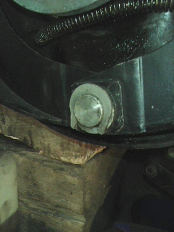

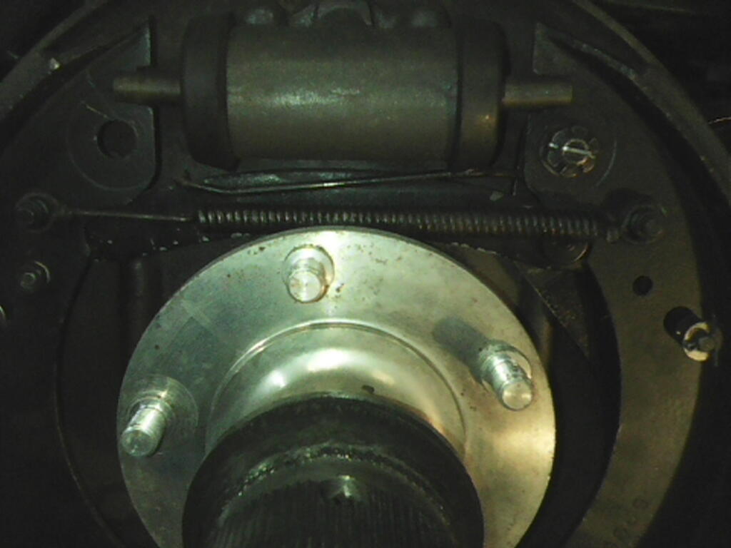

Aiberdonian 98 #6 Posted December 14, 2024 Fired up the wood burner in the workshop this morning, discovered the trolley jack low on oil, topped it up and removed the wheel and drum from the Gloria to find that the spring does act upon the cross shaft. It actually pushes down on the shaft as above, I couldn't see where the tang locates and I was not about to dismantle it to find out but you should be able to figure it out as you assemble it to the brake shoe. I had to use my steam driven phone as my camera has decided it has had enough and the screen has gone blank and if you have read my post about my sympathetic restoration of my Gloria in this section you will already know that modern technology and I don't get on very well. Which model of Gloria are you restoring ? Share this post Link to post Share on other sites

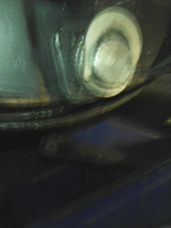

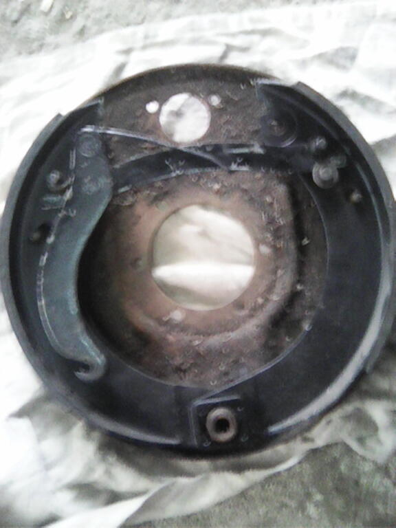

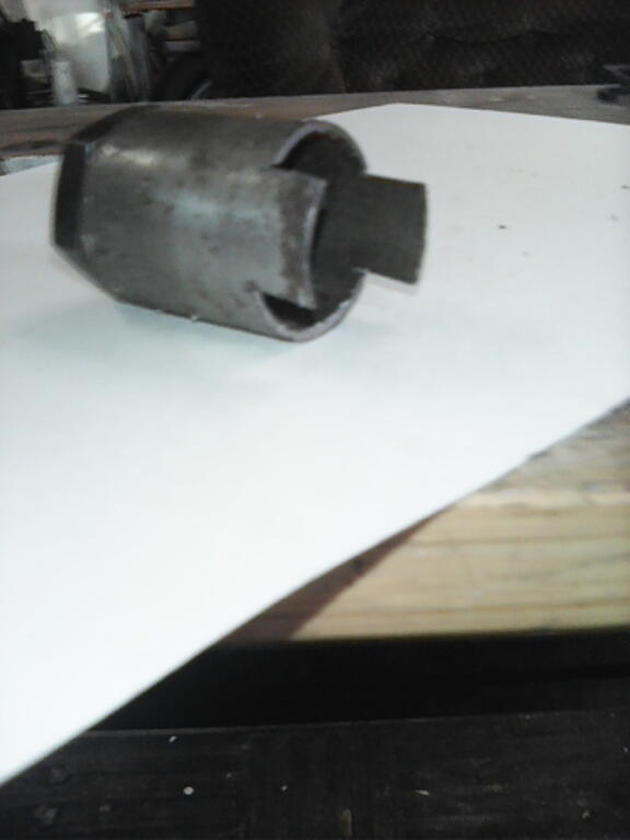

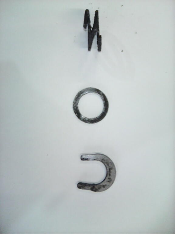

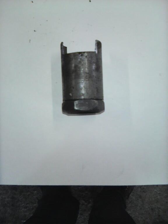

Aiberdonian 98 #8 Posted December 16, 2024 HOLD IT - I'm wrong! I raked out an old backplate and shoes to try the hand brake mechanism and found that your initial set up with the spring pushing upwards on the cross shaft is correct. If you look at this photo you can see that I modified the brake shoe with a bolt and collar to prevent the cross shaft from being pushed off the pin on the shoe. I then removed the spring and turned it round to correct position and when replacing to back plate discovered that the spring was fouling the boot on the wheel cylinder which explains why I modified it in the first place, I have now bent the spring a little to clear the boot and it seems OK now. As far as the anchor pin is concerned the brake shoes fit directly to the pin followed by double spring (thackery) washer X634 then plain washer X566 before fitting the circlip 7191. X 634 is 1 5/16" OD x 7/8" ID x 1/2" non compressed X 566 is 1 1/4" OD x 7/8" ID x 0.062" thick Fitting the circlip is a real PITA as the spring needs to be fully compressed before the clip can be fitted. I made a tool from a piece of thin section tube with 1" ID as below Damn I've loaded it twice, however by placing this against the plain washer with tags at 12 and 6 o'clock and using a G Clamp you can compress the spring and get the circlip started in the slot and then tapped down to meet the top tag as below Slacken clamp and remove before tapping the clip fully home. Share this post Link to post Share on other sites
Try-umf 0 #9 Posted December 16, 2024 Many thanks. I have been shown pictures of the spring fitted to push the cross bar down but as you have shown my intuition appears correct. It should be pulled up so the step in the arm is in contact with the pin. There is in the parts diagram th ecorrect locating arrangement in place of your wsher. It consists of #4072 (slotted cover that goes over the pin and held in place by the bolt) , #4073 (a steped bolt) and #5130 ƕ washer and castlegated nut and split pin. I'll take and post a picture. What is the saying about great minds? I had the same plan when it came to compressing the Thackeray washer. The thickness of the washer is a great help. I'll machine up four washers from some 1 1/4" stainless steel bar I have. What a job this is! Share this post Link to post Share on other sites

Aiberdonian 98 #11 Posted December 18, 2024 That's good information but those diagrams show the spring pushing down on the cross bar - what is the correct way ? When I reassembled my brake shoes I couldn't get the drum back on because the tang on the spring was resting against a collar on the reverse side of the brake shoe spring pin which meant the shoes were being held apart by the thickness of the spring. I bent the spring so that it rested on the pin rather than the collar and managed to get the drum back on only to find that the brake cable has stiffened up to the extent that it no longer moves easily, I think it may have frayed inside the outer casing. Here we go again ! Share this post Link to post Share on other sites
