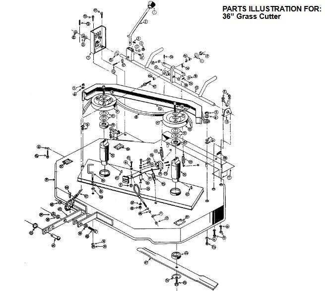

mark1967 0 #1 Posted May 26 I have a rather rough old Westwood Gazelle that I'm getting going. I need to change the deck spindle bearings but I'm unsure as to how to get the old bearings out. The deck is a sort of hexagon shape there's nothing that undoes or covers that come off and the only way appears to be to use a large "adjustment tool" and knock them out from either the top or bottom ??? There seems to be next to nothing on the internet about this style of deck,the only thing I found is a parts diagram which appears to show them coming out from the top.Suggestions please. Share this post Link to post Share on other sites
mark1967 0 #2 Posted May 27 Got them out ! For anyone with the same deck its not quite as it suggests in the diagram.The bearings are in a tube welded into the deck that has a step in the bore top and bottom to prevent the bearings going in too far.Remove the pulley, give the top of the shaft a good tap (I used big copper hammer) and the shaft comes out through the bottom leaving top bearing in the tube.Press bottom bearing off shaft,then flip deck over and just knock out the top bearing ( I used a length of steel pipe).Luckily whoever was in there last copper greased the tube to death so they didn't put up much of a fight. As Mr Haynes used to say "refitting will be a reversal of the removal process", Press bottom bearing onto shaft, press into tube until bearing hits the step in the bore and then press in top bearing,job done. Bearings are 6205RS 52mm x 25mm x15mm. Share this post Link to post Share on other sites
