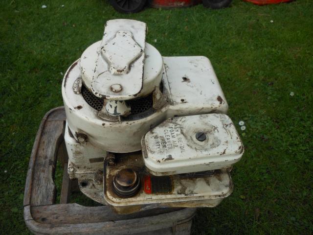

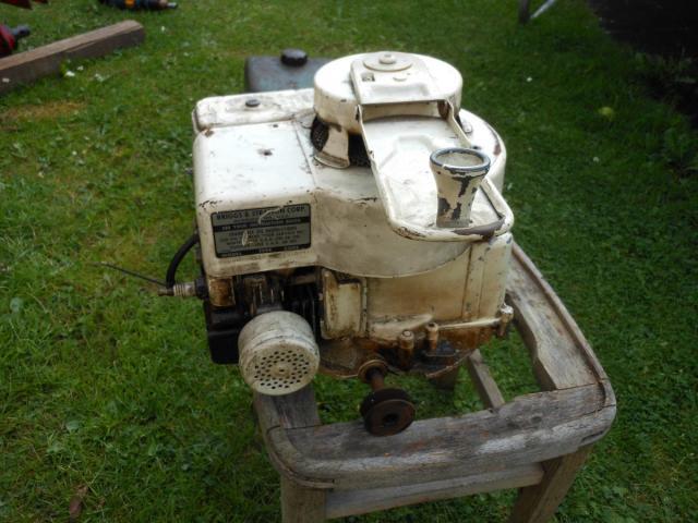

sten 84 #1 Posted August 4, 2014 This 1965 B&S 3.5hp has the unusual wind up starter. Share this post Link to post Share on other sites

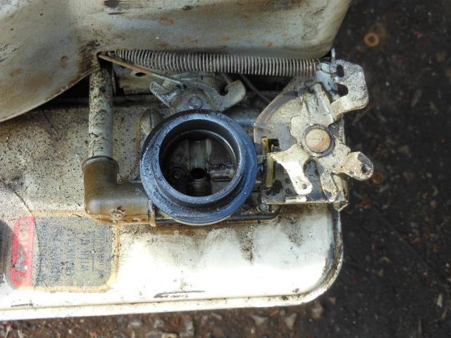

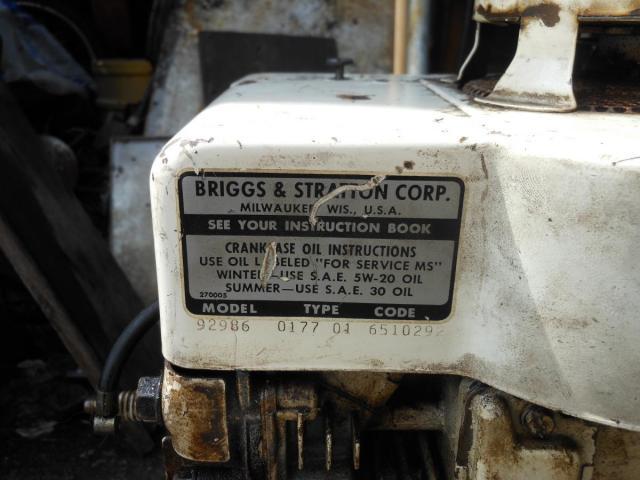

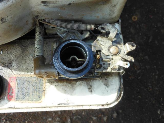

Wristpin 399 #7 Posted August 5, 2014 (edited) The choke is controlled by cable, That would be the throttle cable; are you saying that it is operating a mechanical choke when past the full throttle position? Please post an image with the air filter removed and perhaps the Model, type and code of the engine. Edited August 5, 2014 by Wristpin Share this post Link to post Share on other sites
sten 84 #8 Posted August 5, 2014 That would be the throttle cable; are you saying that it is operating a mechanical choke when past the full throttle position? Please post an image with the air filter removed and perhaps the Model, type and code of the engine. Yes past full throttle position. Pictures with choke off, on and numbers. Share this post Link to post Share on other sites
Wristpin 399 #9 Posted August 5, 2014 That makes sense, you had me worried for a while! Share this post Link to post Share on other sites
