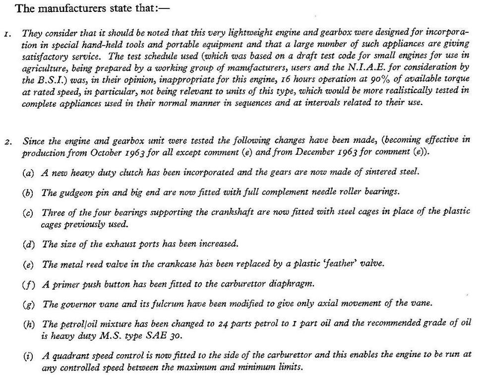

This should probably be in the O&R section, the NIAE test was intended to run the engine for 100 hours to determine the suitably for agricultural use & the maintenance requirements, they concluded that the early engines were only suitable for intermittent use.
The first serial number tested was 030957 (model J), it had problems with the die-cast gears being very badly worn, they got through two sets of gears during a 31 hour test & the first set of gears jammed up due to a broken tooth, the clutch lining material was also worn.
They did tests on a couple more engines (model letters not stated);
  • s/n 030987 with gearbox, this also failed with a broken gear tooth after 20 hours.
  • s/n 030987 with direct drive taken from s/n 030993, test abandoned as the PTO shaft wouldn't stay tight on the taper.
  • s/n 053595 with drive through clutch, this was the longest test (50 hours), it mostly only had minor problems.
O&R stated that the NIAE test was inappropriate for this engine, see below for more info & the design changes from Oct & Dec 1963;
Note that the carb primer push button assembly was available as a kit to update earlier engines, so may not help identify engines made before Oct 1963, but as you've had the gearbox cover off you should be able to tell if the gears are die-cast or steel. The model J featured in the engine rebuild thread is one of these earlier engines with the die-cast gears & cork lined clutch.
