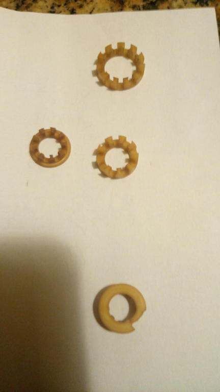

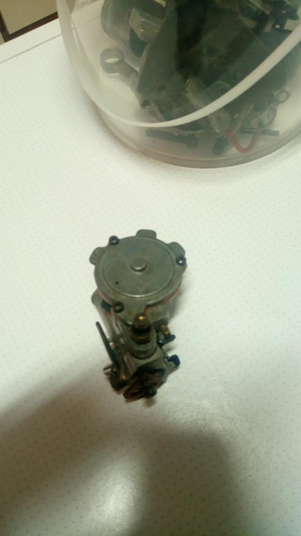

Good evening,

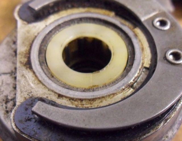

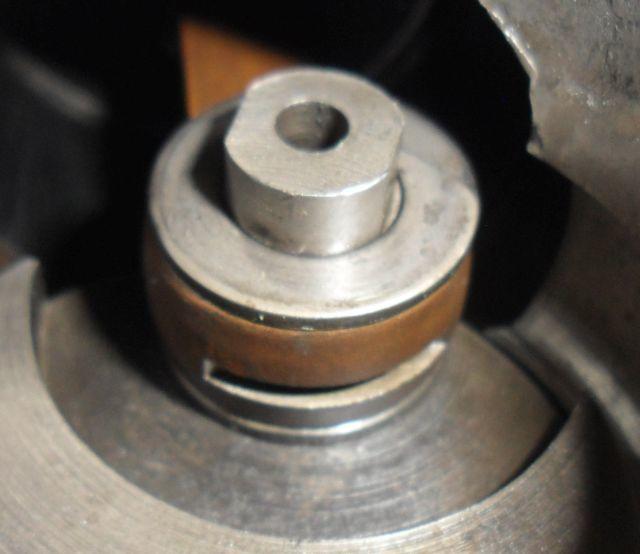

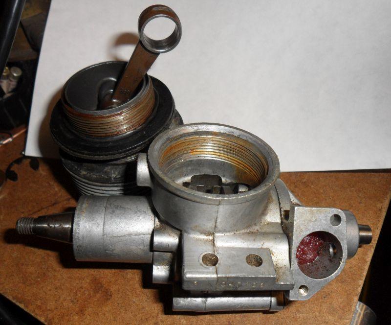

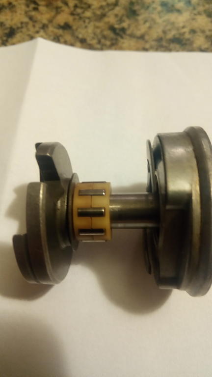

I'd like to replace the bearings that are broken or parched. I have doubts about which engine model is correct, so follow some photos.
I also need the carburetor diaphragm.
Thank´s.
P_20171215_211502.jpg.7562b481fc14f09b24c08a5ec4642719.jpgP_20171215_211338_SRES.jpg.7bab4a760c995f3d89a3507e3a268a03.jpgP_20171215_211219_SRES.jpg.389c49ba18aa722b959e205d5a29382d.jpgP_20171215_211103_SRES.jpg.90371a6480ef198485e33e9843fe41e8.jpgP_20171215_214456_SRES.jpg.ac86d810d21a8ef5e04d0774884a3c56.jpg
From the pictures that you have posted, I can tell that your engine is an earlier production 3/4HP one (Mods please correct the title) as it has plastic bearing cages for all the bearings & the metal reed valve, it will have been made before October 1963.
Oddly the carb has the updated quadrant speed control but not the primer button (maybe the bottom half of the carb has been replaced at some point).

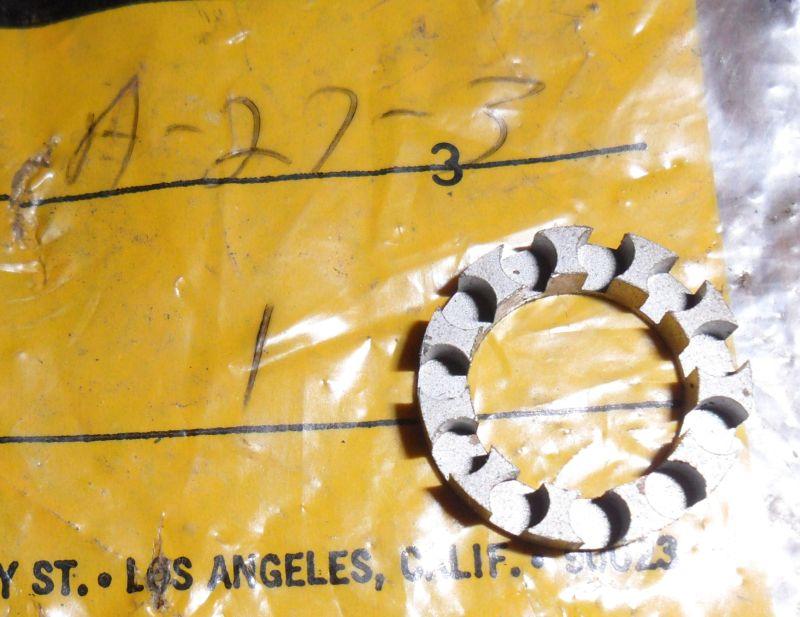

Here is the crankshaft (flywheel side) bearing part number A-27-3, the rollers are not with it as the packet had been opened, this isn't the first time I've come across an updated part with the same part number as the original part.

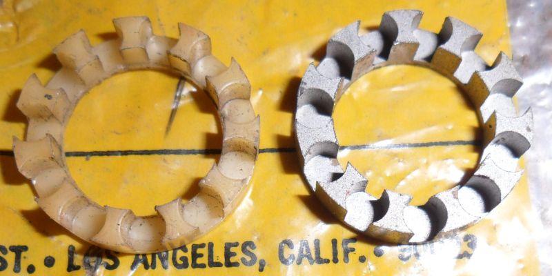

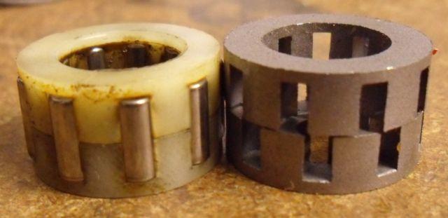

I should point out that the steel bearing cage is very slightly thicker than the plastic version, here are the two together.

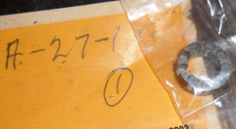

Here is part number A-27-1, this was incorrectly ordered by a previous owner of the Tiny Tiger, this bearing was only used in the first 6000 (approx) engines produced. It is also used in gearboxes for all the 3/4HP, 0.85HP & 1HP engines.

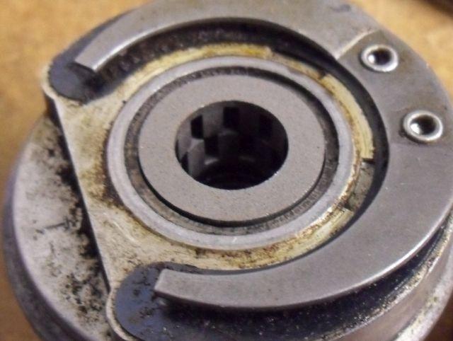

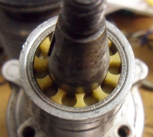

I've been checking some if some of the steel caged bearings can be fitted to the older engines that used the plastic caged bearings, using the crankcase from the incomplete parts engine (s/n 044706) that donated some bearings for the Tiny Tiger Model 400 restoration.

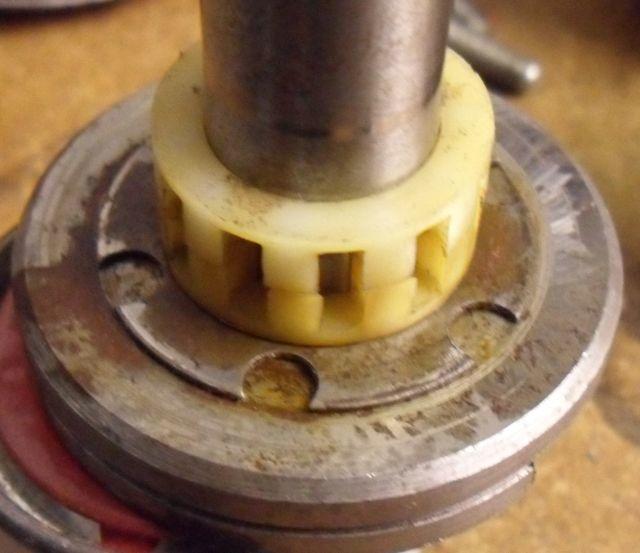

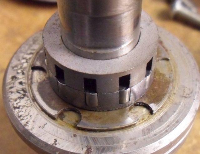

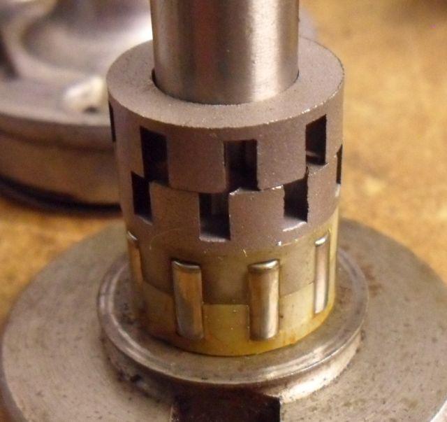

Here is the outer crankshaft (flywheel side) bearing (part A-27-3), the steel caged type fits fine.
Note the service manual states that the closed end of the cage should face outwards, as I didn't want the rollers to escape when removing it I put it in the wrong way up.

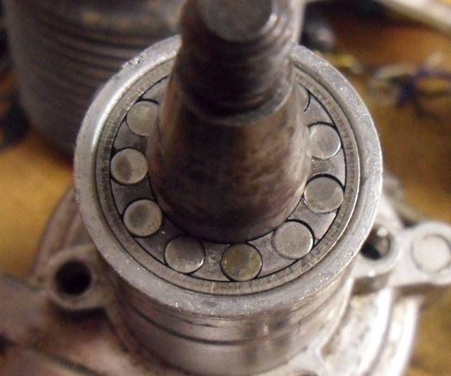

Here is the inner crankshaft (main) bearing (part A-27-4), as I don't have any of the double steel caged bearings in my spares, I used the only two single ones I have for this check, they also fit OK.
At this point I noticed the larger plastic bearing cages from the Tiny Tiger 400 have shrunk making them a force fit, not good for a bearing at all!!
I can't check possible replacement part A-27-17 as I don't have any.
Here are the back shaft (PTO) bearings (part A-27-2), two sets of these are used but I have only pictured one set.
They do fit, but could benefit from the burrs being removed before use.
Note the slight difference in thickness of the steel caged ones (I'm not sure if my spares are the single types intended for use in the gearboxes as the rollers are not in them).
I can't check possible replacement part A-27-18 as I don't have any.

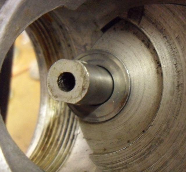

This leaves the con-rod (big end) bearing, unfortunately I don't have any of either the plastic or steel caged (part A-27-11) or washer retained (part A-20-5-13-7 ??) bearing types to check this one.
I suspect the missing bearing from this crankcase was the steel washer retained type, as one washer is still in place.

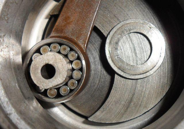

Here are a couple of pictures of the con-rod (big end) bearing in a different 3/4HP engine (s/n 074258), I only took the induction/PTO housing off this one (they also have the plastic caged bearings fitted). The con-rod bearing is the steel washer retained type, could this be part A-20-5-13-7 ??
I hope this can help with identifying suitable replacement bearings for your engine.
