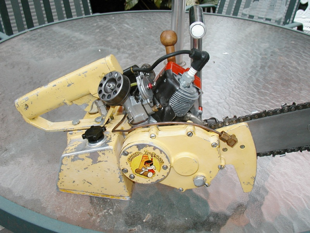

Wallfish 718 #1 Posted November 18, 2014 Courtesy of Webhead Share this post Link to post Share on other sites
Timm 5 #2 Posted December 5, 2014 I also have a chip a saw. Found it in Washington State some years ago. It says it is 3/4 hp. Also, Information on recoil, lack of zip code, would indicate it preceded 1963. A somewhat clumsy machine with a manual oiler but if I get mine running I'll have more to tell. Share this post Link to post Share on other sites
Timm 5 #3 Posted December 5, 2014 Where is the on/off switch? I have two stray wires out the bottom. Share this post Link to post Share on other sites
Wallfish 718 #4 Posted December 5, 2014 On the tip of the chrome handle is a white button. That is your "stop" button which grounds the points to stop the engine. You'll need to remove that handle and check for a condenser too. It should be inside the bottom of the handle where it mounts to the saw. This is a unique setup compared to other tools. Looks like the wires were pulled from the condenser so it may need to be rewired to work correctly. You might want to separate the fuel/oil tank and clean it out. Probably has quite a bit of gunk in there. You can make a new gasket from the sheets of gasket material they sell at most auto parts stores. Remove the air cleaner and check for old foam. If in there, it will get sucked into the engine when you try to start it so it needs to be cleaned out. Check the spool inside the recoil and spin it to see if the spring is still intact. If it is, then you just need a new rope and a handle to fix it. DO NOT DRILL OUT OR REMOVE THE RIVET which holds that little cup, which is the spool bearing. The spool can be removed without separating that bearing from the housing. Also not a bad idea to open up that clutch/gear case, bet it's dry and will need to be cleaned and greased. If you plan to use this saw to cut wood, you might be disappointed. These are better off used as a collector's item. It will work, since that's what it was designed to do but may not perform very well. Share this post Link to post Share on other sites

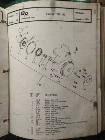

Wallfish 718 #6 Posted December 6, 2014 Ah Ha, now I see. That sounds like you have very interesting trips. Here's a diagram for the recoil parts. Share this post Link to post Share on other sites
