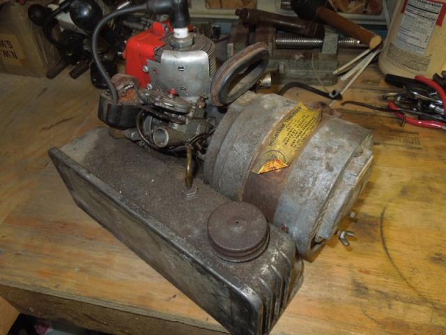

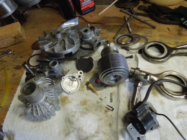

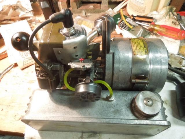

Wallfish 718 #1 Posted November 24, 2014 Had thiis TT 350 around for a while and decided it was time to clean her up. Took some pics through the process to show a tutorial on how to take the components apart, what to look for and how I repaired it. Same process for the 300 model which seems to be a more common unit compared to the 350 Share this post Link to post Share on other sites

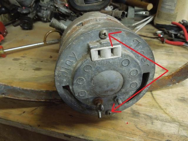

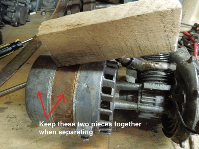

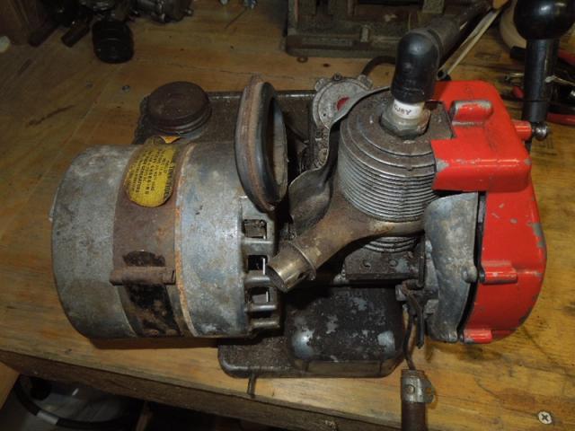

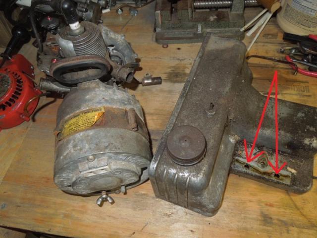

Wallfish 718 #2 Posted November 24, 2014 2 screws on the bottom are taken out to remove the generator and engine from the tank. To separate the generator from the engine remove the 2 screws which hold the generator parts together. First remove the band if there is one which just clips on and off. You can see the band in the first pic. Be careful when separating the components. The winding section (middle) and the outer section with the AC plug need to be removed together since they are wired together. I used a piece of wood that was near by to tap the sections loose. Share this post Link to post Share on other sites

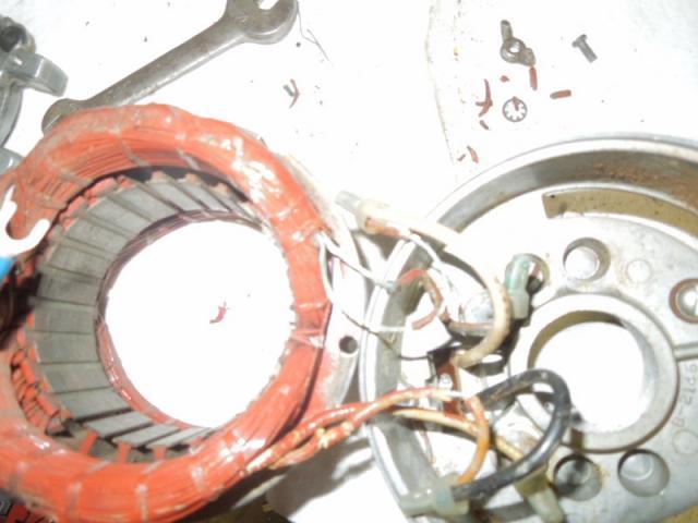

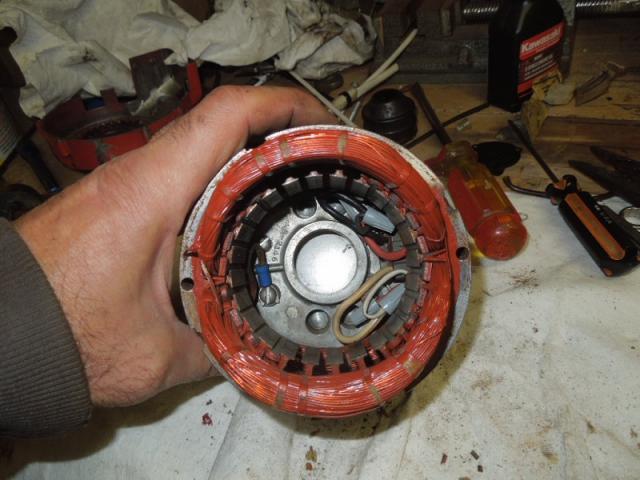

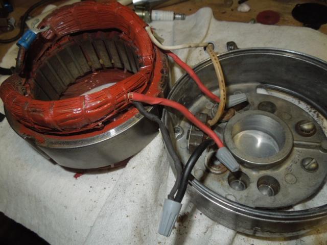

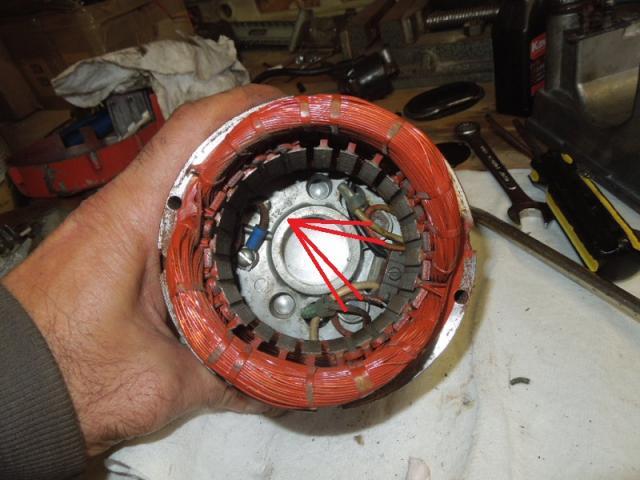

Wallfish 718 #3 Posted November 24, 2014 After separating the parts, I noticed that the wire insulation was dried, cracked and parts missing. This will get even worse if the components are pulled apart but they can be fixed. Here is a better view of the cracked insulation Using heat shrink tube, the wires were repaired and connected back together using small grey wire nuts All back together and wires tucked down and out of the way Share this post Link to post Share on other sites

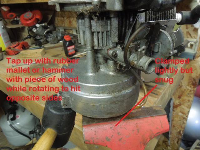

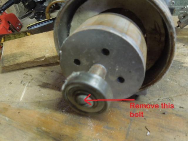

Wallfish 718 #4 Posted November 24, 2014 Now the magnet core which spins inside the windings needs to be separated from the engine. First remove the bolt holding them together I clamped the core lightly in a vice and taped the edge of the generator cover with a RUBBER mallet while holding the engine and spinning it from side to side to hit opposite sides until it came loose. Core separated from engine Share this post Link to post Share on other sites

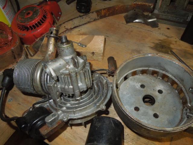

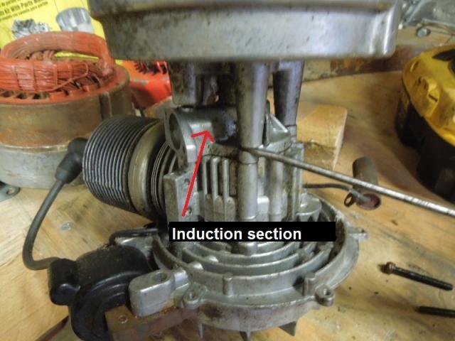

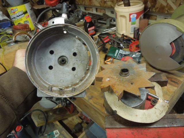

Wallfish 718 #5 Posted November 25, 2014 Now the last cover for the generator can be removed from the engine. Remove the 4 screws holding the cover to the engine. Be careful after removing those screws! The induction section of the engine is also held on by these screws and can easily separate from the engine. There are roller bearings inside that can easily fall all over when that section of the engine is removed. Not usually a problem if you're ready for them but a real pain searching for them when they fly out and you're not ready. I used a small screwdriver to separate the pieces without removing the induction section from the engine. Share this post Link to post Share on other sites

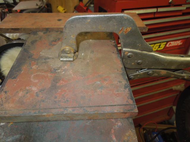

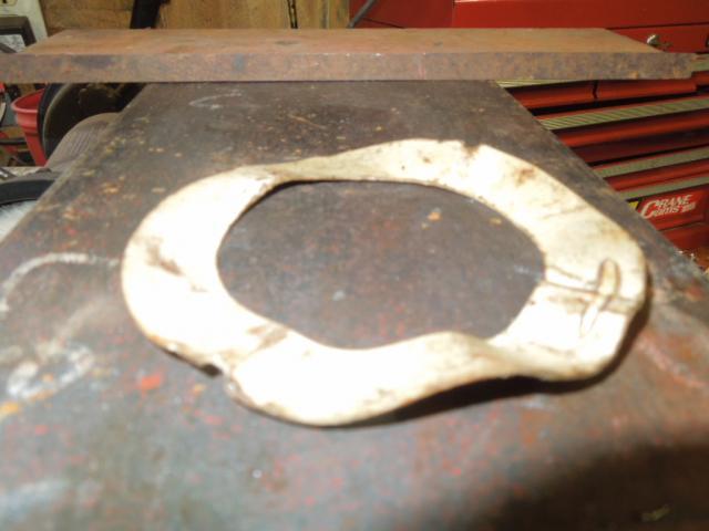

Wallfish 718 #7 Posted November 29, 2014 The cardboard insulator piece was warped from moisture and originally rubbed the fan. I soaked it in water until somewhat soft and then clamped it between 2 pieces of flat steel to dry. Heated it with a torch to speed up the drying process and it came out flat as a pancake like it should be. Share this post Link to post Share on other sites
