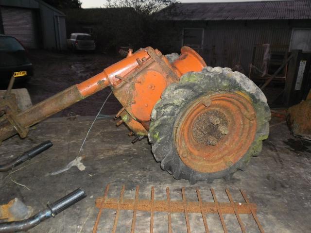

As a lot of you have seen on the other forum last year I aqquired a howard 800 which was a prototype replacement for the howard gem. However due to costs the machine never went into production. This will be a very slow project as it is in a shocking state and as most parts are unique it means everything has to be reconstructed. Possibly as few as 20 machines were built, and its likely only single figures still exist! It is also said that due to continual development work no two machines are the same.

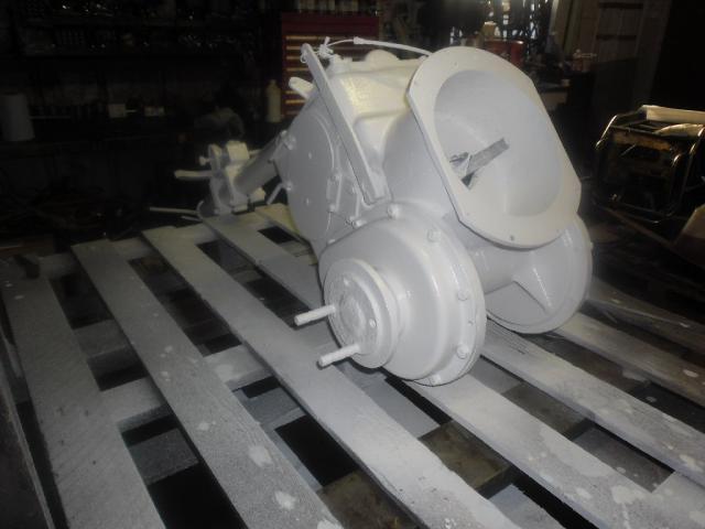

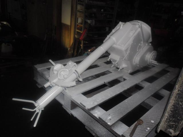

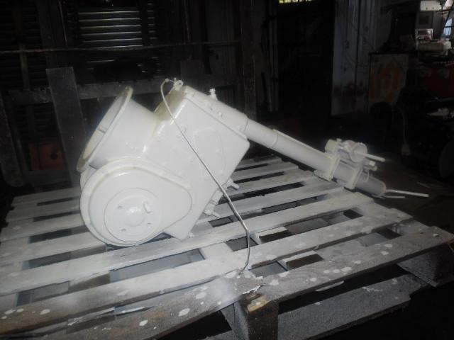

One of the first jobs after checking the condition of the gears was to rub down and spray the gearbox with some high build primer.

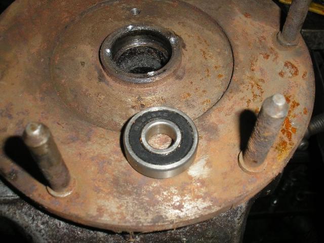

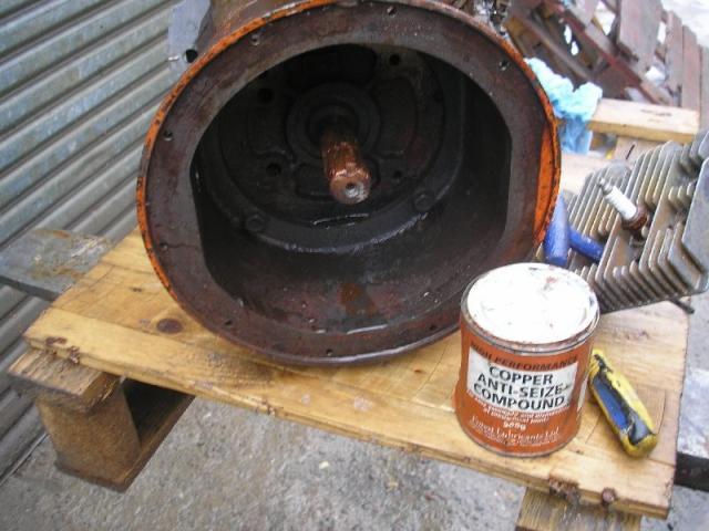

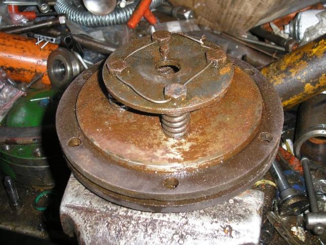

As can be seen the clutch was fit for scrap so I have rebuilt it, this machine has a twin plate set up, so in turn this means that the kohler crank extension with the longer lugs has to used. I dug through my spare and found one the correct spec. For good measure I also fitted a new centre berring. The nearest bell housing that I could find came off a standard gem, one of the mounting holes will need adapting to fit properly.

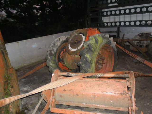

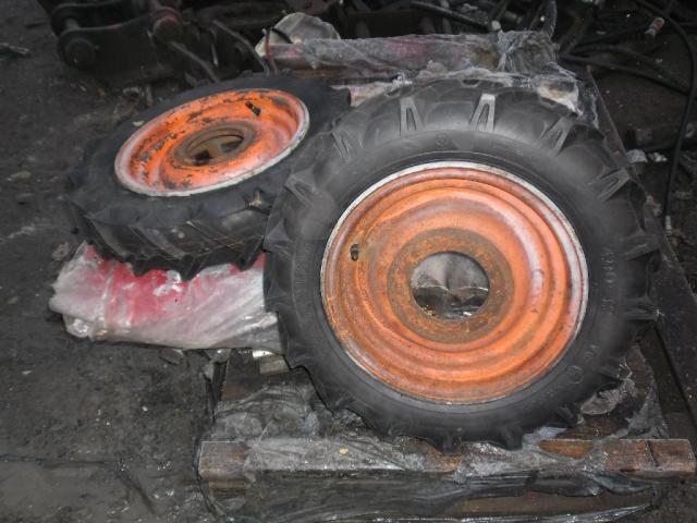

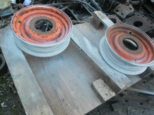

It seems that many different wheel options were tried on the 800. Mine came with wheels similar in design to the standard gem. Allthough there was plenty of tread left on the existing tyres, through standing for so long they were very badly perished so a new set of Vedestrain and tubes were fitted.

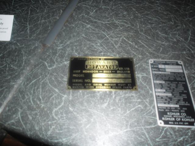

I allways think its the little details that make a restoration project so commished the reproduction of these Id plates. Not cheap at £45 each but I think it's money well spent.

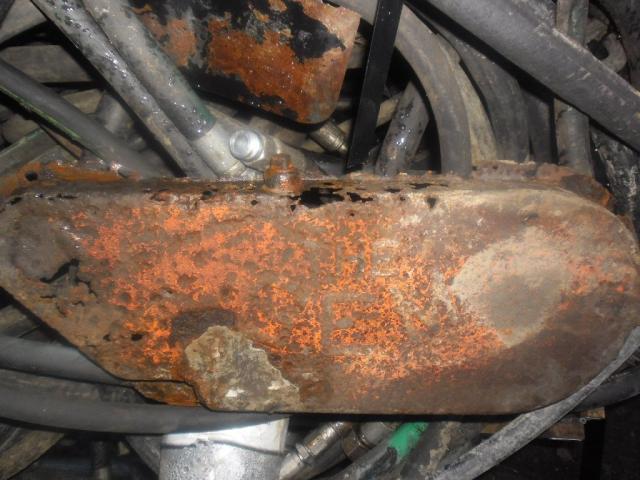

The chain case fitted to this machine was obviously a later replacement off a gem, originals it should of been plain, as you can see this one was just a bit beyond repair.

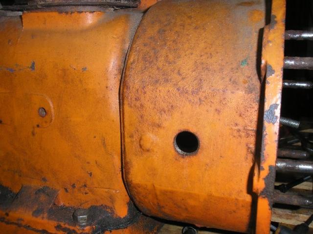

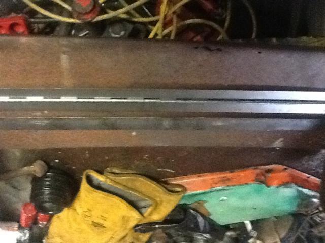

I have ground the gem name off and rewelded a replacement cover up as new ones are no longer avaliable. Not the best photo but can just be seen at the top with a skim of filler to finish off.
Whilst the welder was out I plugged all the holes in the tool box, here it is again with a Skim of filler.
