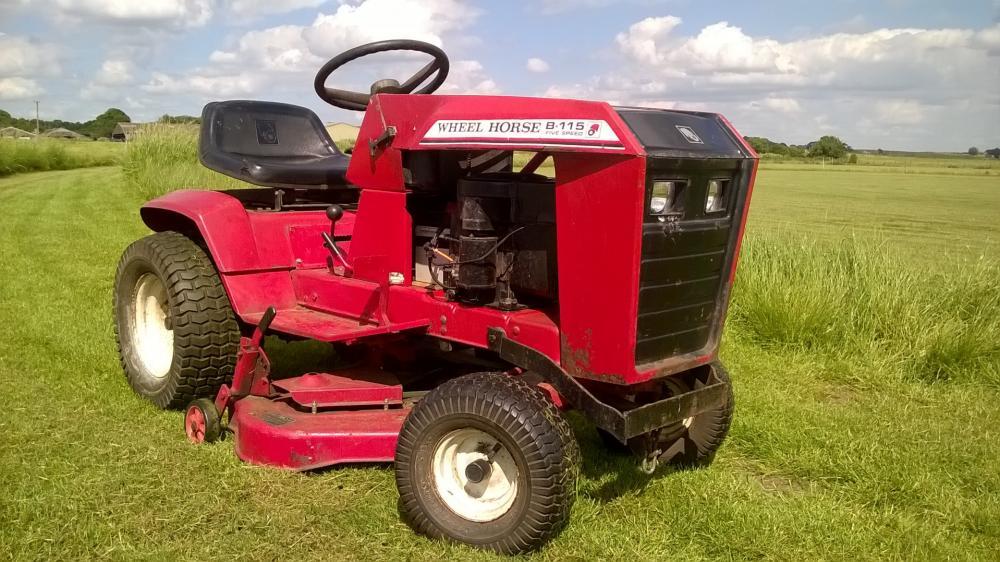

grumps 2 #1 Posted March 15, 2017 Hi everyone. Not been on here for a while. Just getting the mower ready for the the grass cutting season so I thought I would tidy up the wiring behind the dashboard. I`ve downloaded the wiring diagram and sorted out everything bar the A C supply to the headlights, I cant work out the reason for A C for the headlights, must they be connected or can the wire be left doing nothing? Any help would be much appreciated Colin (Grumps) 1 Triumph66 reacted to this Share this post Link to post Share on other sites

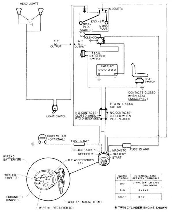

meadowfield 1,901 #4 Posted March 20, 2017 I would say no, there should be two circuits if I recall One is DC with an inline rectifier (look for a lump in the wire) the other circuit is AC. You cannot connect this straight to the battery - it will burn out the coil. Here is the wiring diagram... Share this post Link to post Share on other sites
grumps 2 #5 Posted March 28, 2017 Hi Meadowfield, Will it be O K to leave the A C wire not connected to anything? Regards Colin. P S Thanks for the wiring diagram. Share this post Link to post Share on other sites
meadowfield 1,901 #6 Posted March 29, 2017 yes leaving the AC wires not connected is wire - just tape the end so it cannot short to metal Share this post Link to post Share on other sites
