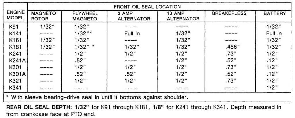

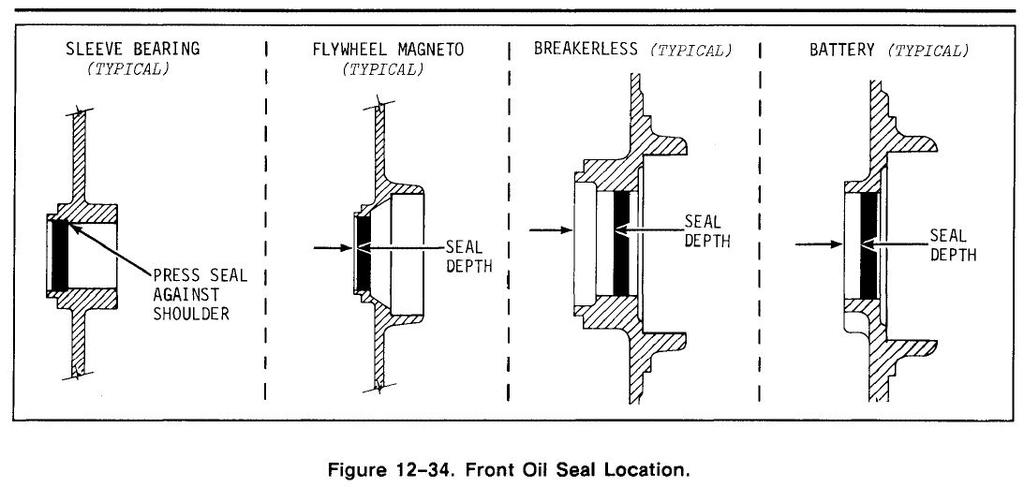

Rayp 48 #1 Posted August 15, 2017 I am replacing the oil seal on the Flywheel side of my Tractor engine but do no know how far in the oil seal should be. The old seal was very near to the bearing but it may be that the last person to replace a seal pushed it in too far. At the moment the new seal is flush with the Back plate, but I thought I would ask for the experts' opinion as to whether it should be farther in or not. Share this post Link to post Share on other sites
Anglo Traction 1,016 #2 Posted August 15, 2017 Hello Ray, Flywheel end is stated as the Front, choose your Engine and Type from the images below- 1 Rayp reacted to this Share this post Link to post Share on other sites
Rayp 48 #3 Posted August 15, 2017 Hello Richard, Thanks for the information which is very informative as usual. I see the depth for mine is 1/2". Share this post Link to post Share on other sites
