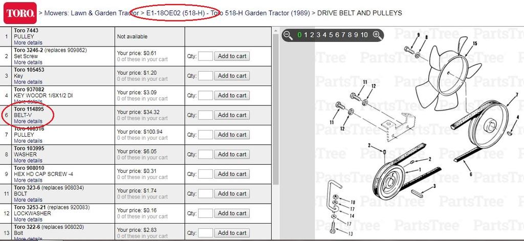

Thanks for your comprehensive reply , I have forwarded it directly to my friend. In the meanwhile he has been back through some old emails and come up with 114567. Now according to any info I can find that is a 48" long belt - hardly long enough to be a primary deck drive. I'm guessing that it may be a hydro drive belt .

Close with the Hydro Drive Belt. The number for that is 114895-
If he needs one of those, then if it was mine, I would look to get an OEM Belt, irrespective of cost.
114895 is type HB (in U.S. Toro list) which is Agricultural grade. 82.95 Inches length. 21/32" x 13/32". Metric equivalent/alternatives have minor dimension differences.
