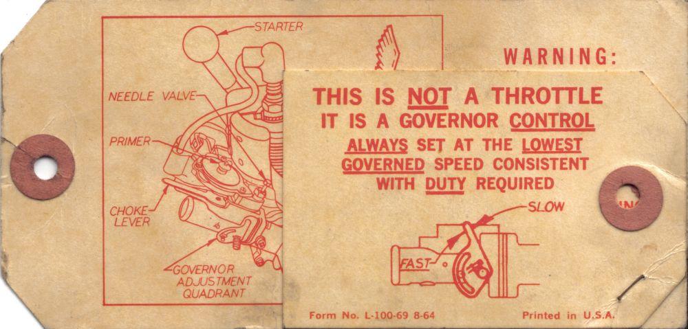

CNew 408 #1 Posted February 10, 2019 This may be obvious but I wanted to double check my understanding of the governor adjustment on the O&R engine. Which position on the little lever mounted on the side of the carburetor that sets spring tension is considered the lowest setting? Share this post Link to post Share on other sites
factory 487 #2 Posted February 10, 2019 I think this may help. David Share this post Link to post Share on other sites
CNew 408 #3 Posted February 10, 2019 Indeed, that’s perfect. I knew I had seen some sort of description like that somewhere but I just couldn’t recall where, and this was it! I looked in all my info and just wasn’t coming up with anything. Thank you David! Clint Share this post Link to post Share on other sites
