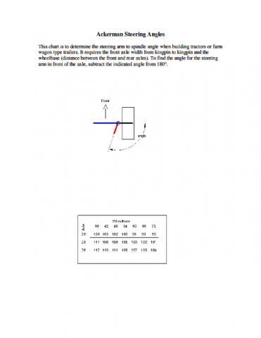

Wallfish 717 #1 Posted July 1, 2013 Use this chart to determine the arm angles for building small vehicles. The correct angle of the arms will certainly help the vehicle steer correctly. 1 Anglo Traction reacted to this Share this post Link to post Share on other sites
nylyon 171 #2 Posted July 3, 2013 Huh, I never thought of that, glad you posted it! Share this post Link to post Share on other sites
Wallfish 717 #3 Posted July 4, 2013 I stretched an Ariens GT 2 ft and put an electric actuator tilt bed on it. Steering was just not right. Then I found this chart and changing those angles on the arms made a big difference. Share this post Link to post Share on other sites

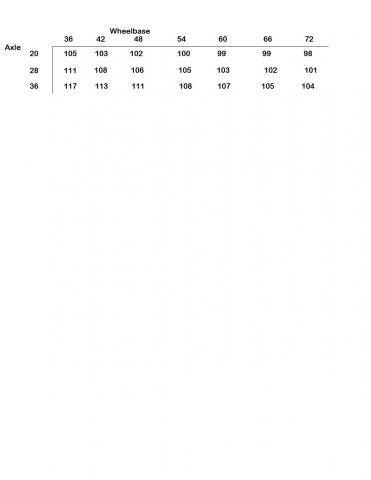

posifour11 2 #4 Posted July 5, 2013 Is there a clearer copy of that? I read the words but the chart if blurry for me. Share this post Link to post Share on other sites
Wallfish 717 #5 Posted July 5, 2013 Click on this one to expand it Share this post Link to post Share on other sites
