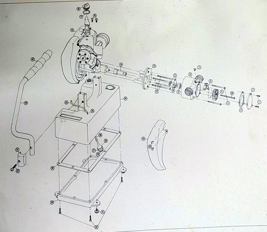

factory 487 #3 Posted October 21, 2021 I don't think I've added any Comet manuals to the sticky thread, but the engine diagrams are there. These pictures from the Comet manual are not mine, they were uploaded by @neons a few years ago. Hope they help, I do have some Comet literature, but not that manual AFAIK. On 10/16/2021 at 11:26 PM, Wallfish said: It's been a bit slow on the forum recently. It's been a while since I've been on here, been quite busy since going back to work, also been helping my Dad sort & clear my Grandparents house, they both passed away earlier this year in care. I've also had to rebuild my computer as the motherboard failed, new machine is much better & quicker, but just not got everything back on it, the Office disc has vanished, I was using that to create the pdf's. David Share this post Link to post Share on other sites
