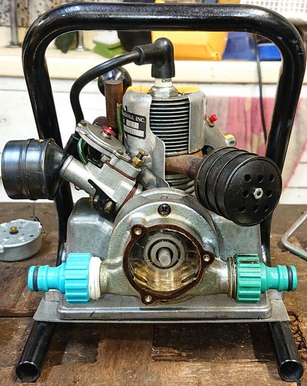

BIGJOHNG2 1 #1 Posted October 28, 2021 Well, I got my my Comet transfer pump running, but without the pump as I am awaiting delivery of a new Impeller. I think that my O&R may be an older unit( '61or "62) and may be missing some parts on the carb and linkage to the vane governor . My question is can I put a newer carb on my motor and will it lash up to the induction case assembly ok on my motor. I now have no control of the speed (rpm) without input from the governor vane. I really had to scramble to shut it down when it started to over speed! I would gladly accept any advice! Joh Graham Share this post Link to post Share on other sites

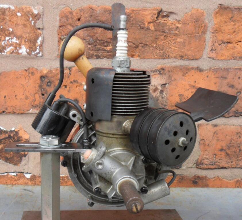

Wallfish 716 #2 Posted October 29, 2021 Yes, a newer type carb will bolt right on. Maybe post some pics of your carb and how you have the governor set up. Carb should have a spring on the bottom of the butterfly shaft. The governor vein flag should be tight on the shaft. That shaft of the governor vein goes directly into the top of the butterfly shaft on the top of the carb. Share this post Link to post Share on other sites

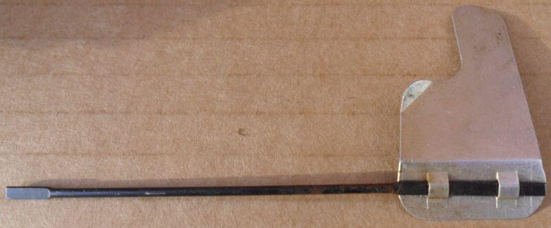

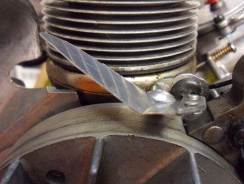

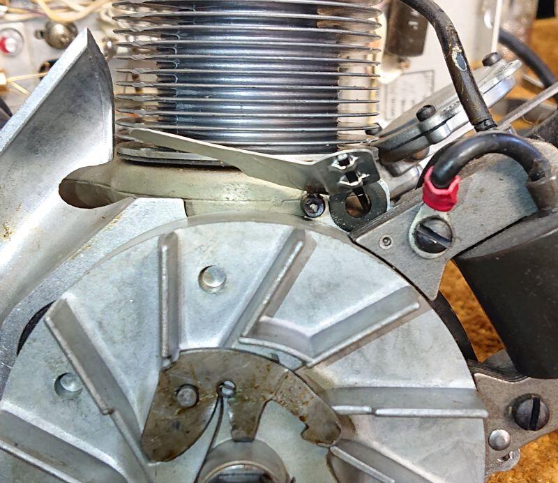

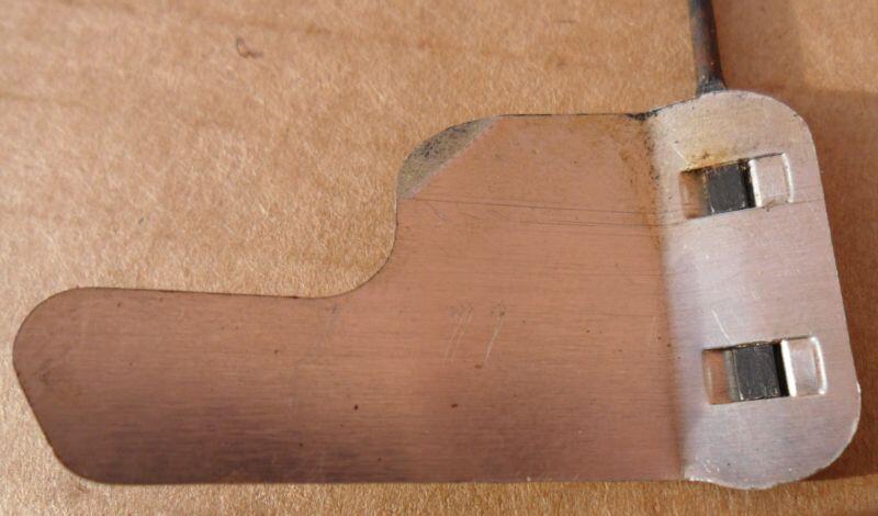

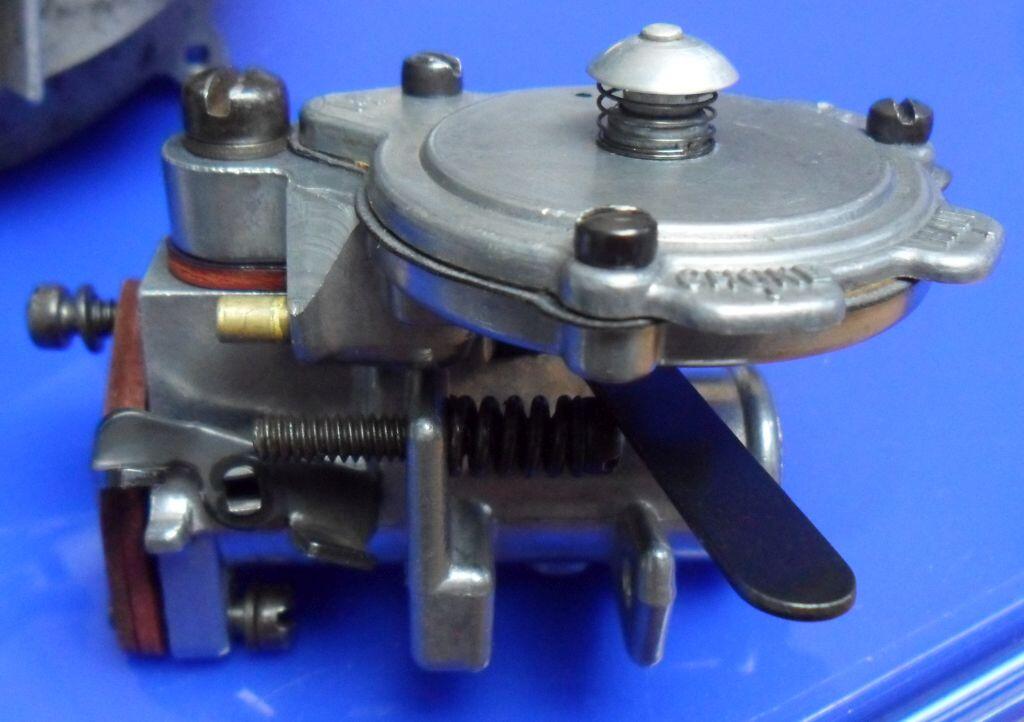

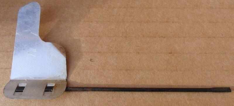

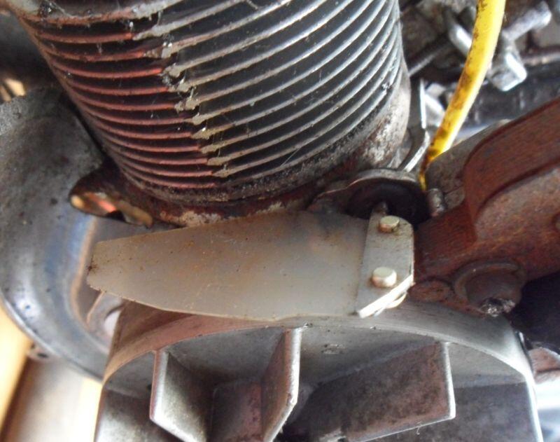

factory 487 #3 Posted October 30, 2021 The governor vane should look something like these (design & materials vary depending on engine age), the vane is permanently attached to the vane shaft. The governor vane shaft fits into the carb butterfly valve as shown. It's a loose fit and if the vane has been bent or damaged it can rattle out when running, this also results in over-speeding, my first O&R did exactly this. David Share this post Link to post Share on other sites

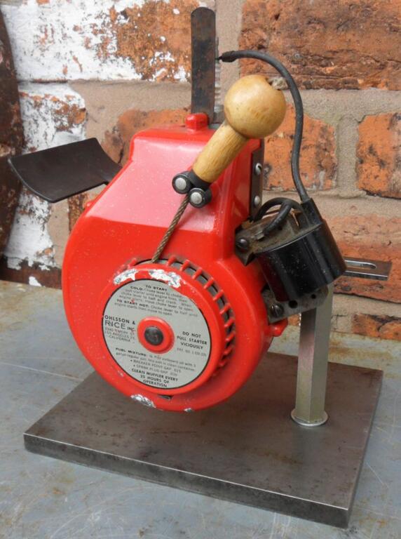

factory 487 #4 Posted October 30, 2021 Please either post some pictures of the engine or tell us the serial number and I can add some pictures of the most appropriate governor vane for your engine, as you mentioned you wanted to make one in the other thread. Also I'm not sure why you would want to change the carb if it's running. David Share this post Link to post Share on other sites

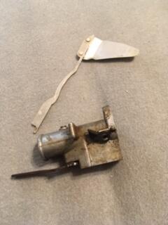

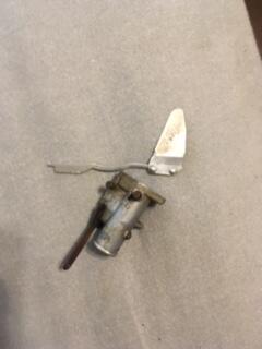

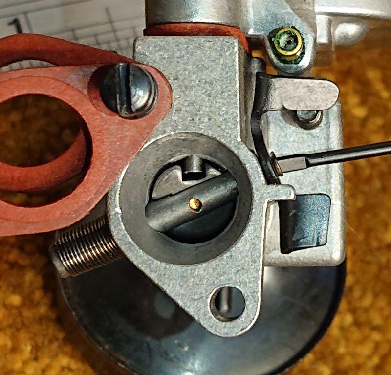

BIGJOHNG2 1 #5 Posted November 4, 2021 I did find the vane and a small broken spring from the starter dog assembly. The vane was bent.and the shaft from the vane to the carb was missing. The reason I was asking about carb inter-changeability is that the slot on the end of the throttle shaft... one piece has broken away. I'm not sure sure the connection from the vane assembly to the carbs throttle would remain in place and I may need to swap out cabs. I could take pictures but I am afraid they would show little. I will show a picture of the vane. The s/n of the engine is 016395 Type 169. I'll try for some pics tomorrow. John Share this post Link to post Share on other sites

BIGJOHNG2 1 #8 Posted November 5, 2021 I am looking for a flexible vane impeller . The size is 2 inch diameter x 1/2 inch wide x 5/16 inch D hole. I have searched high and wide, but no luck. The 1/2 inch wide is the problem. The narrowest I can find is 7/8 inch. I am considering trimming the 7/8 inch to size. Any suggestions? Back to the governor vane.... is the shaft just wire that has been ground flat on the end? Would you take a guess at the diameter? Thanks for the help!!! John Share this post Link to post Share on other sites
Wallfish 716 #9 Posted November 5, 2021 9 hours ago, BIGJOHNG2 said: Any suggestions? Trim it. Belt sander maybe? I'll find a vein and get some pics with measurements if you want to try and make one Share this post Link to post Share on other sites
BIGJOHNG2 1 #10 Posted November 5, 2021 Thanks... I would like that. I would think that the vane should not be too hard to make, John Share this post Link to post Share on other sites

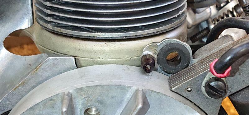

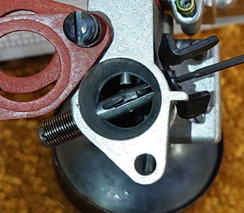

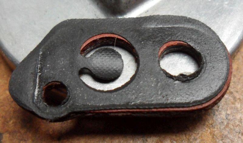

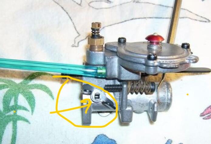

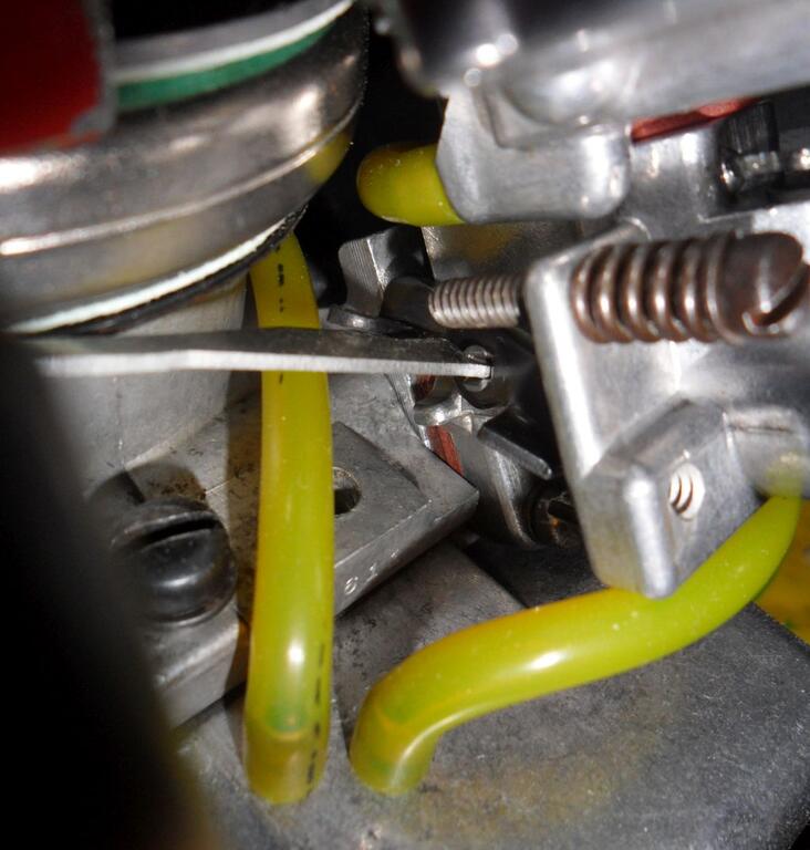

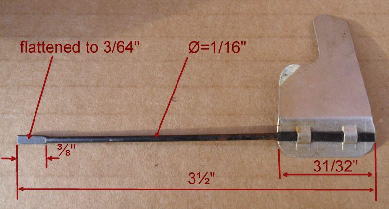

BIGJOHNG2 1 #13 Posted November 8, 2021 David, I just checked my engine type and it is a TYPE 109 s/n 016395.My mistake! The attached picture also shows a part of the carb not listed in the parts breakdown that I can find. Is this lever/stop available? I did replace the check valve with the mylar type. In regards to the picture of the governor vane would you "guestimate" the length of the shaft? It looks to be about 1/8" in diameter. Again thanks you for the help John Share this post Link to post Share on other sites
factory 487 #14 Posted November 8, 2021 I'll try & find that type of governor vane to measure and have a look at engine s/n 015990 I have. The bottom half of the carb was only offered as a complete assembly, the lever isn't intended to be removable. It's possible one could be obtained from a carb with a damaged casting and reattached with careful soldering/brazing (to avoid melting the casting), but there isn't much left to attach to in your pictures. David Share this post Link to post Share on other sites

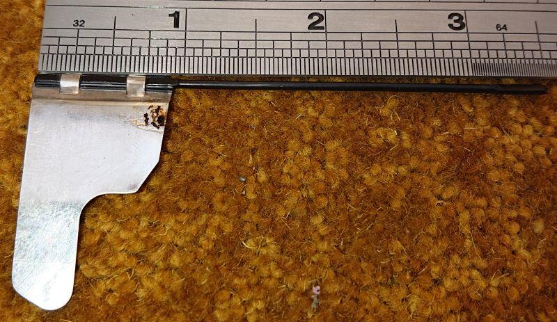

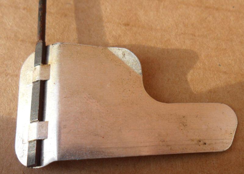

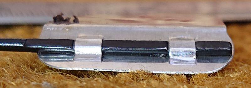

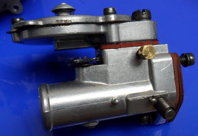

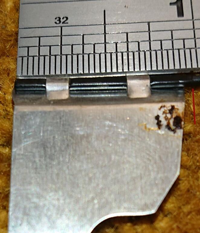

factory 487 #15 Posted November 8, 2021 Here are some sizes for the governor vane. It might not be obvious from the picture, but is it notched to hold the flag section in place. I will check the one from s/n 015990 on Wednesday afternoon, as I suspect the 31/32" might be approx 1". You might want some pictures showing the shape of the butterfly valve "stop lever" piece, from the carb too. David Share this post Link to post Share on other sites

factory 487 #17 Posted November 10, 2021 John, in case you didn't know, that carb body is from one of the first 6000 engines and has no provision for the idle stop screw adjustment. David Share this post Link to post Share on other sites

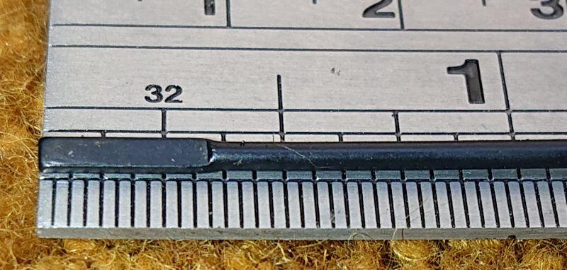

factory 487 #18 Posted November 10, 2021 I've checked a second governor vane today, from s/n 015990, the length of the vane shaft is the same at 3½". The flat at the vane end is the same at 31/32", note the pressed notches that line up with & hold the vane flag in position, I guess these might not be necessary with modern glue. The other flattened end differs slightly in length, the one I measured the other day was 3/8", this one is 1/32" shorter, this doesn't make any difference as neither go all the way into the carb butterfly valve. A couple more pictures, one showing the vane in place and the second the sleeved pin it rests against. And finally a couple of pictures to show the shape of the butterfly valve lever, that the governor vane fits into. David Share this post Link to post Share on other sites

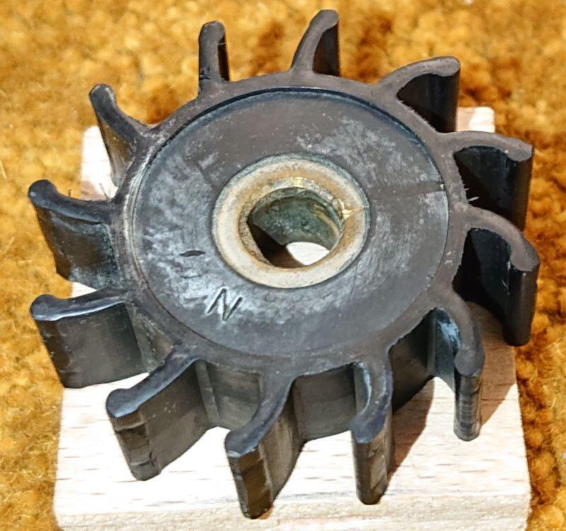

BIGJOHNG2 1 #20 Posted November 12, 2021 Great pictures and information. Pictures are indeed worth a 1000 words! Dave, what kind of camera are you using? Pictures are very sharp.Lighting is excellent .Wallfish...I would be interested in the carb casting but not the governor flag as I can make that. Should I pm you to work out the details? In regards to trimming down an impeller for the pump... I tried grinding an impeller with a belt sander , but it did not work well. A bit of research suggested using a hot nichrome wire. Another person froze the rubber with LN2 and had good results. I don't have access to LN2 any more ,but I may try CO2 and acetone. Sure would be easier just to find a p/n that would work! Got a new toy from epay today , But will start a new topic on that one. Thanks again for all the help. You guys are really generous with your time!!! John Share this post Link to post Share on other sites
factory 487 #21 Posted November 12, 2021 19 hours ago, BIGJOHNG2 said: Pictures are indeed worth a 1000 words! Dave, what kind of camera are you using? Pictures are very sharp.Lighting is excellent . My older pictures were from a old compact digital camera, I still use it occasionally, but mostly use my Sony phone these days, it takes quite good pictures when I manage to hold it steady . There is a window in the roof that gets good light during the day, but lighting can be very tricky in the evening, need to get round to adding some more lights above the workbench, I even have some I fluro units I salvaged from a relatives garage ready (I can't stand LED lighting, they only seem to be made in way too bright). David Share this post Link to post Share on other sites
Wallfish 716 #22 Posted November 12, 2021 22 hours ago, BIGJOHNG2 said: In regards to trimming down an impeller for the pump... I tried grinding an impeller with a belt sander , but it did not work well. A bit of research suggested using a hot nichrome wire. Another person froze the rubber with LN2 and had good results. I don't have access to LN2 any more ,but I may try CO2 and acetone. Sure would be easier just to find a p/n that would work! What about searching small outboard water pump impellers? 1 factory reacted to this Share this post Link to post Share on other sites

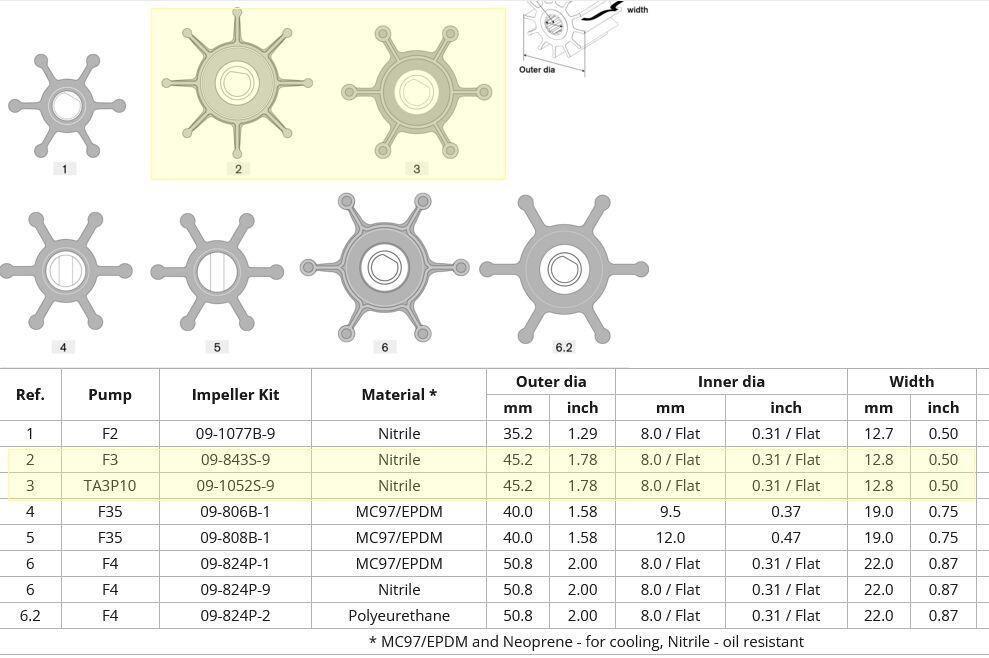

factory 487 #23 Posted November 13, 2021 I'm going to need to recheck an old one, but have possibly found something that may work, a Johnson impeller part no. F3B-19, they aren't cheap enough to buy without double checking sizes, but websites state they are ½" (12.8mm) wide, 1.78" (45.2mm) overall diameter and shaft size is 0.31" (8mm) with flat D shape. Edit: Already seeing inaccuracies from those metric conversions provided by a UK website. David Share this post Link to post Share on other sites
factory 487 #24 Posted November 13, 2021 Well I can't blame the sellers, as the manufacturer SPX (makes the Johnson pump brand) gives the same measurements. https://www.spxflow.com/johnson-pump-marine/products/original-impeller-kits/ The two highlighted impellers are the same measurements as one I just removed from an Orline version of the pump, the difference is the number of lobes. The info on the SPX website suggest the impellers have a short life (as most products made from rubber do) and should be removed from the pump if not in use. There might be pattern parts the same, quality may vary though. David Share this post Link to post Share on other sites
factory 487 #25 Posted November 13, 2021 I've ordered two of the 09-843S-9 impeller kits from an Italian marine supplier, seems no one in the UK does the 8 vane version, will report back if/when they arrive. David 1 Wallfish reacted to this Share this post Link to post Share on other sites
