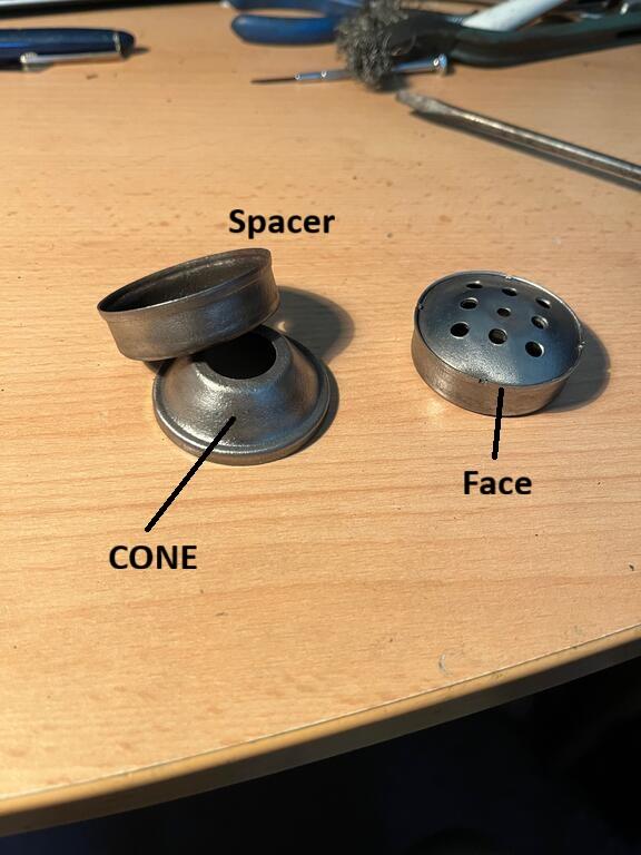

Wallfish 718 #26 Posted October 10, 2025 15 hours ago, tvenetis said: Thanks and when you put the ohlsson mufflers you put the spacers that have smaller holes between each muffler? Some of the spacers I have have a hole in the middle also There's one cap that has the face with the little holes and the rest are the spacers with bent tab holes at the bottom. You can stack as many as you want but you'll need to make a threaded rod piece for whatever length you stack them to retain it. You can typically find longer screws at the hardware store and just bend the end like the one that;s on there now. Pretty sure the thread size is #6 1 tvenetis reacted to this Share this post Link to post Share on other sites
tvenetis 1 #27 Posted October 10, 2025 So you put spacers with hole in middle then 1 muffler then the spacer with small holes in it? Share this post Link to post Share on other sites
Wallfish 718 #28 Posted October 11, 2025 Stack spacers Cone piece on the exhaust collector, spacer, spacer spacer spacer spacer (How ever many you want) then the face piece. Share this post Link to post Share on other sites
tvenetis 1 #29 Posted October 11, 2025 Thanks I am blind can't see pictures so I gather when you say spcer you are talking the round pieces that have the hole in the middle then the last one is the piece that has small holes then you put the muffler? Share this post Link to post Share on other sites
Wallfish 718 #30 Posted October 11, 2025 3 hours ago, tvenetis said: Thanks I am blind can't see pictures so I gather when you say spcer you are talking the round pieces that have the hole in the middle then the last one is the piece that has small holes then you put the muffler? Sorry, I did post a pic of the pieces. You should have a 3 piece muffler now so the piece in the center is the spacer and they can be stacked as many as you want 1 tvenetis reacted to this Share this post Link to post Share on other sites
tvenetis 1 #31 Posted October 11, 2025 Thanks I did that and put the piece that has no large hole in the middle before the muffler and stacked the ones with has the center large hole behind it then the piece that goes on to the engine piece from the exhause behind the rest. Share this post Link to post Share on other sites
