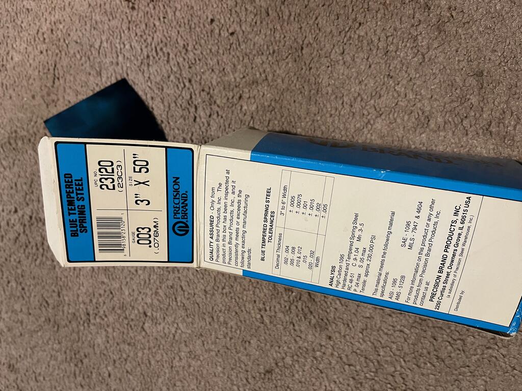

Wallfish 724 #7 Posted June 17 I have some blue tempered spring sheet metal .003" I can send you. I was making my own springs out of it and found that grinding the center out with a thin cut off wheel worked much better than trying to cut it out. Then cut the outside shape. Just don't grin hard to heat up the metal or it will loose it's spring properties. 50" x 3" can make A LOT of springs. Share this post Link to post Share on other sites

Bob V 13 #9 Posted June 20 Hi John, Well my feeler gauge experiment was a failure. The material probably has too much tension. It would not prime and would not run, so I assume it is putting too much pressure on the ball. If you can send me a piece of the material that you used, I would sure appreciate it. I don't know if you are a fan of Bring a Trailer, but I visit the site occasionally to look at all the vintage cars, motorcycles, mini bikes and go kart of yesteryear. I saw this micro-power micro-bike. Is this the same type that you have or had? I posted a link below. https://bringatrailer.com/listing/micro-power-micro-bike/ Thanks, Bob Share this post Link to post Share on other sites
Wallfish 724 #10 Posted June 21 On 6/20/2026 at 2:22 PM, Bob V said: Well my feeler gauge experiment was a failure. The material probably has too much tension. It would not prime and would not run, so I assume it is putting too much pressure on the ball. If you can send me a piece of the material that you used, I would sure appreciate it. I don't know if you are a fan of Bring a Trailer, but I visit the site occasionally to look at all the vintage cars, motorcycles, mini bikes and go kart of yesteryear. I saw this micro-power micro-bike. Is this the same type that you have or had? I posted a link below. I'll get a piece out to you Yes that's the same but mine is a repop that I built a few years ago. $1500 + is too steep for little collectables. Here's a link of the thread. Share this post Link to post Share on other sites
Bob V 13 #12 Posted Saturday at 11:29 AM The piece of spring steel arrived yesterday. I will let you know how I make out with it. Thank You..!! 1 Wallfish reacted to this Share this post Link to post Share on other sites
