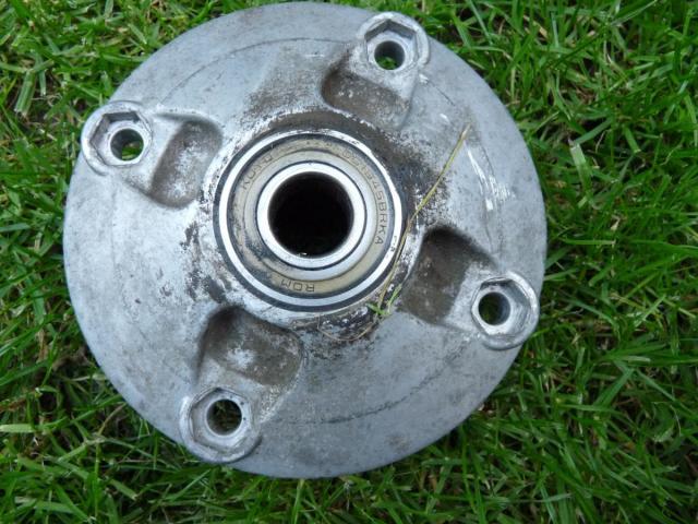

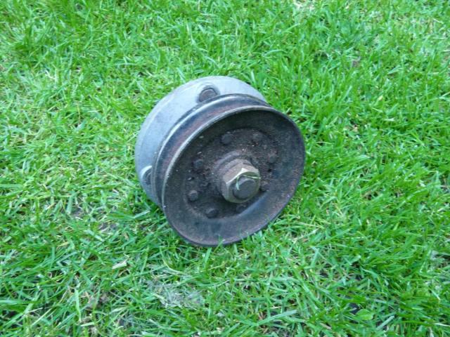

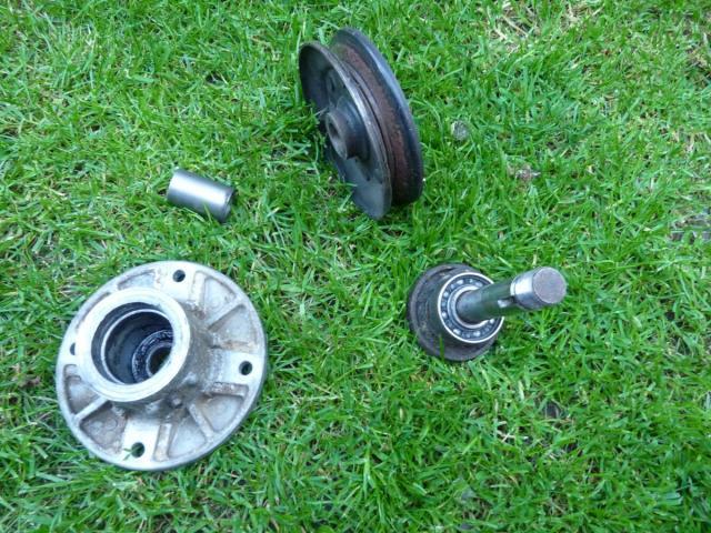

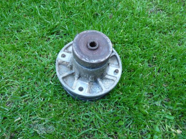

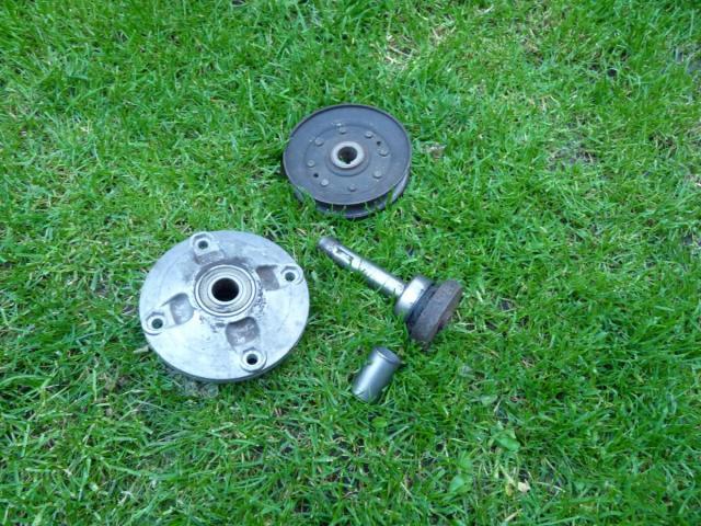

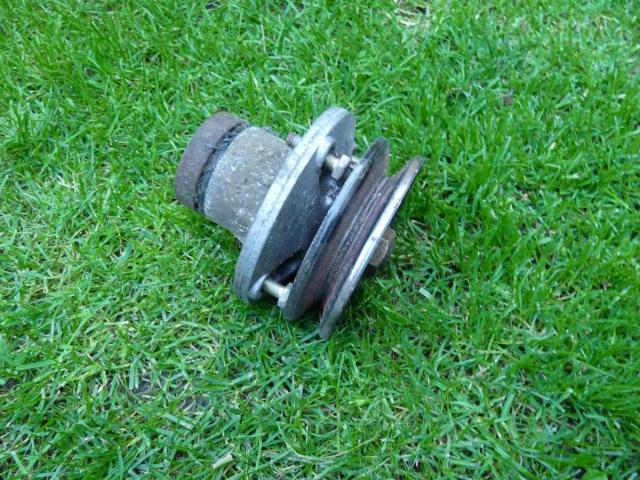

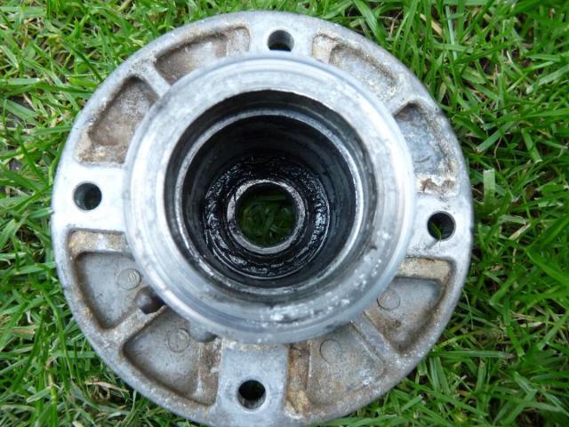

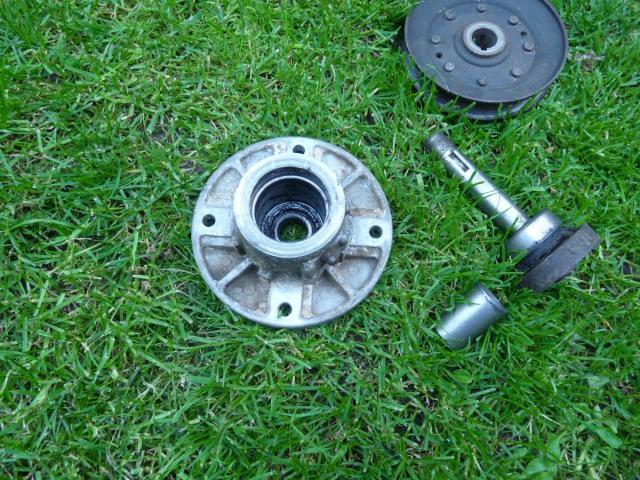

ranger 373 #26 Posted June 8, 2014 I`ve just taken a spindle apart, only takes a few min`s.One bearing comes out with the spindle, the other stays in the housing. Photos of the parts, the spacer goes in before you press/bash in the second bearing. Doug. Share this post Link to post Share on other sites
