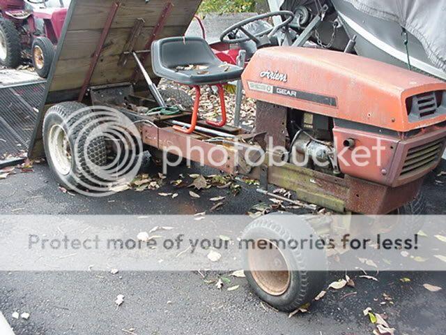

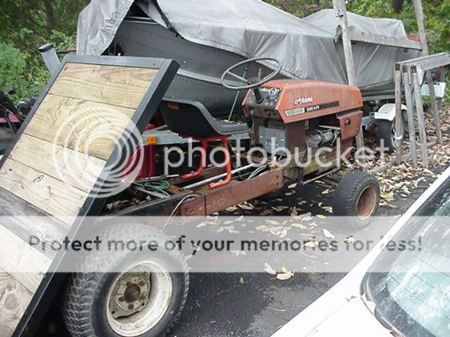

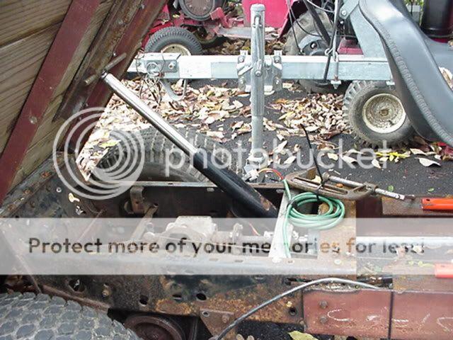

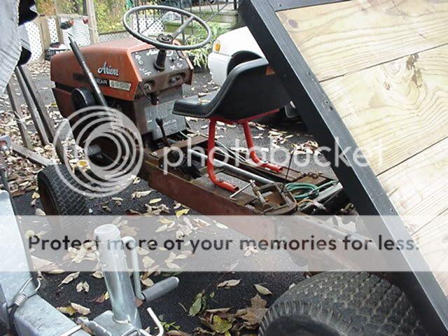

Wallfish 718 #1 Posted November 24, 2013 This was built and sold a while ago but just came across these build pics. For some reason, I have no pics of it finished. The frame, drive shaft, and shifter were stretched 2ft. It used an electric actuator to tilt the bed. I tested the tilting power by adding weight to the front edge and went up to 300 lbs and it handled that no problem. The steering was horrible until changing the Akerman angles on the spindles to compensate for the wheel base. Even then, it still took a K turn to spin it around. Share this post Link to post Share on other sites

Wallfish 718 #3 Posted November 25, 2013 When finished, it had sides for the bed and I used it for hauling dirt and large rocks. Share this post Link to post Share on other sites

Wallfish 718 #6 Posted November 28, 2013 The actuators are rated for different power so they get more expensive as the power goes up. I bought this one used and it was obviously a strong one but I don't know what the rating was on it. Share this post Link to post Share on other sites
