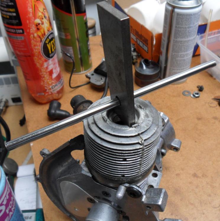

factory 487 #26 Posted April 6, 2017 On 4/6/2017 at 3:10 AM, Oldjimturbine said: I would like to know if there is any easy way to move the exhaust to install a fuel tank. The exhaust and cylinder head won't budge. Is there something I have to remove first? If the exhaust collector will not move, the cylinder will need to be unscrewed. But make sure the piston is free to move before trying this, as the con-rod will break if the piston is stuck. The engine maintenance manual gives details on making a cylinder removal tool. The instructions given are to make it from a piece of flat steel 3/16" thick & 1" square, with a hole drilled in the middle for using a screwdriver as a "T" handle. I made one from a piece of steel & bar found in a box of offcuts & salvaged bits in the shed. I didn't bother to make it 1" square though, I only squared up the ends and drilled the hole for the bar. If the cylinder is very tight I usually use a vice to hold the engine crankcase (use wood or similar to protect the engine from the vice jaws) and use an adjustable spanner to turn the tool. You will probably need to replace the gaskets if you remove the cylinder to prevent leaks. Also make sure that the slot in the top of the cylinder lines up with the crankshaft or is at 90 degrees to the crankshaft when reassembling. Here is a picture of the cylinder removal tool I made. David 3 Wallfish, Kevgall and Zak reacted to this Share this post Link to post Share on other sites

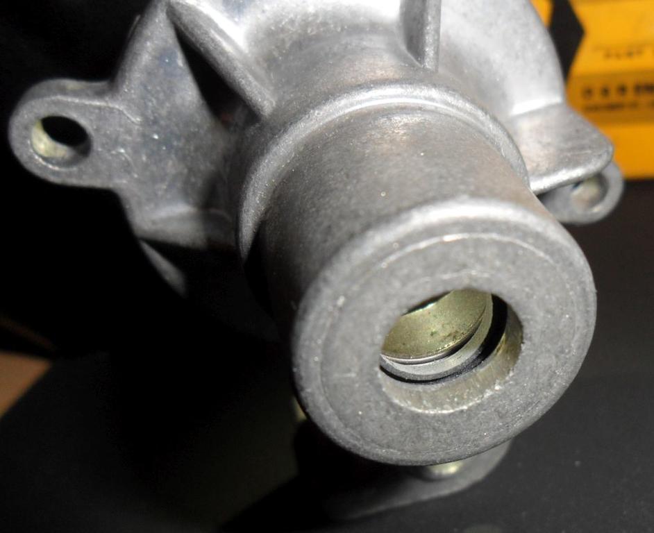

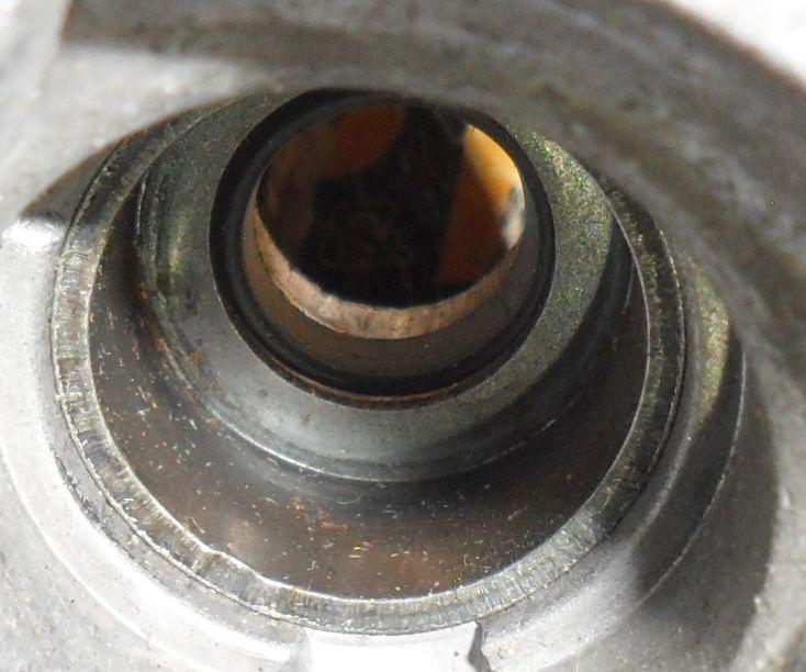

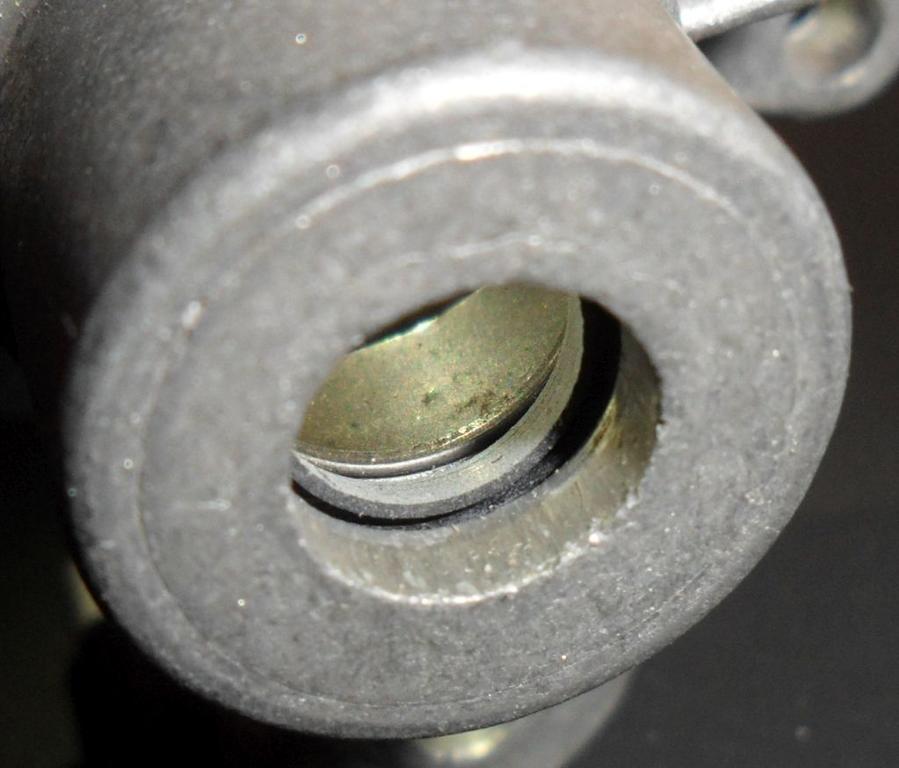

CNew 408 #27 Posted July 8, 2019 (edited) On 1/14/2015 at 1:14 AM, Wallfish said: [snip] Then decided to replace the crank seal in the induction part. Had to pick the old one out with a small dental pick tool I just worked on an engine that had the induction shaft seal installed with the grooved side of the seal facing out away from the engine. Was this incorrect? It looked to be the original seal. I’m also a little confused about if the induction side of the engine is pressurized or if it creates a vacuum and sucks air. I’ve read multiple instances where people report oil and grease from gear boxes being sucked into the engine when the induction shaft seal fails. If this is true it would seam to me that the induction housing and seal are maybe under sort of a vacuum. Am I misunderstanding how this is supposed to work? Has anyone else come across a seal with the grooved side facing away from the engine? Edited July 8, 2019 by factory Edited quoted post for relevant part. Share this post Link to post Share on other sites
factory 487 #28 Posted July 8, 2019 Looking at the service manual, it looks as if the open-end of the induction seal should face towards the "small end of the induction case" i.e away from the engine, as you've found it. The feather valve seal is fitted the opposite way around. I will check the one NOS induction casing I have, as the seal is pre-fitted. If any seals are bad they will leak whichever way round they are fitted. David Share this post Link to post Share on other sites

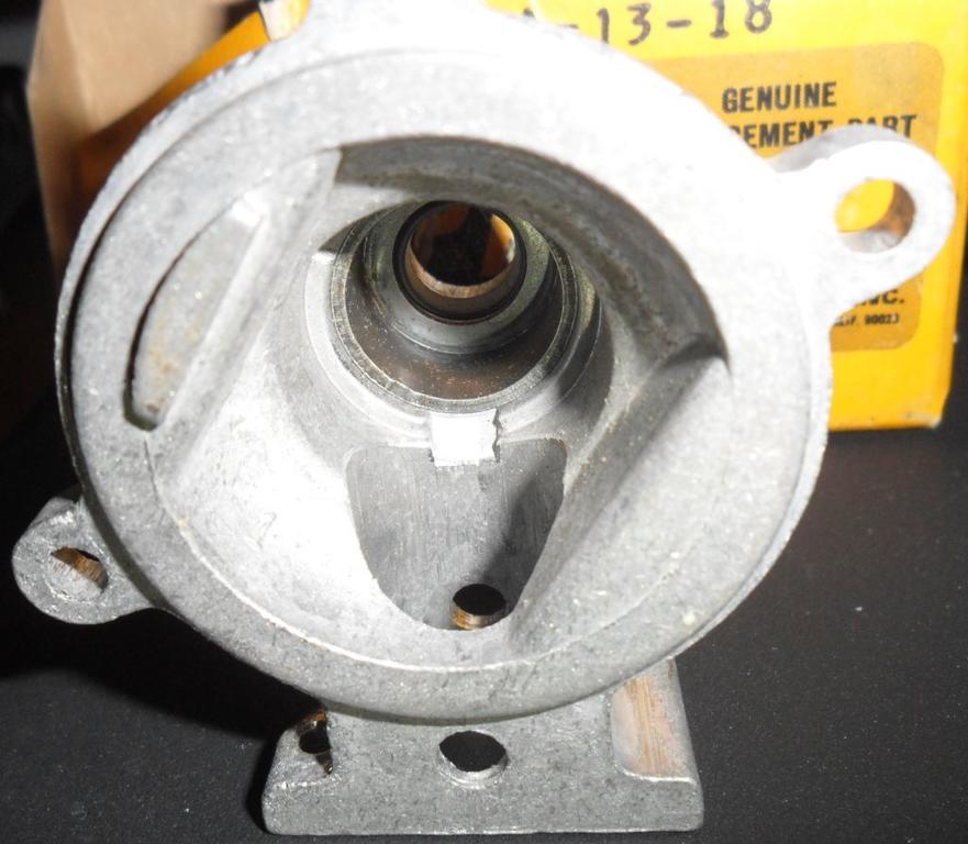

factory 487 #29 Posted July 8, 2019 Here are some pictures of the seal fitted to the NOS induction housing I have. David Share this post Link to post Share on other sites
CNew 408 #30 Posted July 8, 2019 (edited) Thank you David! That looks like the grooved side of the seal is facing out away from the engine. I just finished opening up the engine again and flipped the seal around. I’ll see if there is any noticeable difference in how it runs. Thanks again for all the help! Clint Edited July 9, 2019 by CNew Updated comment Share this post Link to post Share on other sites
