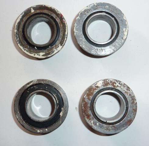

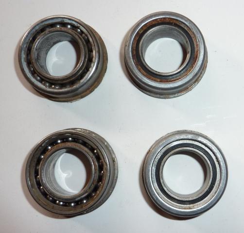

Rayp 48 #5 Posted July 31, 2015 Hello again Richard, Having removed the front wheel bearings and given them an initial soak in petrol I found that I either had 2 sealed bearings and 2 unsealed bearings (PLEASE SEE ATTACHED PHOTOS) or that the seals had disappeared from the 2 ‘unsealed’ bearings and I hope I have not damaged the sealed bearings by the petrol immersion. 3 of the bearings turn smoothly and quietly whereas the fourth turns not so smoothly with a slight grinding noise and I assume this bearing needs replacement. The ‘sealed’ bearings are marked as made in the USA and I assume that I will not be able to re-pack them. Yours advice would again be most appreciated. Kind regards Ray Share this post Link to post Share on other sites
Anglo Traction 1,016 #6 Posted July 31, 2015 Hello Ray, The standard bearings for the front wheels have only one Shield on the outside/Flanged side, so that the inside is greased via the nipple (Zerk). Replacement bearings can have double shields, but do not require greasing via the nipple for their life. You can carefully remove and dispose of the Inner Shield of the 'Double Shielded' bearings and clean out, re pack with grease if you wish. You can then grease later via the Nipple (Zerk). The bearings themselves are not best quality (i.e. precision ground) and are light/medium duty pressed/folded metal type. I purchased mine from the U.S. some time ago at a reasonable price. If you need to buy replacements/spares, have a good look around Auction Sites and Google search for best price/quality. The good ones for example are made by Heim in U.S., but I couldn't find them at the time. Part numbers are Toro 110513 or 251210. 3/4" bore x 1.3/8" flanged single outer (or double) Shield. I have a couple of (tired) used ones if you get real desperate. 1 Rayp reacted to this Share this post Link to post Share on other sites
meadowfield 1,900 #7 Posted July 31, 2015 As Richard says, they are far from precision! I would just give them a good clean and pack them with grease. We've had a lot more hours than I imagined from ours after cleaning... Even now they are a little rough, but functional! 1 Rayp reacted to this Share this post Link to post Share on other sites
