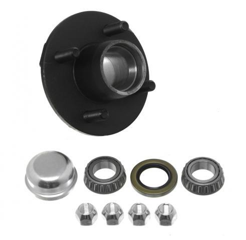

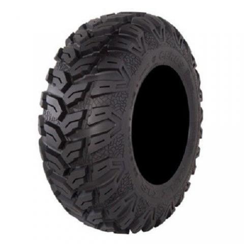

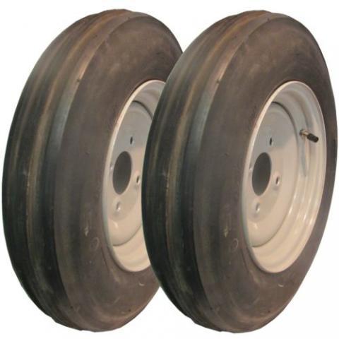

The Wheel Horse will get Maxxis 27"x9"-15 inch crossover tires on stock Wheel Horse 7"-15" rims for the rear 257.31 delivered to my door. The front upgrade is a little more extensive as I am opting for thrust washers (14.00) on the spindle tops and Dexter 4 bolt hubs (63.00 delivered) on the 4-1/4 spindles. These 4 bolt hubs take a standard I inch L44643 bearing with grease seal and cap, Instead of the usual 5.00-10 tri-ribs, I'll be using the 5.00-10 narrow cart tire (139.00 for 2 tires and wheels delivered), This set up will allow for good use on the grass as well as on more extreme surfaces/conditions, such as in the garden, in the mud, or in the snow.
