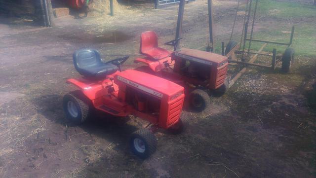

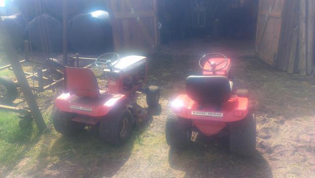

woz 44 #3 Posted April 17, 2016 hi, i went down country last night and bought another b111, funnily enough with the same gearbox troubles as my other wh...so iv had the day messing about and its now a five speed with sequential gears, iv used the hi/low position to make a gear shifter so when i get round to rebuiding the original i havent ruined the tin work... Share this post Link to post Share on other sites
