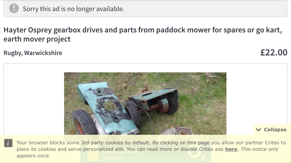

Keith 2 #5 Posted June 21, 2016 Hi Thanks for the reply, luckily I have managed to source some spares off gumtree including one of these plates, its a bit of a schlep to go and get them (5 hour round trip) but what price rare bits eh? Many thanks Keith 1 Potash123 reacted to this Share this post Link to post Share on other sites

Keith 2 #10 Posted June 24, 2016 Thank you, that's fantastic. I actually went to the club earlier, the cutting discs I sourced were slightly smaller but using one of the pulleys that came with it managed to get it fitted and running tonight and cutting fine, just not as wide. At least it will buy us some time to get the original repaired or copied. 5 hour round trip to pick these bits up but the 2 spare gearboxes may come in handy as well as the other spare disc. Thanks for all the help Share this post Link to post Share on other sites
Keith 2 #11 Posted June 24, 2016 The original is riveted but also has 3 bolts which are covered by a cone shaped guard, luckily I didn't have to attempt taking the disc off the flange, just swapped them out Share this post Link to post Share on other sites
