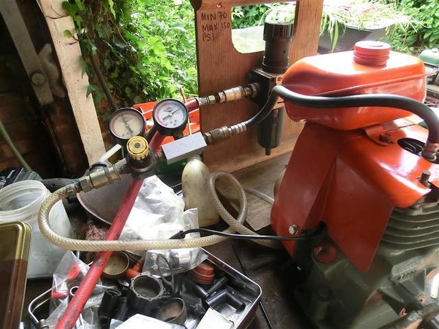

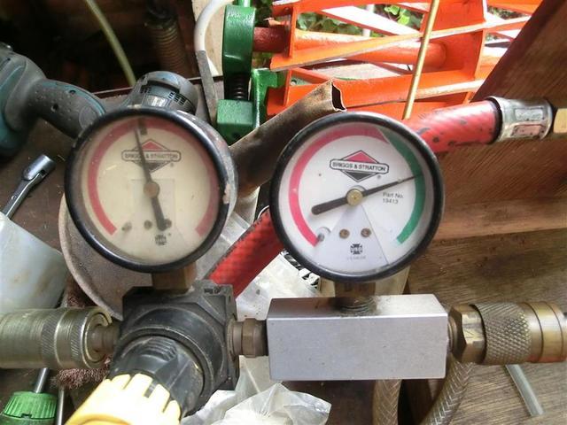

Wristpin 400 #7 Posted June 30, 2016 What's the history? Is it new to you and do you know what's been done to it? Has it ever run in your possession? If similar to the image it could be points ignition but more likely electronic - Magnetron. May be a Magnetron sticker in the centre of the debris screen above the flywheel. What's the compression like? Because of the action of the decompressor its difficult to check the compression by pulling the rope. Fold the handles, stand it on its tail, remove and ground the plug lead and then with a gloved hand bounce the blade against compression in the opposite way to normal rotation, ie clockwise when looking at the blade. Doing that fools the decompressor and gives a more accurate view of the state of play. You should get a pronounced bounce. If it's just soggy it's possibly time for a valve job. If you know anyone with a leak down tester it will give you a better view of the state of the piston and rings, the bore, head gasket and valves. Images show a recently overhauled engine undergoing a leak down test and holding pressure - no piston blow by, gasket or valve leaks . Share this post Link to post Share on other sites
