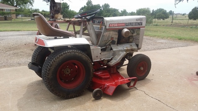

Bolens 1256, earning her keep
I got the newly restored 42" mower deck under the Bolens 1256. Not to others, install the stub shaft on the deck before you put it under the tractor, you will save time and skin. I rebent the rear lift rod so it could hook to the front attachment pin for the front blade and snowblower lift. By doing so the rear lift goes up when the mower deck goes down, I don't know if it works that way on the other pin to the mower deck, man she mows smooth
