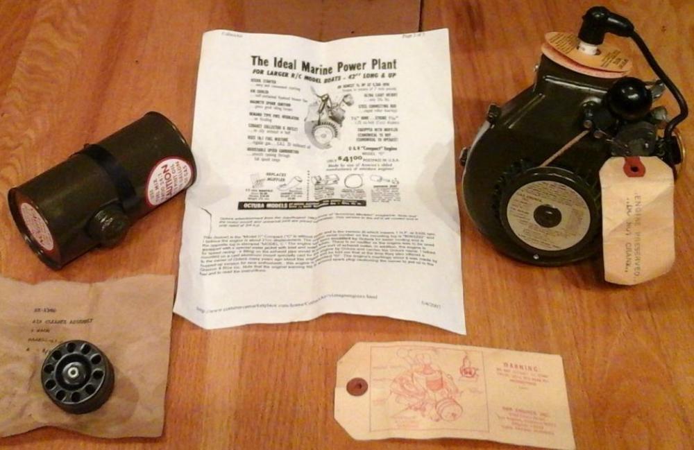

factory 487 #10 Posted January 26, 2017 Is the Military green O&R this one ? If it is it's almost certainly a type 133 engine (that I mentioned in post 6) presumably sold as military surplus at some point, looks like a previous owner thought about using it for a model boat. The page with it is not a marine manual, it's a printout of the Octura ad that is on another website (I can't remember where it's from but I have it saved too). You should send Wallfish pictures of the crankshafts needed for your Tiny Tiger, as there are different types depending on the age of the engine. If you edit any pictures to reduce the file size you will be able to post a few pictures on this forum. David 1 pmackellow reacted to this Share this post Link to post Share on other sites
factory 487 #11 Posted January 26, 2017 Found the webpage with the Octura adverts; http://collectair.org/vintageengines.html The Octura/O&R engine and adverts are about half way down the page. David Share this post Link to post Share on other sites
Oldjimturbine 2 #12 Posted January 27, 2017 Hello factory, and that's the engine I purchased, and just received it today. I was surprised at how small the gas tank was, I always thought they were larger, it looks like a toy, but all the parts look new. There is a notice on the engine that it's preserved, do not crank. Does that mean it just needs oil, or did they add some chemical preservative? Share this post Link to post Share on other sites

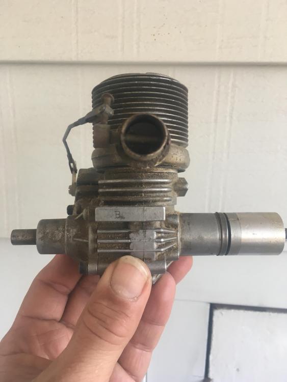

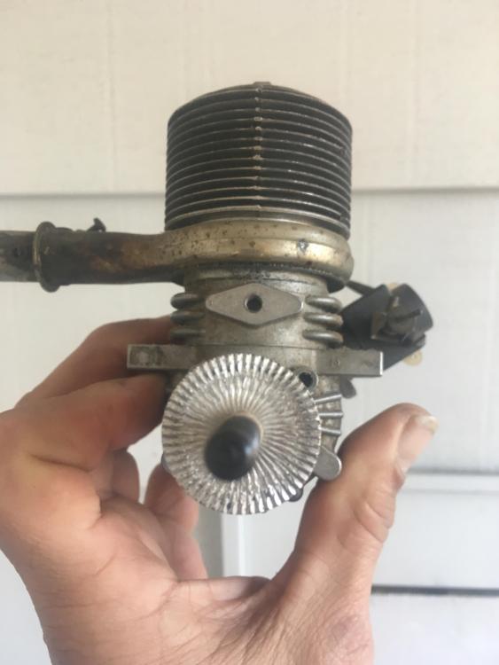

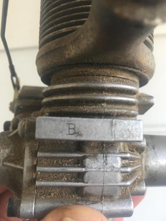

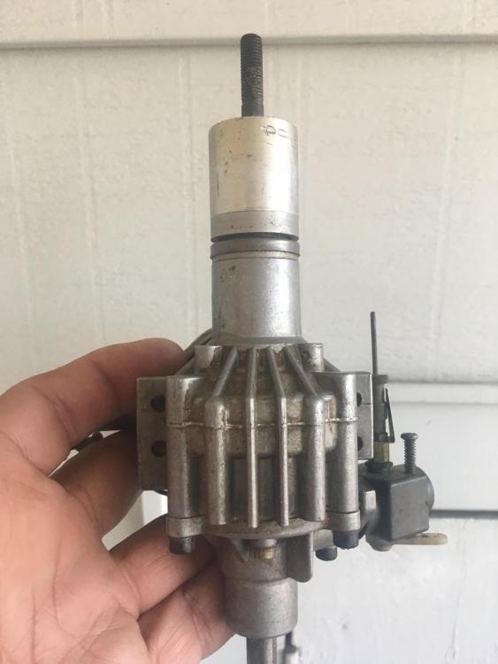

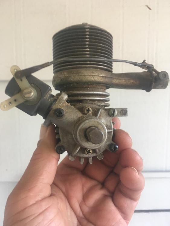

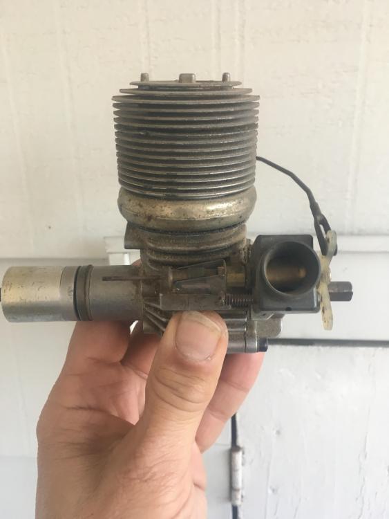

Oldjimturbine 2 #24 Posted March 2, 2017 I just purchased this engine, missing recoil, flywheel, tank, and other parts, has another carb for rc control, a fuel port( I think ), and different shafts front and rear, I'm guessing for an airplane, but I would like an opinion on what it needs to attempt to start it. It turns but I dont have any lubricating oil yet so I don't want to turn it till its lubricated first. I will start with these photos, and will be adding photos of the military and red 1hp engines I have. Share this post Link to post Share on other sites
Wallfish 718 #25 Posted March 3, 2017 Appears to me it was set up for use on an RC airplane using glow fuel. What's in the spark plug hole? Share this post Link to post Share on other sites
