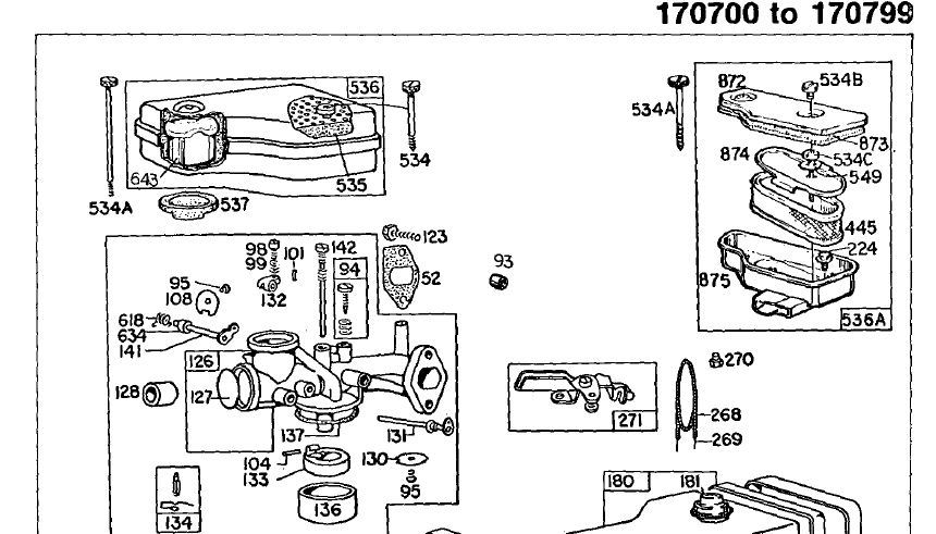

Anglo Traction 1,022 #10 Posted March 5, 2017 2 hours ago, Stormin said: The air filter is foam and can be cleaned. It sounds as if it is in need of it. Wash it in hot soapy water, allow to dry. Apply some engine oil to it then squeeze out the surplus. Problem is Norm, we don't know?. There are 2 types of Filter- The one on the left in the Prts Manual image (foam type element part nbr 270528) is the alternative version. The one on the Right is what I am familiar with (Cartridge type prt nbr 393406) and seen on several example Machines and is not cheap. Until we know how old Mike's machine is (going by an Engine Model, Spec and Serial number, we all have to guess. Share this post Link to post Share on other sites
Stormin 4,458 #11 Posted March 5, 2017 It was his soaked in oil comment that made me think foam, Richard. Anyway, it'll be one or 'tother. Share this post Link to post Share on other sites
Anglo Traction 1,022 #12 Posted March 6, 2017 31 minutes ago, Stormin said: It was his soaked in oil comment that made me think foam, Richard. Anyway, it'll be one or 'tother. Yep !, understand that, and I wondered if it was like my experience of finding the Cartridge filter soaked in oil from someone tipping the machine onto it's side and flooding it from the sump/crankcase. Mike- While you are waiting for the new Air Filter (whichever one it is) , have you now got the Manuals?. Remove both High Speed and Idle Needles and inspect the fine tapers on each (use a magnifying glass). There should be no wear ridges on the taper faces. If there is, then they are allowing too much fuel through when they are set at the correct settings. I would presume you would have to compensate for this and reduce the specified setting for each needle?, as I always replace worn parts to make it easier to set things up. Read page 6 of the User Manual and install/set the needles and if they ARE worn or damaged, you will have to compensate by reducing the number of turns by a fraction (so they aren't open as much). Once you have done this, and the new Air Filter is fitted, it should start and run better. I assume the Fuel tank, line and filter are clean and the Carb Float valve is good?. Also check the choke (butterfly plate) returns to open position when it warms up. Share this post Link to post Share on other sites

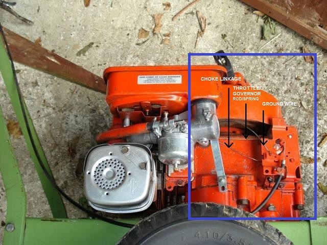

Anglo Traction 1,022 #14 Posted March 6, 2017 4 hours ago, greenplane said: It is a foam Filter So I will try this, the Needles I have taken out inspected and cleaned gently as there was some slight green on brass corrosion, the manual I do have but It is very sketchy But I only have the manual for the engine as in the Briggs and Stratton engine , not the complete machine I have a parts and exploded view but that's it . Sorry Mike, forgive me for being thick, but I'm not clear on what you have. I presume you have the Engine User Manual that shows you minor service jobs like carb settings and filter cleaning etc. An Engine Parts Manual which has exploded view images and Part Number Lists. I don't understand the last bit, you don't have a Manual for the complete machine, but you have a parts and exploded view for it?. Here is a link to a Hayter Manual for the machine courtesy of Wrispin in my old Thread, but I don't know if it covers all Ospreys/21s, as they were updated over the years- OSPREY/21 It would help if you can give us the full set of engine numbers so we can determine the age of it. There are several versions of Thottle/Governor, Choke and Ground Wire layouts. 4 hours ago, greenplane said: I notice that the choke butterfly stays horizontal at all times it doesn't seem to go vertical (closed) at any time . I know about engines etc but only RC car nitro's and 2 strokes the carbs on those are easy to fix in comparison to this one , I know its similar just larger, but it doesn't seem to be as simple, or as easy to remedy So your Choke is not working either!. To understand why, I/we really need a picture now, as you may be missing parts. Here is a 'Doctored' image of an Osprey (1972) that shows what should be there and where for you to compare. But note that not all Ospreys/Engines are the same- Need a picture of yours of the area within the Blue box. the important bit is the panel where the cable connects to. Behind that panel are all the springs, linkages, Governor Arm etc. If you think these are complicated, you want to see the complexity of the Service/Repair Manual images!. Yep!, I also played with RC Cars/Aircraft about 30 years ago. Once you get this issue sorted and maintained, the machine will work for you long time. Share this post Link to post Share on other sites
