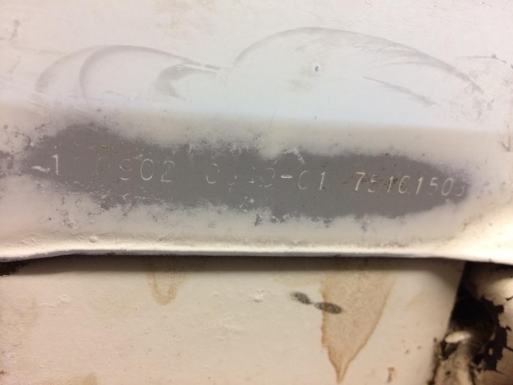

joegrgraham 30 #1 Posted March 3, 2017 Hi all, My mate has just acquired an M1. Unfortunately, someone has rather aggressively sanded the cowling, thus obliterating the serial number. Is there anywhere else he may find the engine number? Thanks Joe Share this post Link to post Share on other sites
Wristpin 400 #2 Posted March 4, 2017 Presume that you are referring to Briggs and Stratton engine numbers although some early Mountfields used both Aspera or Kirby Lauson engines ? To completely obliterate B and S numbers it must have been some pretty heavy handed sanding! Some images may help to work back from "what M1s were fitted with data". Just to complicate matters I believe that Mountfield used the M1 model designation for two different machines over the years. Share this post Link to post Share on other sites
joegrgraham 30 #3 Posted March 4, 2017 It doesn't seem as bad as initially thought. We've managed to salvage some of the number. See pics. Share this post Link to post Share on other sites
Reiver 14 #4 Posted March 4, 2017 It looks like you have a briggs built in 1975 possibly 5hp the first two numbers are not that easy to see.They give the cubic capacity. From my own machines if the first two numbers are 13 that's 5hp, 14 is 6hp Share this post Link to post Share on other sites
Anglo Traction 1,023 #5 Posted March 4, 2017 The picture helps a great deal. My eyes ain't so good, but I reckon that number reads 100902-0349-01. which is a 10 cubic inch model, about 4hp with a vertical Pulsa-Jet Carb fitted. As Reiver says, it's a 1975 build date (15th Oct). So as luck will have it, this Parts Manual available to download covers 100 models, so you can I.D any parts for your engine. Click or tap on the Link- LINK Briggs100 For the Operators Manual, this one covers several engine sizes, but the same procedures-LINK Briggs Man Regards Share this post Link to post Share on other sites
