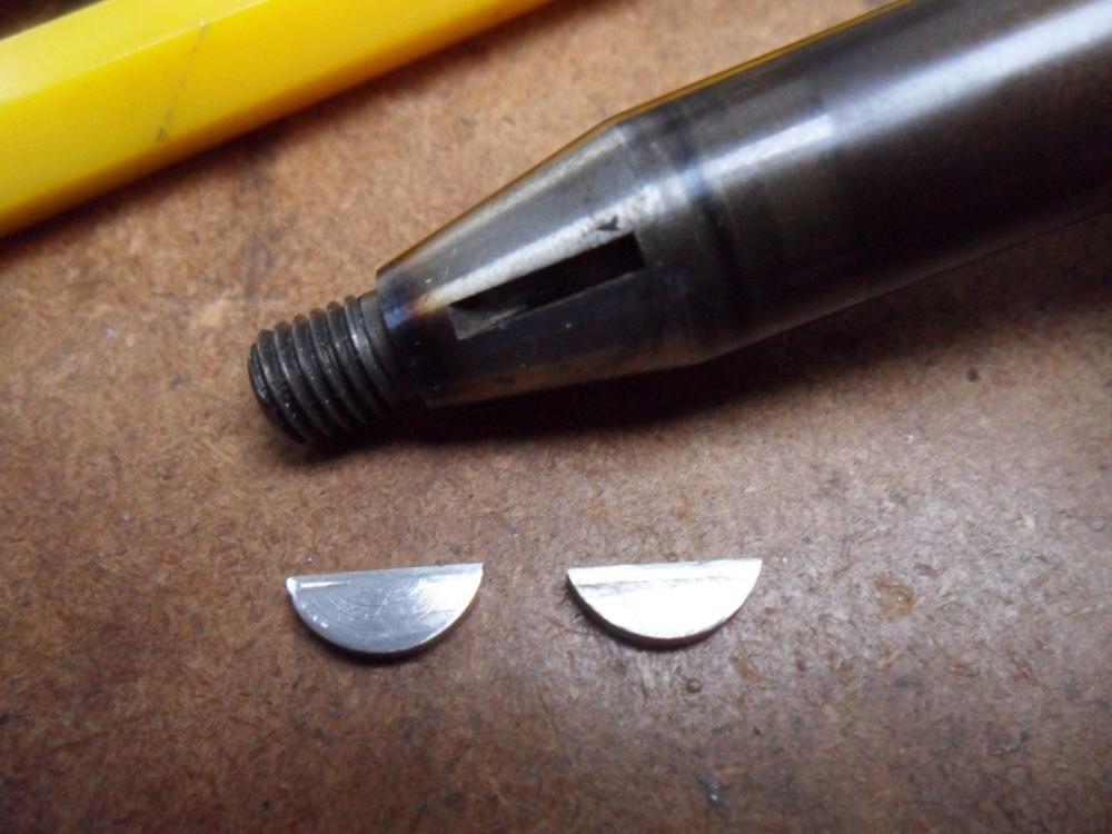

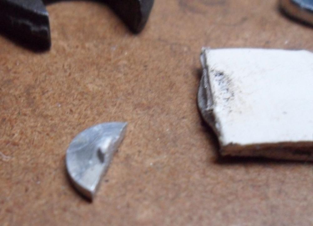

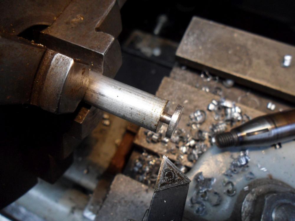

factory 487 #5 Posted April 17, 2017 Just remembered I took a couple of pictures last time I made some new flywheel keys. It was made from an aluminium rod that was the closest in diameter to the original key. A disc was turned to the same thickness as the slot in the crankshaft, the disc was then parted off & cut into two halves. A small piece of U section plastic (cut from a document binder strip) was used to hold the half disc for filing the height to fit the flywheel & crankshaft. Webhead's method for making the key from aluminium sheet stock sounds perfect if you don't have a lathe. David Share this post Link to post Share on other sites

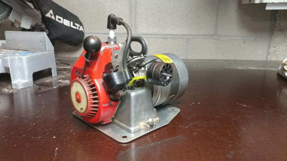

RadRacer203 1 #6 Posted April 22, 2017 Just got my parts machine in the mail and combined the best parts of both to make one good one, but I broke the spark plug. Does anyone know what kind it takes? All I can see is that it's a Champion and the number starts with UY. Other than that, it's got great spark, a new flywheel key, a handle and a gas tank that doesn't leak! Share this post Link to post Share on other sites

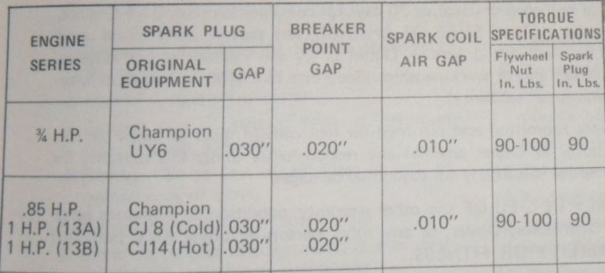

factory 487 #7 Posted April 23, 2017 11 hours ago, RadRacer203 said: I broke the spark plug. Does anyone know what kind it takes? All I can see is that it's a Champion and the number starts with UY. That will be a Champion UY6 10mm spark plug, later engines with the 14mm spark plug used either a Champion CJ8 or Champion CJ14. You may find that the current production Champion spark plugs do not have a re-moveable terminal nut, the modern CJ8 spark plugs I bought are definitely not re-moveable, not sure about the others though as the new CJ14 I bought turned out to be new old stock made in Canada and I have never bought any new UY6 as they are expensive over here, I did buy a box of new old stock from the US though. The non re-moveable terminal nut is only a problem with earlier engines that don't use a HT lead with a spark plug cap. David Share this post Link to post Share on other sites

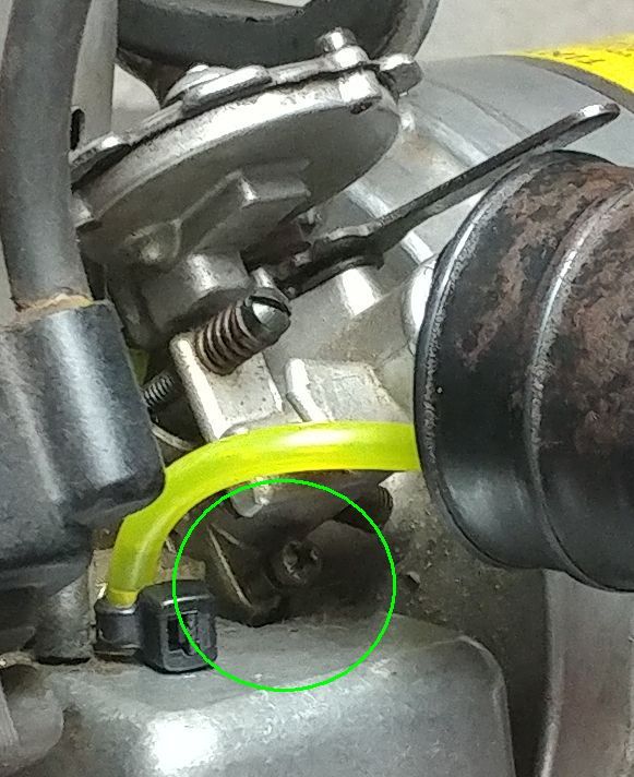

RadRacer203 1 #8 Posted April 28, 2017 Just got my Tiger back together today, and I know it'll run, I got a few pop out of it, but it's not pumping fuel to the carb. Would this mean I need a new diaphragm? The tank looks clean so I don't think it has a clog in the pickup Share this post Link to post Share on other sites
factory 487 #9 Posted April 29, 2017 Very very rarely you come across an original diaphragm that isn't dried out or cracked, has yours been changed already or by the previous owner? As you have had it running before. Some carbs have a second small fuel filter in the bottom half of the carb, I had a similar problem with a Tiger that wouldn't run after being restored the previous year, it had the filter which was clogged preventing fuel getting to the carb. There was an O&R service bulletin recommending that the carb fuel filter should be removed as it caused too many problems, later carbs don't have the second fuel filter. I just cleaned the filter on mine, as the tank filter is missing and the in-line filter I bought still lets some dirt through. I should really replace the missing tank filter, I haven't yet tried removing the steel panel from this type of tank, but others on here have successfully removed them by heating around the panel to loosen the glue/sealant holding them together, you could probably fix your original larger tank if it was leaking from the seal around the panel. Also I had a closer look at the picture, are the two gaskets missing from between the carb assembly and the induction housing? That is the only other thing I can think of, as the screw holding the carb looks too long and I can't see the gaskets, you will get air drawn in if the gaskets are missing. David Share this post Link to post Share on other sites
RadRacer203 1 #10 Posted April 29, 2017 I just double checked everything and cleaned the filter. The filter was clogged up and I apparently forgot to tighten down that screw, but still nothing. Maybe the diaphragm went bad while I wasn't running it? And where can I find a new one? Share this post Link to post Share on other sites
