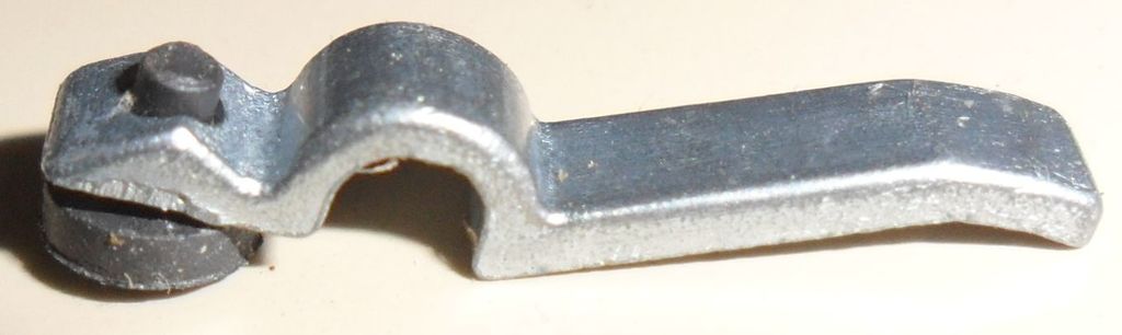

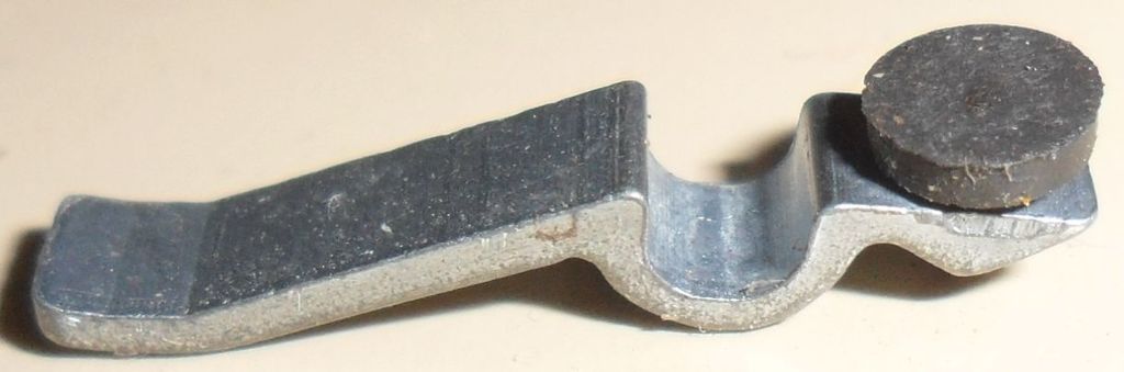

Oldjimturbine 2 #6 Posted May 15, 2017 Thank you again for the info. I liked the older one, but it was sold for 650. Im not going to use it, so I guess it doesn't matter if it has a rubber seal or not. How come this seal can't be replicated if its only rubber? Share this post Link to post Share on other sites
factory 487 #7 Posted June 6, 2017 The rubber seal is a not just a flat piece, it's attached through the diaphragm arm and seems to have a little movement to allow it to seal properly. Not sure how you could make one or work out the correct material to use. Here are a couple of pictures of a diaphragm arm with the rubber seal. David Share this post Link to post Share on other sites
factory 487 #9 Posted June 7, 2017 That is the only spare I have (which came with my Aquabug outboards), I'm not sure if it is new though as the packet was already open. David Share this post Link to post Share on other sites

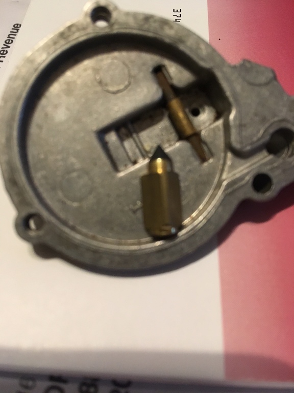

Wallfish 718 #10 Posted June 10, 2017 On 6/6/2017 at 8:51 AM, factory said: The rubber seal is a not just a flat piece, it's attached through the diaphragm arm and seems to have a little movement to allow it to seal properly. Not sure how you could make one or work out the correct material to use. Here are a couple of pictures of a diaphragm arm with the rubber seal. Kohler engine carbs use a rubber tipped float needle seal which looks like it could work as a replacement. Unfortunately I just haven't had the time to try and get one to work. Share this post Link to post Share on other sites
factory 487 #11 Posted June 12, 2017 That certainly looks like a good candidate for replacing the seal. David Share this post Link to post Share on other sites
