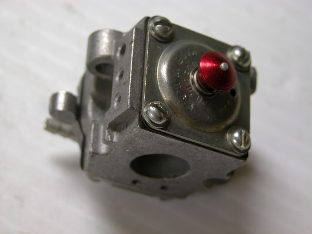

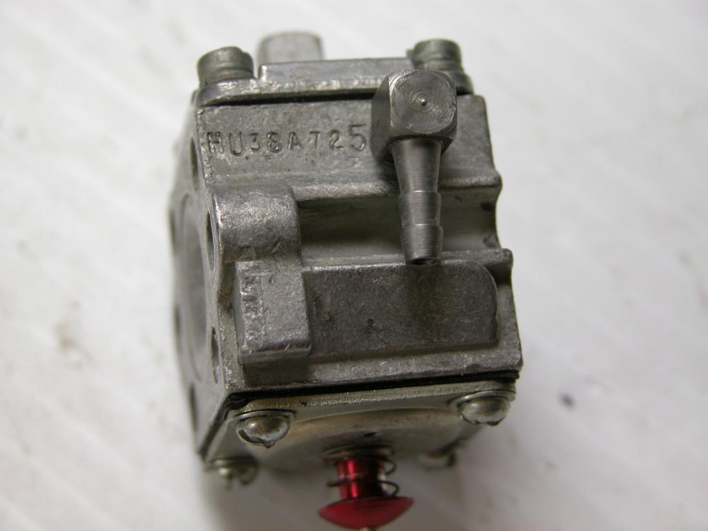

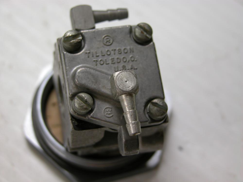

Webhead 95 #1 Posted May 9, 2017 I received a bunch of these Tillotson carbs in an O&R parts lot many years ago and I am trying to figure out what they went to. They have the same primer button as an O&R carb and I figured that an extremely resourceful guy like David could help. Thanks in advance. Share this post Link to post Share on other sites
factory 487 #2 Posted May 9, 2017 Didn't take too long to figure out. It's mentioned in the book "Small Air-Cooled Engines" 16th edition from Intertec Publishing, I have had two different editions of this book shipped over here, the 16th edition covers the Compact I, II, II, 13A, 13B & 20A models of O&R/Advanced Engine Products engines. Your mystery carb is a Tillotson model HU and it was apparently fitted to late production model 13B engines for constant speed operation, it is pre-calibrated for constant speed operation only and has no fuel/speed adjustments or throttle, the primer button is is used for starting enrichment to allow extra fuel flow. Also no air vane governor is fitted. There is also an exploded diagram of the carb. I now just need to have a look for a strange 13B in my saved pictures. David Share this post Link to post Share on other sites

Webhead 95 #5 Posted May 11, 2017 Not sure why the screws in this one are all marred up, but I will send you some with good screws, no charge other than shipping. Share this post Link to post Share on other sites
Webhead 95 #6 Posted May 11, 2017 And yes, the only HU's that I could find on the web had screw adjustments for low and hi. These carbs are naked, except for the cool primer button. Share this post Link to post Share on other sites
factory 487 #7 Posted May 11, 2017 16 hours ago, Webhead said: Not sure why the screws in this one are all marred up, but I will send you some with good screws, no charge other than shipping. Someone probably didn't use a screwdriver of the correct size, seems to happen far too often judging by the amount of chewed up screw-heads I find. 16 hours ago, Webhead said: And yes, the only HU's that I could find on the web had screw adjustments for low and hi. These carbs are naked, except for the cool primer button. I too could only find the manufacturers manual for the standard type HU carb on the web. Here is a picture of the correct diagram, I'm now slightly puzzled why the one in the first post has an extra inlet, has someone swapped the cover? David Share this post Link to post Share on other sites
Webhead 95 #8 Posted May 11, 2017 David, they all have two inlets and the one pictured is the only one with marred screws. I realized that it was a poor screwdriver job, just wondering why somebody would have taken a new carb apart. Share this post Link to post Share on other sites
