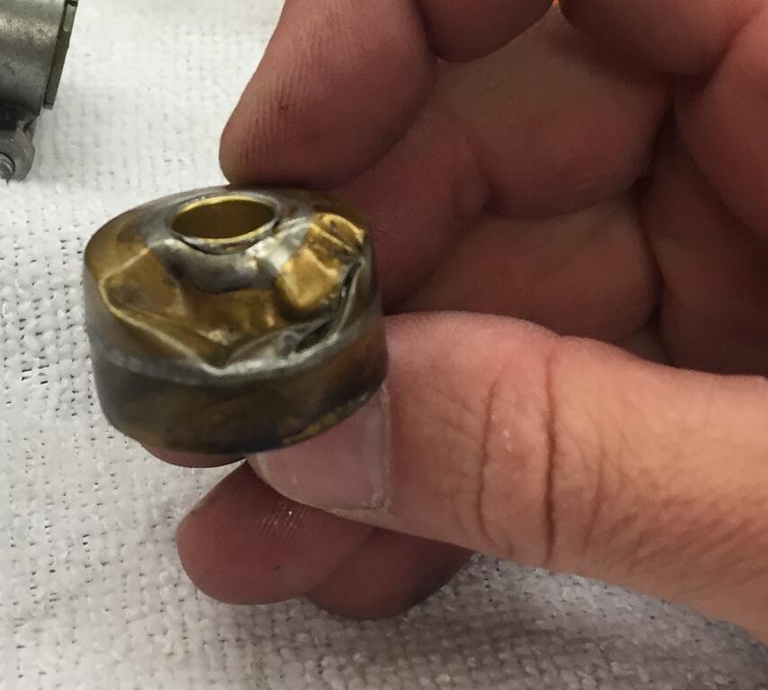

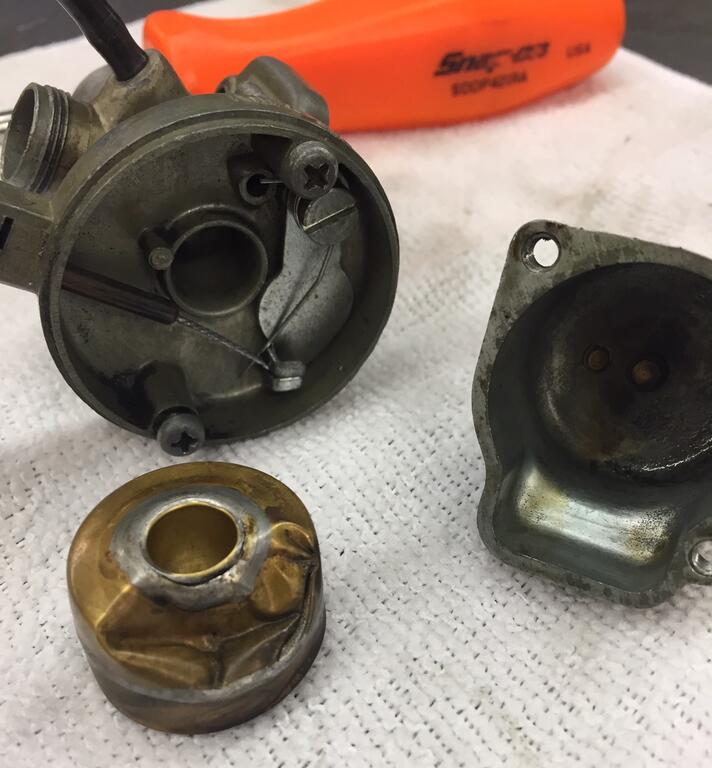

E Killackey 0 #52 Posted April 20, 2021 HELP ! I need a FLOAT for my TAS P-7 Carburetor. We took apart the float bowl and look what we saw inside. I need help - Anybody? you can also contact at hkillackey@aol.com Share this post Link to post Share on other sites
CNew 408 #53 Posted April 20, 2021 Just a thought. The carburetors look similar to those used on some of the old Tanaka, Echo/Kioritz, and Shindaiwa engines. Maybe there is a float that is similar in size. For example, check out e-replacement parts or parts tree online and look up Echo PB-202. It has a similar float design and float bowl, maybe you’ll get lucky... Here’s a vintage Kioritz float - are the measurements close? https://www.ebay.com/itm/Vintage-NOS-Genuine-Echo-Kioritz-Float-P-120-133-0111-0/292981446733?hash=item44370e184d:g:Z-oAAOSwYyVcdEeD On 1/14/2021 at 8:31 PM, H Killackey said: I had a few Tanaka P7 Air Cleaner Covers made. I have listed them in eBay. They came out very good. They can be gentle sanded if you want to make them show quality. https://www.ebay.com/itm/164645598092?ssPageName=STRK:MESELX:IT&_trksid=p3984.m1555.l2649 Do you still have any of these? Share this post Link to post Share on other sites
E Killackey 0 #54 Posted April 21, 2021 THANKS for your help/Idea. I have ordered a Float from the link you suggested. I will let you know what happens. Share this post Link to post Share on other sites

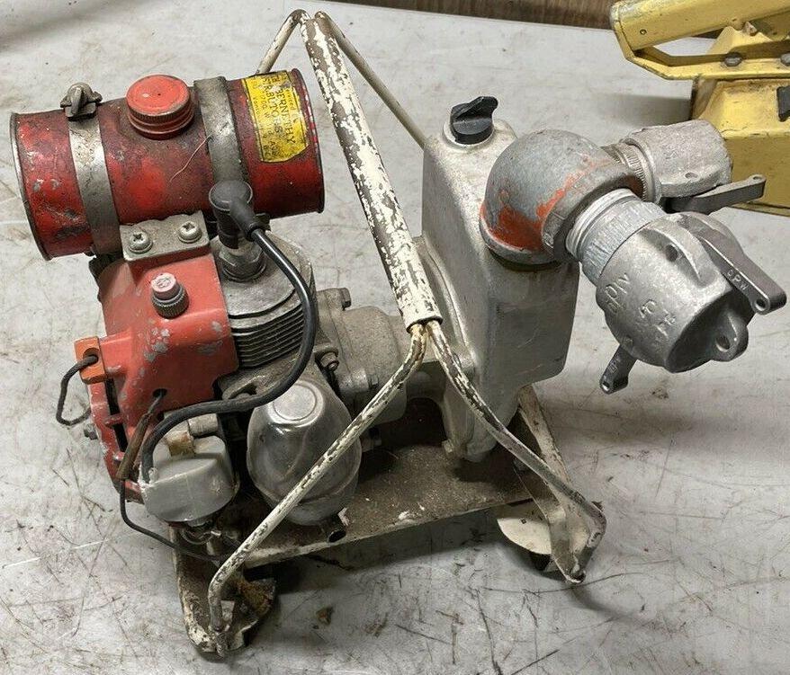

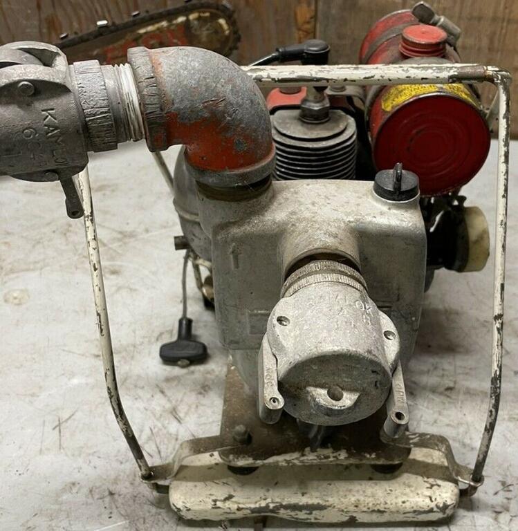

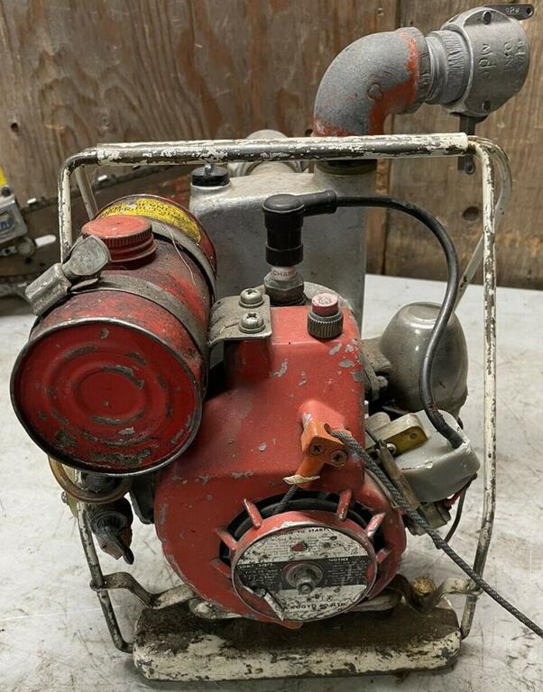

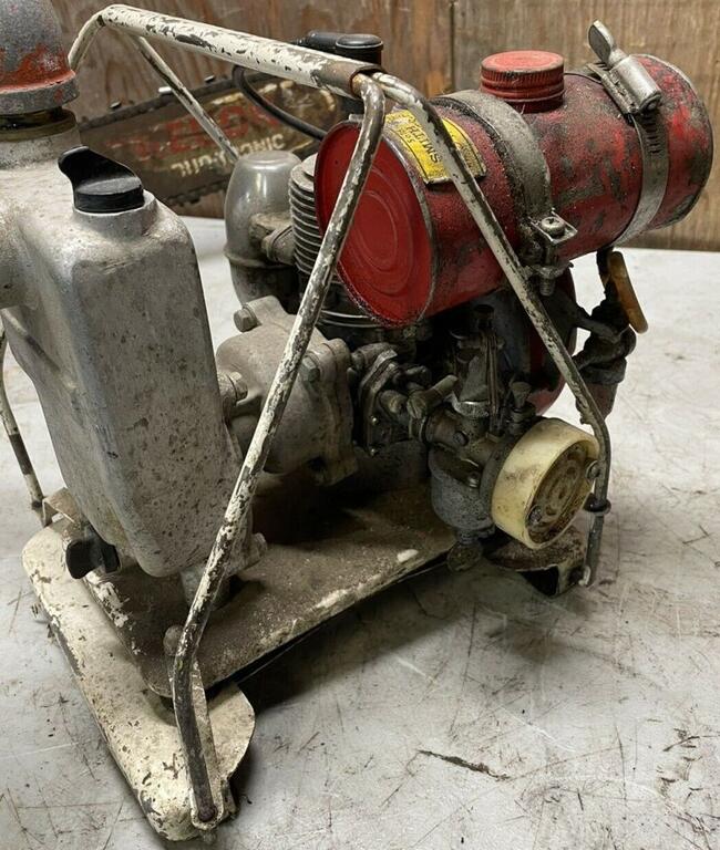

factory 487 #57 Posted May 6, 2021 There is a badly advertised & overpriced TAS pump on ePay in Canada, seller thinks it's an O&R, I did send them a message but they haven't replied or corrected it . https://www.ebay.com/itm/114666852338 Here are some pictures I have saved from the listing. David 1 pmackellow reacted to this Share this post Link to post Share on other sites
CNew 408 #58 Posted May 7, 2021 I’ve been watching that one as well and almost sent a message about the TAS motor but it’s priced so high I decided not to. It’s a cool pump but not at that price. Share this post Link to post Share on other sites
factory 487 #59 Posted May 7, 2021 I only sent a message to advise them it was not as described, they wouldn't want someone to claim for this when it arrives and is found not to be an O&R or Orline. No interest in buying at that price even if it had international shipping, same goes for the actual O&R powered tools he has. David 1 CNew reacted to this Share this post Link to post Share on other sites
H Killackey 6 #60 Posted September 12, 2021 (edited) HELP PLEASE - I need a Little Petro P-7 KEIHIN carburetor - OR a carburetor float. I have tried many other floats that do not fit in the KEIHIN float bowl. I have been looking for over 1 year now and I really need some help with this --- Help. I can also be reached at hkillackey@aol.com Edited September 12, 2021 by H Killackey Share this post Link to post Share on other sites
CNew 408 #61 Posted September 14, 2021 Can you add a photo of the float bowl? Would something like this maybe fit? https://www.ebay.com/itm/292981446733?hash=item44370e184d:g:Z-oAAOSwYyVcdEeD Share this post Link to post Share on other sites
H Killackey 6 #62 Posted September 16, 2021 (edited) My damaged float and the carburetor pics are about 5 posts above. Thanks for the eBay link for a float. I purchased it but the seller couldn't give me accurate dimensions. Maybe I will get lucky -- Edited September 16, 2021 by H Killackey Share this post Link to post Share on other sites
CNew 408 #63 Posted September 16, 2021 https://shopee.com.my/BRUSH-CUTTER-(BG328)-FLOAT-CARBURETOR-MESIN-RUMPUT-BG330-TB33-TL33-i.336498265.5164431335 this looks like a possibility too… try also searching parts for an Echo PB-202. It used a carb that looks very similar and the float is still available from PartsTree and eReplacement parts. Might be worth a try… https://www.partstree.com/models/pb-202-echo-handheld-blower-parts-sn-0001001-0040501/carburetor-3/ Share this post Link to post Share on other sites
