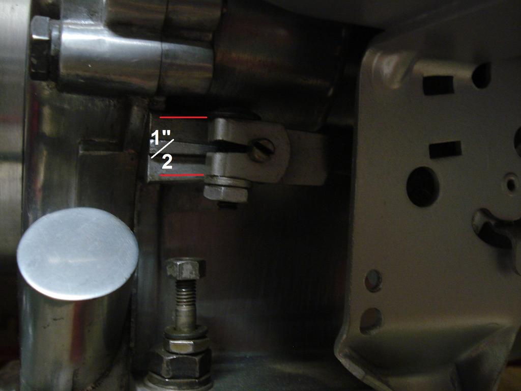

Anglo Traction 1,016 #3 Posted June 3, 2018 Can't remember if those Balls for the Starter ratchet are 5/16" or 1/4". I had 6 in mine and I think the person in this link also had 6?- -LINK- Maybe luck of the draw, or 1 got lost, or 1 too many ? . If you want another one, carefully measure one, let me know the size and I'll see if I have one. As for the Gov'nor Arm Clamp Bolt, I believe your Arm fits on a 1/4" diameter Governor Rod. Mine shown in the pic below is 3/16" (on an earlier 4hp model) and the Arm clamp width is 1/2"- It's a Horizontal Shaft Motor and the bolt is mushroom headed for clearance and a half nut to retain it. The bolt is 10 x 24 UNF . The one sitting on the mounting bolt is that size (aero grade) and long enough (3/4") to fit a 1/2" clamp width. Is this the size you need Ray, or must it be longer ?. Share this post Link to post Share on other sites
Rayp 48 #4 Posted June 4, 2018 Firstly, thankyou Wristpin for directing me to the one in stock which I have ordered. As regards the ball bearings the Manual is silent so Richard may be right in that it's pot luck how many each engine has. I didn't remove the clutch cover, it just fell off and whilst I do not believe I lost a bearing I cannot be absolutely sure. However I will be closely following Richard's advice in the LINK he gave as regards cleaning and reassembly of the clutch. Turning to Richard's post, I realise I should have said that my engine is a vertical shaft. His photo clearly shows how the Horizontal shaft differs from the vertical shaft in this respect. When the screw arrives I will be able to measure it and I may then find that it is something that is available from a hardware stockist, although I am hoping the new screw will not 'disappear' like the old one, because I will be applying Loctite to it when I install it! Despite investing in a good second-hand Rabone Chesterman dial Vernier, I am still not very practiced in its use and when I measured one of the bearings I got it to 312 thousands of an inch which seems somewhat short of 3/8 of an inch so perhaps my bearings are considerably worn (or my measurement is useless!). Share this post Link to post Share on other sites
Anglo Traction 1,016 #5 Posted June 4, 2018 29 minutes ago, Rayp said: When the screw arrives I will be able to measure it and I may then find that it is something that is available from a hardware stockist, although I am hoping the new screw will not 'disappear' like the old one, because I will be applying Loctite to it when I install it! Despite investing in a good second-hand Rabone Chesterman dial Vernier, I am still not very practiced in its use and when I measured one of the bearings I got it to 312 thousands of an inch which seems somewhat short of 3/8 of an inch so perhaps my bearings are considerably worn (or my measurement is useless!). Sorry Ray, I may have misunderstood. I didn't know you had ordered a Screw/Bolt for the Arm/Clamp, thought you were looking for one. Just needed clarity on the Clamp width, as I suspected yours was horizontal shaft engine. As for the measurement, 0.312" is near as damn it 5/16" (0.3125"), so it depends if your dial shows in 0.0005" graduations, but as you've ordered one, I'll cancel the search. Regards. 1 Rayp reacted to this Share this post Link to post Share on other sites
