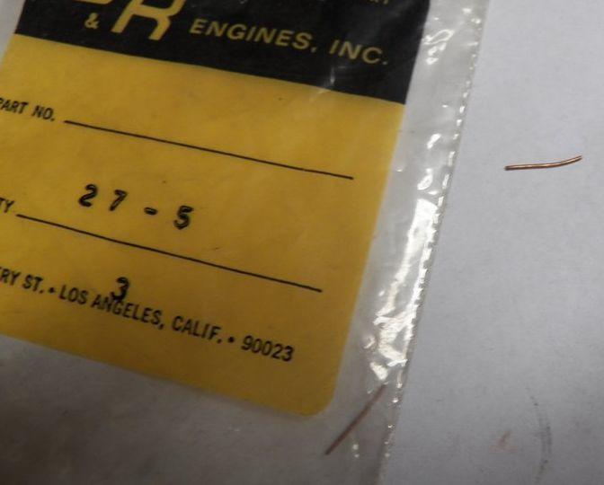

factory 487 #3 Posted March 4, 2019 I would need to check both later in the week, has the carb been vandalised by someone wanting the add a RC servo? That seems to be what happens to few of them, along with losing the governor vane. The lock mechanism & spring wasn't sold separately, the 'governor spring retainer' is what O&R described the copper colour wire as (part no. #27-5, picture from the web), I can check the wire with a magnet but I suspect it's copper. It's a good idea to keep damaged carbs for parts like these, as both John & me have. David Share this post Link to post Share on other sites

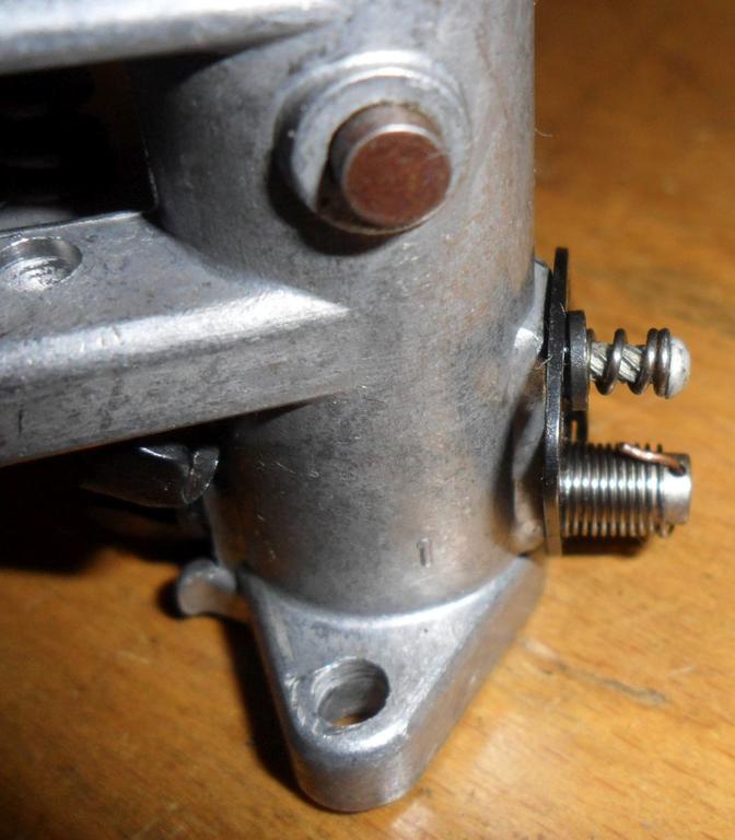

CNew 408 #4 Posted March 4, 2019 Excellent, his is very helpful. I’ll try to get some better measurements as well on the locking spring. It’s good to know that the keeper is likely just a little piece of copper wire. This particular engine is one of the Type 133 military engines so I’m guessing it wasn’t repurposed for RC. It may had just gotten damaged over the years. When I got it the little post for the locker was busted in half so maybe a previously owner just decided to remove the whole Governor vane and mechanism. I do have another engine that was modified for RC and has the little throttle cable adjuster attached (see photo). Share this post Link to post Share on other sites

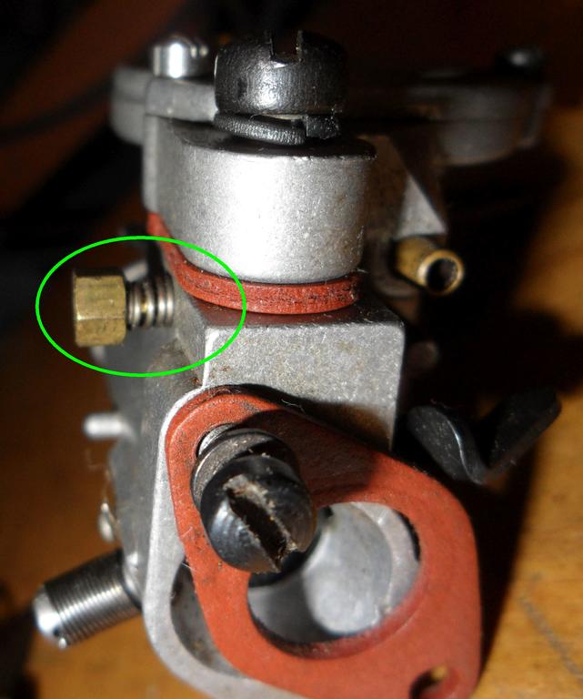

Wallfish 718 #9 Posted March 6, 2019 Why not just take this spring? Not being used on this one On 3/4/2019 at 5:56 PM, CNew said: Share this post Link to post Share on other sites
CNew 408 #10 Posted March 6, 2019 Haaaa, you’re too smart... great suggestion - I think I’ll do just that Share this post Link to post Share on other sites
