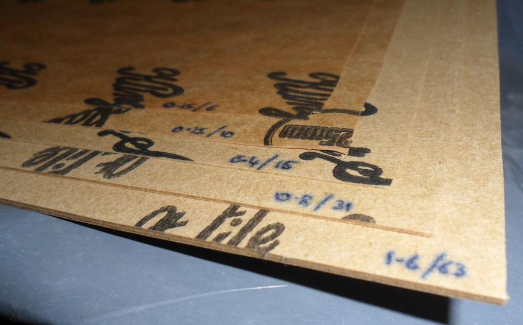

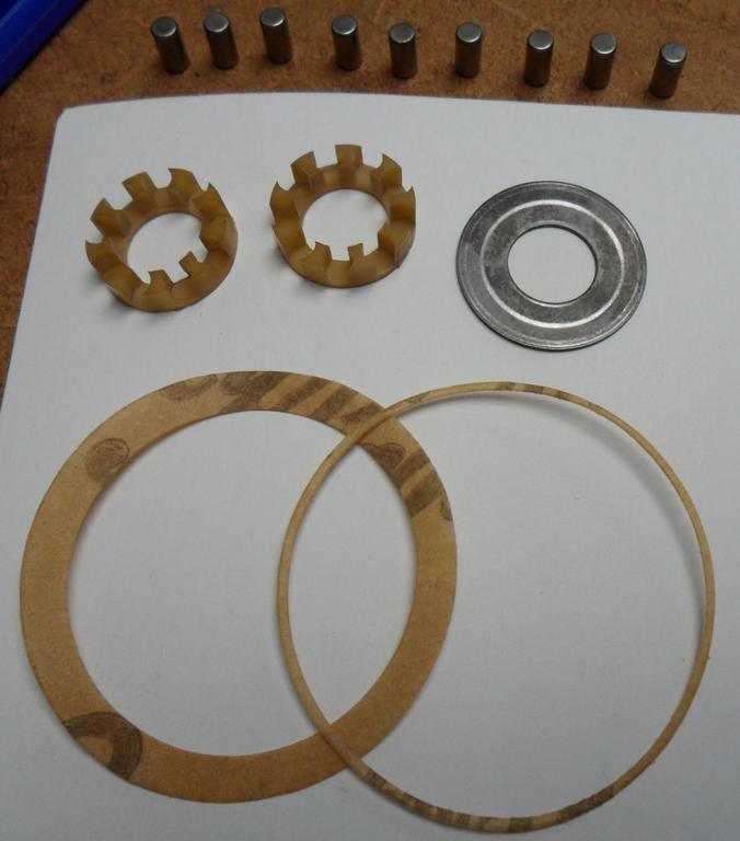

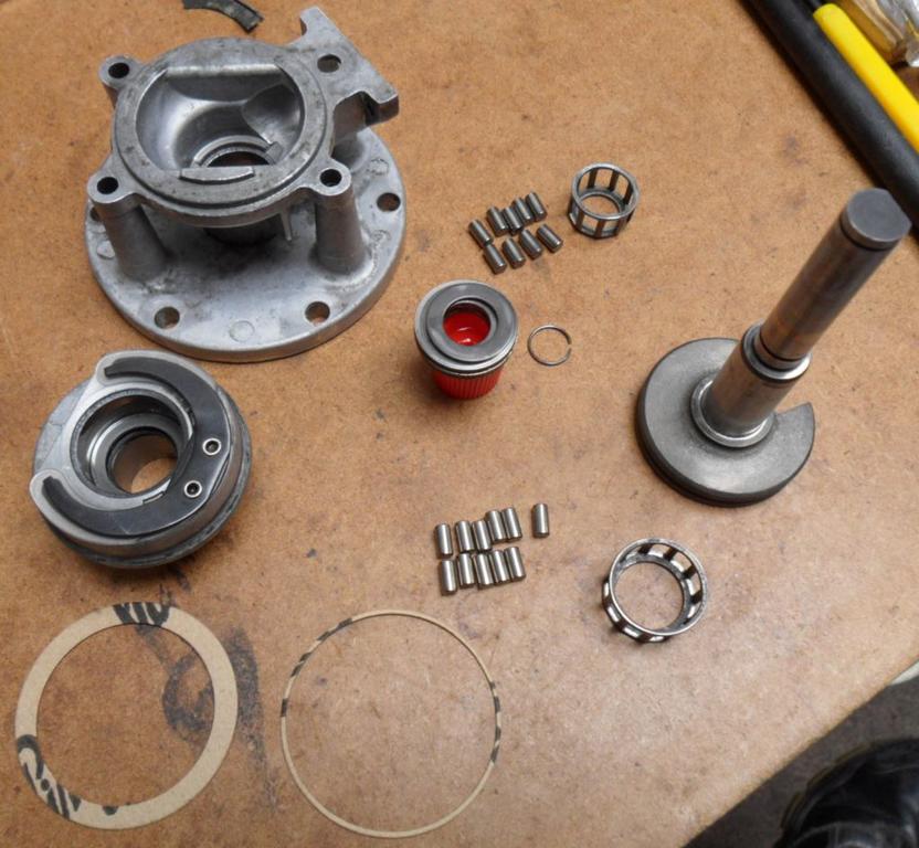

factory 487 #5 Posted April 4, 2019 I assume you are referring to these gaskets; 5-5 Induction case gasket 5-6 Reed (feather) valve gasket Here's some I made earlier, for a hedge trimmer engine (13B) & a Tiny Tiger engine (¾HP). Note: these two engines have different thickness gaskets. You can always buy some to try, put a sample of each type in some fuel mix for a week of two to see if it reacts, swells or disintegrates, if it doesn't it will probably be OK. I bought a small pack of gasket paper sheets for a couple of £'s in the following sizes, 0.006" (0.15mm), 0.01" (0.25mm), 0.016" (0.4mm), 0.031" (0.8mm) and 0.063" (1.6mm), I will have a look in the shed later to find out the type. Note: you will get different measurements for the gasket thickness due to tolerances, which are mentioned the link you provided. Apparently Perry Como album covers make excellent head gaskets, see post #9 here. https://www.smokstak.com/forum/showthread.php?t=89564 David P.S. I'm tempted to combine this with the other recent gasket thread, as they both cover the same topic. Share this post Link to post Share on other sites
factory 487 #6 Posted April 4, 2019 1 hour ago, factory said: I bought a small pack of gasket paper sheets for a couple of £'s in the following sizes, 0.006" (0.15mm), 0.01" (0.25mm), 0.016" (0.4mm), 0.031" (0.8mm) and 0.063" (1.6mm), I will have a look in the shed later to find out the type. The gasket paper I have is KlingerStatite; https://docs-emea.rs-online.com/webdocs/0563/0900766b80563191.pdf Page 175 in the Klinger catalogue; http://www.klinger.co.uk/assets/files/Klinger Catalogue 2014.pdf It is rated to 120°C (248°F) & made from cellulose fibre (some websites say it is vegetable fibre ), anyway it sounds very similar to the stuff you have found. David Share this post Link to post Share on other sites
